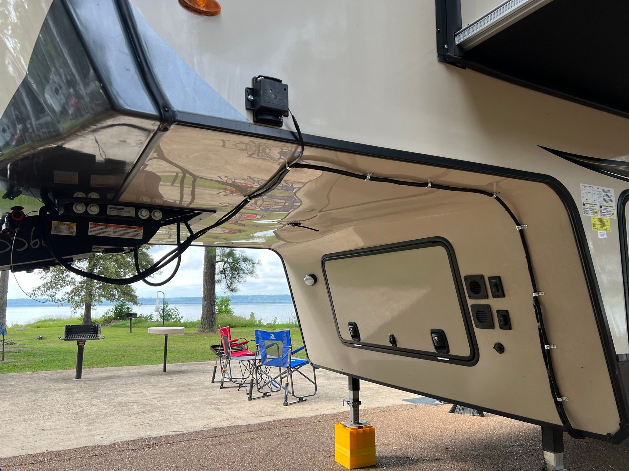

Ditto what @Archion said, I don't think it's possible with using Ford's hardwired system. Pictures follow how I ran the wires and mounted my camera. Some will say it looks hokey, but I don't mind and it works perfectly.
Having the rear camera show on my 12" info screen is awesome when changing lanes on the interstate. And having the trailer tire TPMS warning pop up on the truck's center (steering wheel) screen probably saved me a blowout last summer. It wasn't even pressure, the temperature in one of my trailer tires went super high and the sensors caught that. Probably from the plys in that tire separating, they were five years old. The yaw sensor works with Pro Trailer Backup Assist (PTBA) but to be honest I wouldn't order that feature again. The **** in the truck and my brain don't get along, so I just use the mirrors. I think Ford also sells a two wire version without the yaw sensor, if you don't have PTBA.
Good luck!
I have a three wire cord for yaw sensor, tpms module, and camera. They also sell a two wire version without yaw, if you dont have Pro Trailer Backup Assist.
This shows my three wire cord for yaw sensor, tpms module, and camera. You can see the yaw sensor on the side and I mounted the TPMS (wireless receiving) module on the frame right under the front corner.

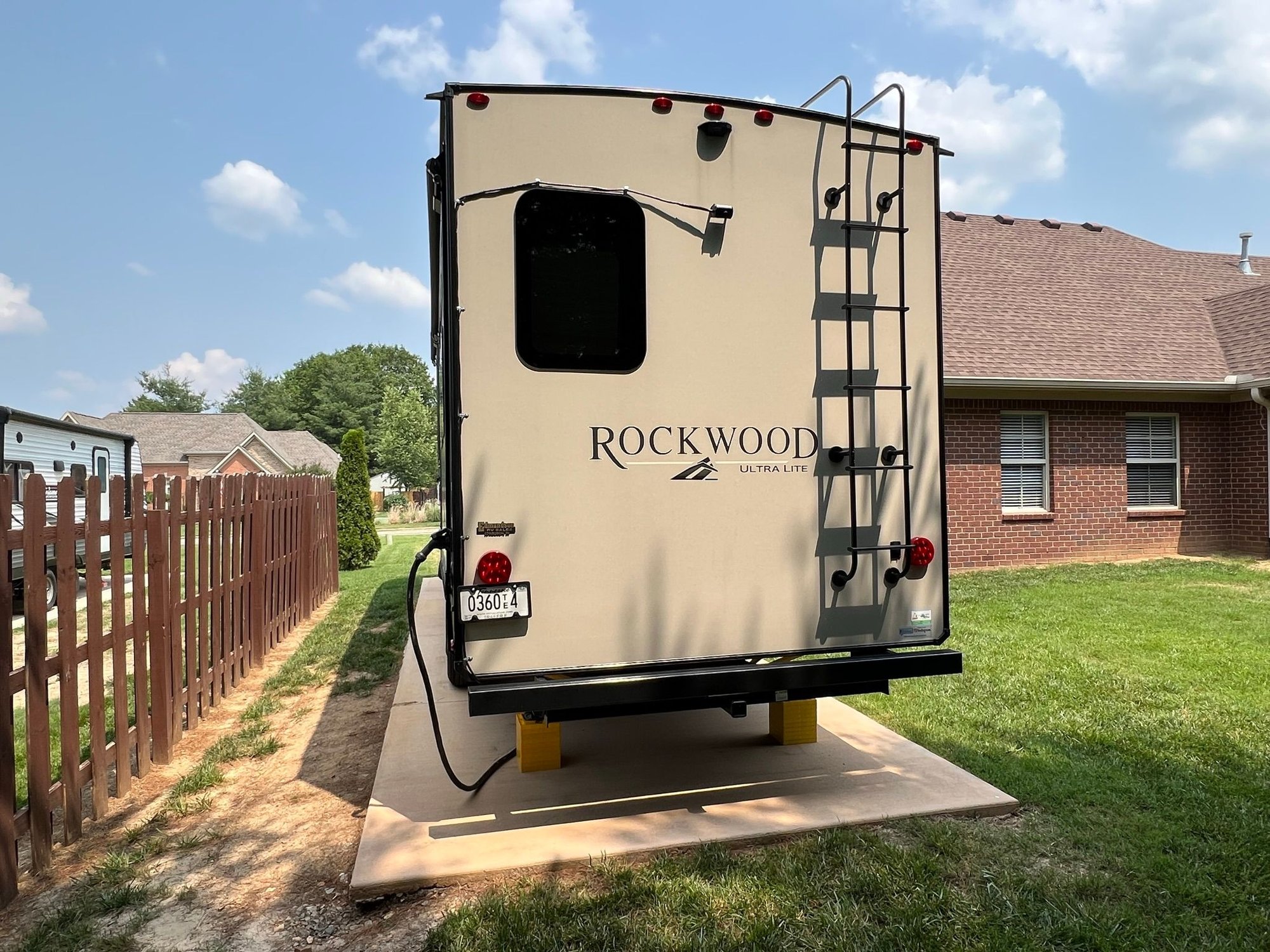

I ran the camera wire along the frame underneath, then up the side and over. Yes it looks funny but it was easy and its really functional.
I ran the camera wire along the I-Beam frame underneath, then up the side and over. Yes it looks funny but it was easy and it's completely functional. Plus the cord is protected by the I-Beam and still looks good after several years. I don't remember how many feet long the camera cable is, but the one that came in my kit was long enough for my 32 foot fiver without needing to splice extra wire.
