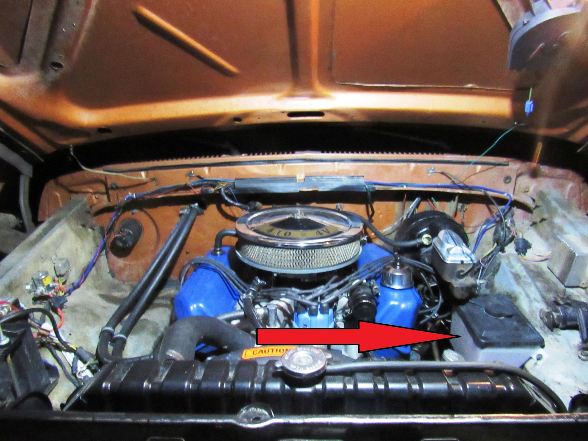

I went to change the oil today and I saw a tube hanging under the hood. I have a random dangling tube I'd never seen, it's coming from a few others bolted to the firewall, behind the instrument panel. The only thing I'm aware of that doesn't work (and I still can't figure out if someone could help!) is the temp sensor on the dash. Any chance it's related? I'll post a pic. I circled it, sorry, I should've before.

The top arrow is pointing to the washer pump and the bottom arrow is pointing the the loose hose that you are questioning.
