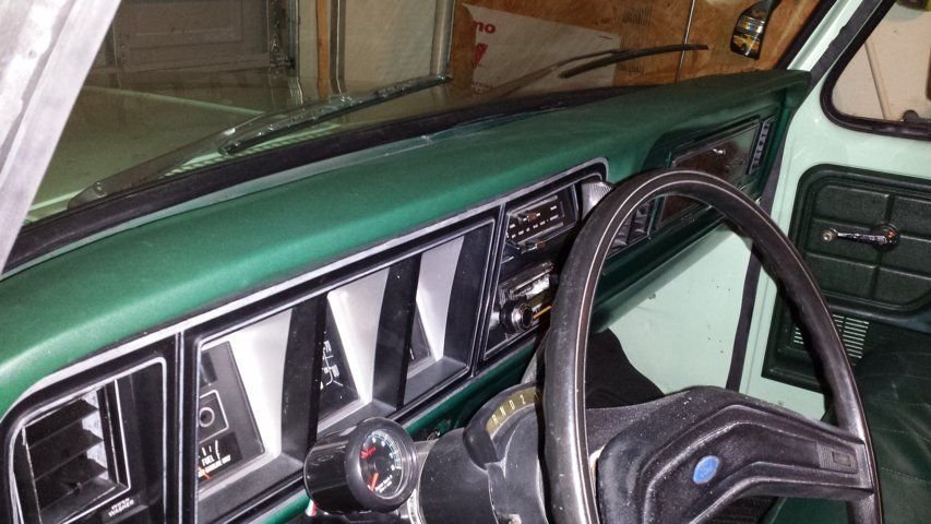

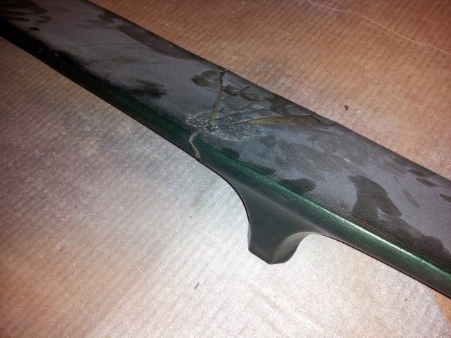

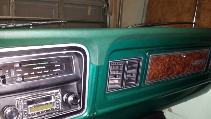

You may want to get a quote at a local upholstery shop. Mine was green and the color isn't reproduced and though I don't recall what the cost was at the time it was marginally less than buying a reporduced one. It's held up well in the 10 years since it's been done.
Old pad
Old pad
New
New
New
New

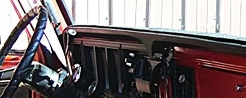

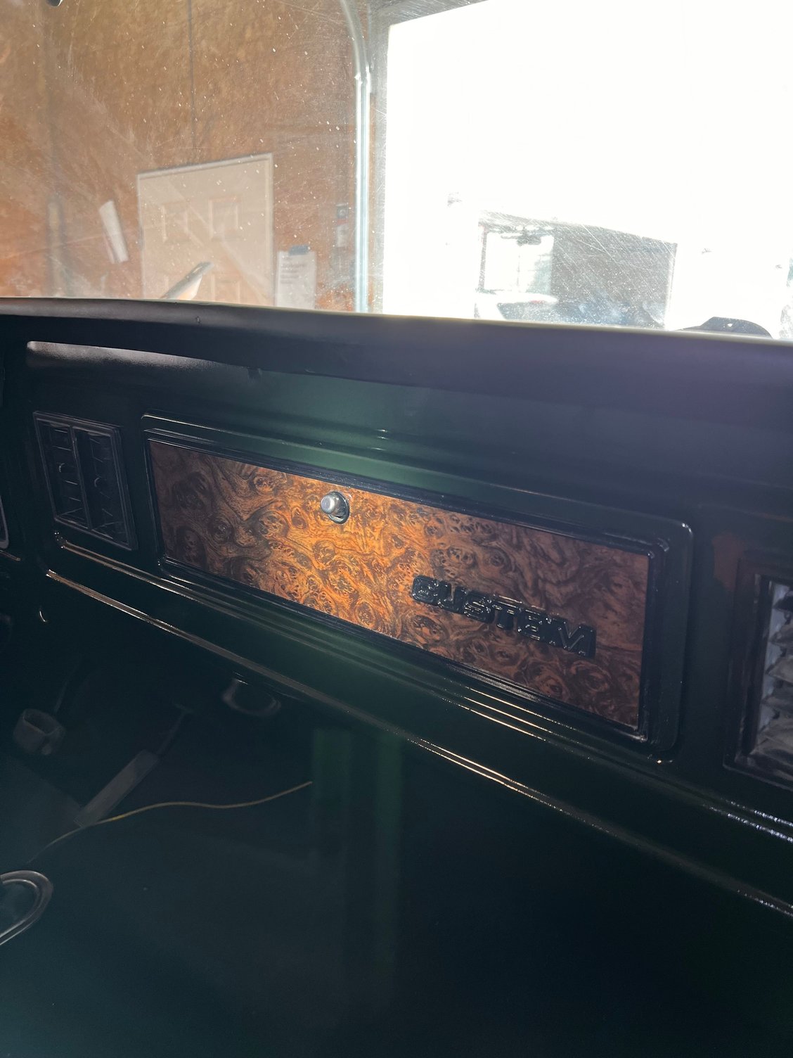

I bought a black molded over dash cover, it came with silicone adhesive to use but it fit so well, it just like "snapped" in place, covered all of the padded portion of my OEM dark red one that had many cracks. It does not cover the metal like where defroster outlets or that speaker is ... and I never did glue it nor will I. Was about $150 as I recall over the counter at AutoKrafters up the road. Then I put a carpet like black overlay that covered from windshield to rear edge so well that I didn't bother with the Velcro. Of course, to use them, you still need a base dash pad, but even if cracked it'll not be seen.
DASH PAD COVER 1973-79 FORD TRUCK F100 F150 F250 F350 PICKUP 1978-79 BRONCO BLACK (DT409-01)
I favor black on my dashes as they do not reflect in the windshield.
The carpet like cover just comes to the edge, it turns down on the ends to tuck between dash & cab metal, didn't have a great picture of it.

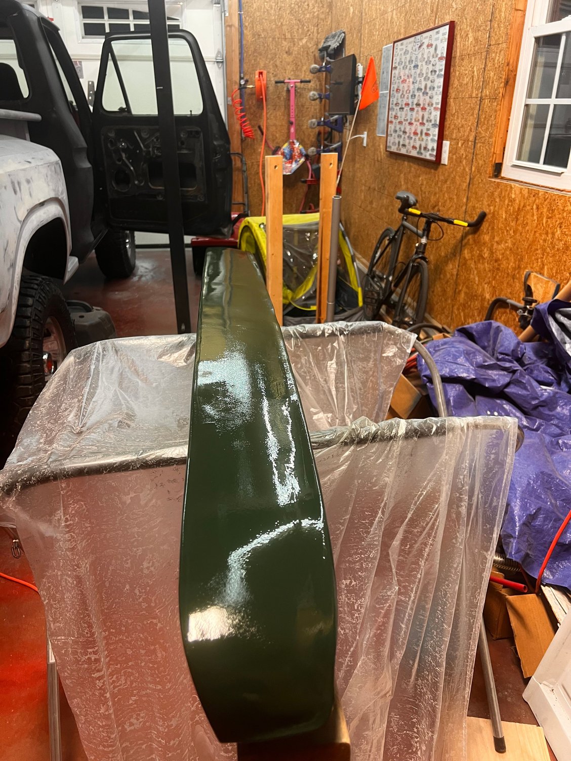

I recently “ repaired” mine with bondo.
