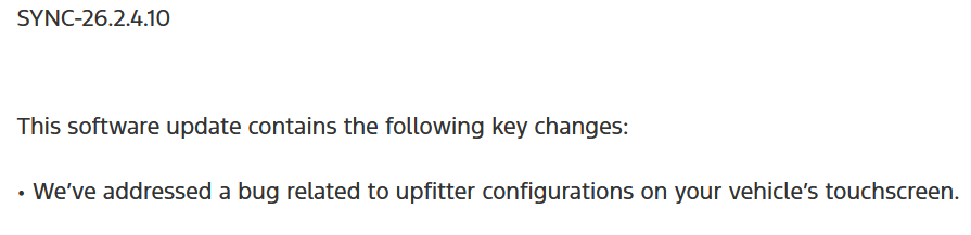

While waiting for the 26C10 update and checking my app for the confirmation, I received an unexpected updated:
I hope the trailer one updates soon, so I can stop waiting for it.
