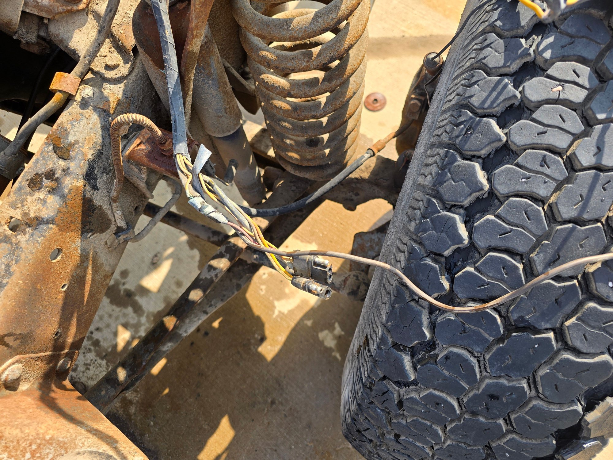

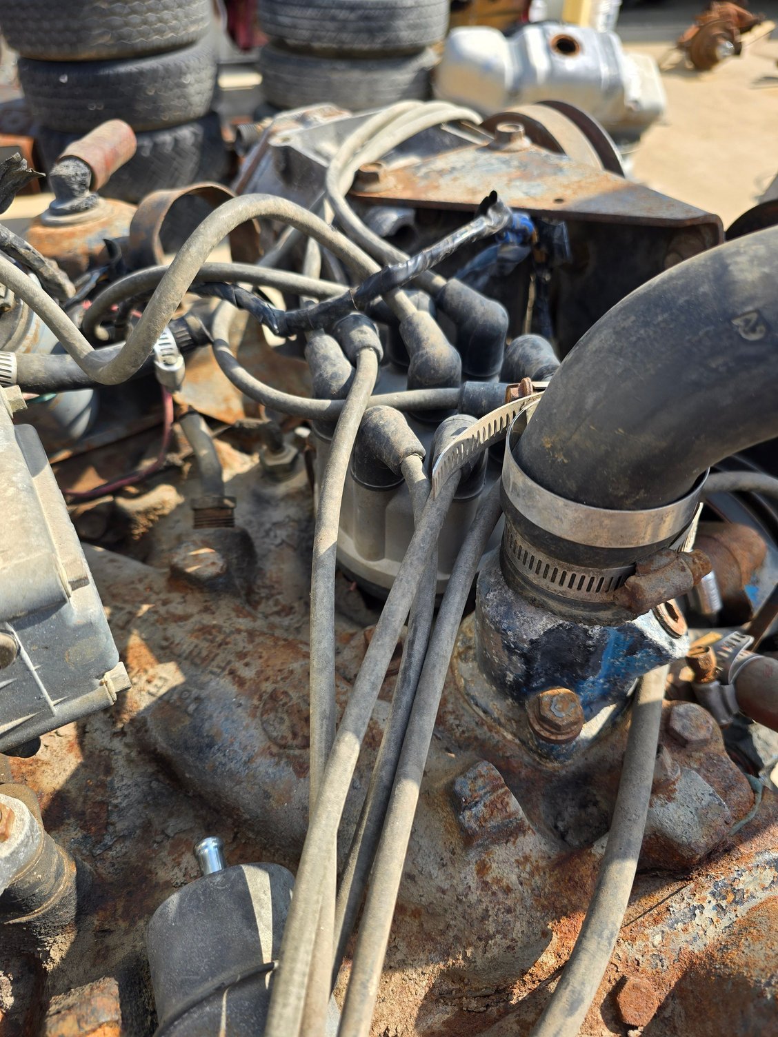

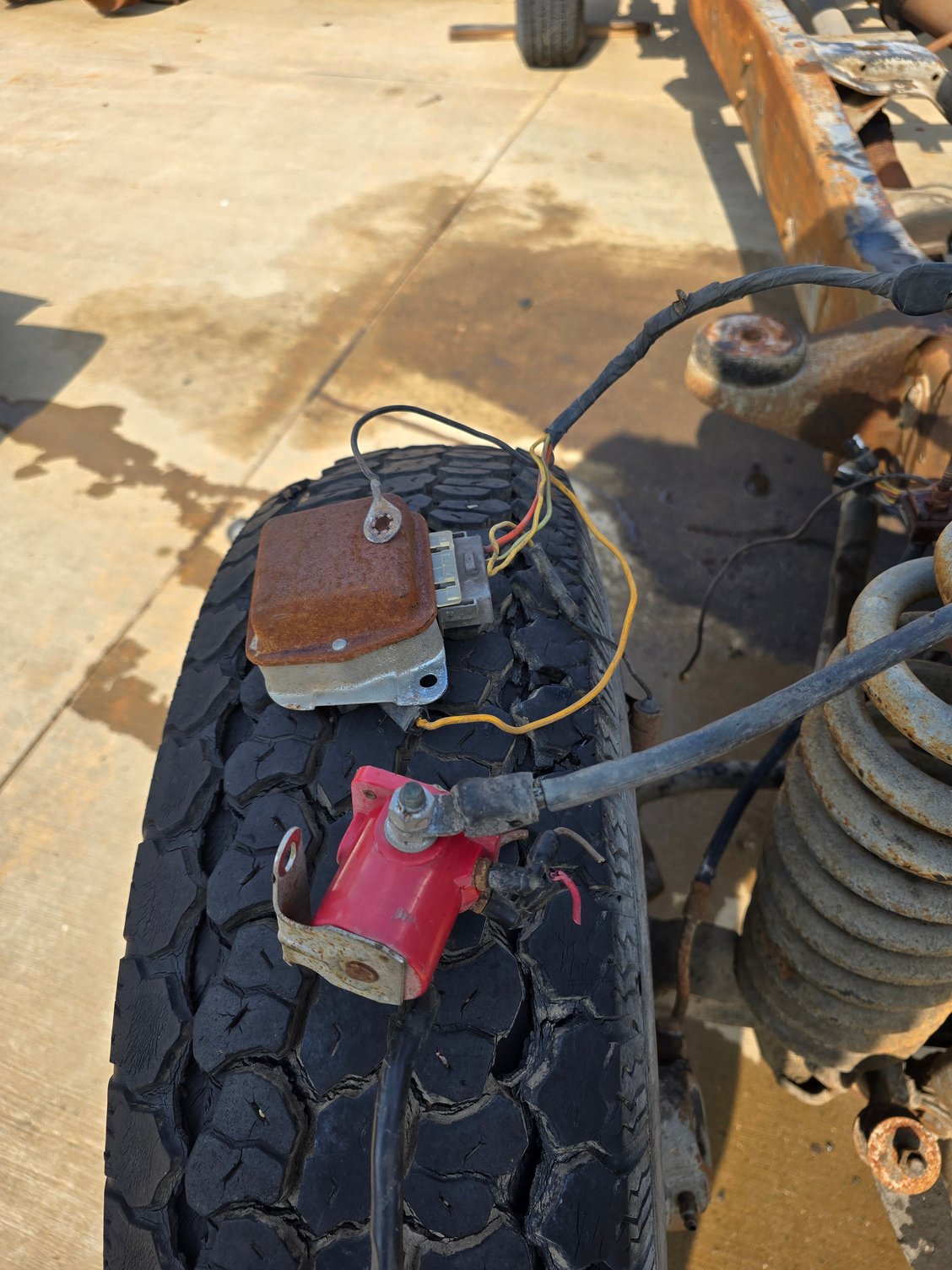

Can you post pictures of what you are working with, especially the area around the battery and the wiring coming out of it and anything near it.

Absolutely, and thank you sir. I will get some pictures tomorrow and post them.

Do you have the dura spark2 ignition module normally mounted to the inner drivers fender? If so make sure power can be supplied to it and the starter solenoid and it should be a go. There may be a few things to figure out based on what is there so pictures would help. You need fuel and spark and if you run it long enough a cooling system, I would at least want some water or anti freeze in the block.

I'm guessing the dura spark module is still there, but I'll know for sure tomorrow. I'll post pictures then. Thank you kindly for replying.

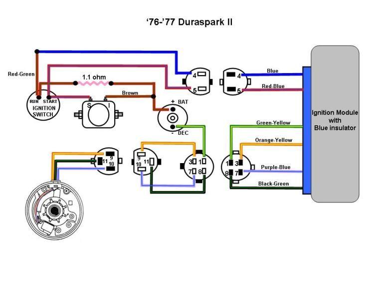

Cool, I'm YouTube famous
Here the picture I've referenced from time to time.
I'm terrible at explaining stuff but I'll try. The bottom 4 wire the factory harness between the Duraspark box & the coil / distributor. Run them as normal. Will need a 3 position ignition switch for the rest (off / run / start) & wire it in as shown. I've never bothered with a resistance wire as the picture shows, but I generally use a coil that wants 12v power all the time rather than just at start up rather than the 12v start & 6v run. You can easily cook a factory coil feeding it 12v all the time, then I'd recommend the resistance wire.
The big lugs of the solenoid are wired as normal. Battery positive to one side & the otjer to the starter. Battery negative grounds to the engine block.
A simple ignition switch can generally be found at the local auto parts store.
Thank you for the information. What would you suggest for a resistance wire exactly?

Pictures of what you are looking at would help alot
