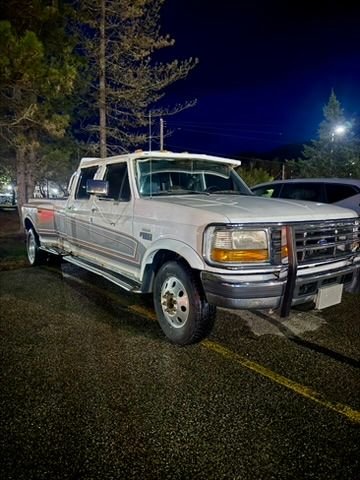

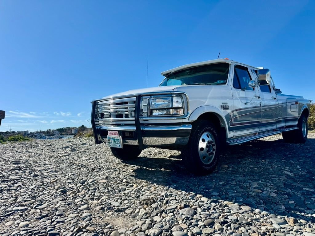

Hey everyone, new here and hoping to get some guidance from the experts.
Truck: 1996 F350 7.5L (460) with E4OD. 2wd Centurion
Background: Ran great all summer long put around 15,000 miles and it was great. parked it this winter ran it for a quick second with the postive and negative wires loose and the truck went nuts shut it off and tightened the connections and now i have this issue.
Issue:
Truck runs and drives great when cold. Once it reaches operating temp, it starts misfiring and the tachometer goes crazy. no power under load. If I give it more throttle, it holds around 1800 RPM and smooths out somewhat, but the tach still jumps around. When I unplug the 2-wire ECT sensor, it runs great even when warm (check engine light comes on, obviously).
Here’s what I’ve replaced so far:
  • Distributor
  • TFI module
  • Ignition coil
  • Spark plugs (look recently replaced and in good shape)
  • Plug wires
  • Engine Coolant Temp (ECT) sensor
  • O2 sensors
  • Battery and alternator are new
  • Verified coil positive voltage ~11.7V key on engine off
Additional info:
  • Sharp random pops when warm
  • Tach becomes erratic only once hot
  • Transmission codes present:
    • 626 Coast Clutch Solenoid circuit fault
    • 624 EPC solenoid circuit fault (KOEO and continuous)
    • 637 Transmission oil temp circuit above max voltage
It runs perfect cold every time. Problem only starts once fully warm. Unplugging ECT makes it run great.
At this point I’m leaning toward a wiring / ground / voltage issue rather than fuel or ignition components since so much has already been replaced.
Any insight on shared grounds, PCM power feeds, or common 460/E4OD harness issues would be appreciated. Trying not to throw more parts at it.
Thanks in advance.

Nice truck, btw.
