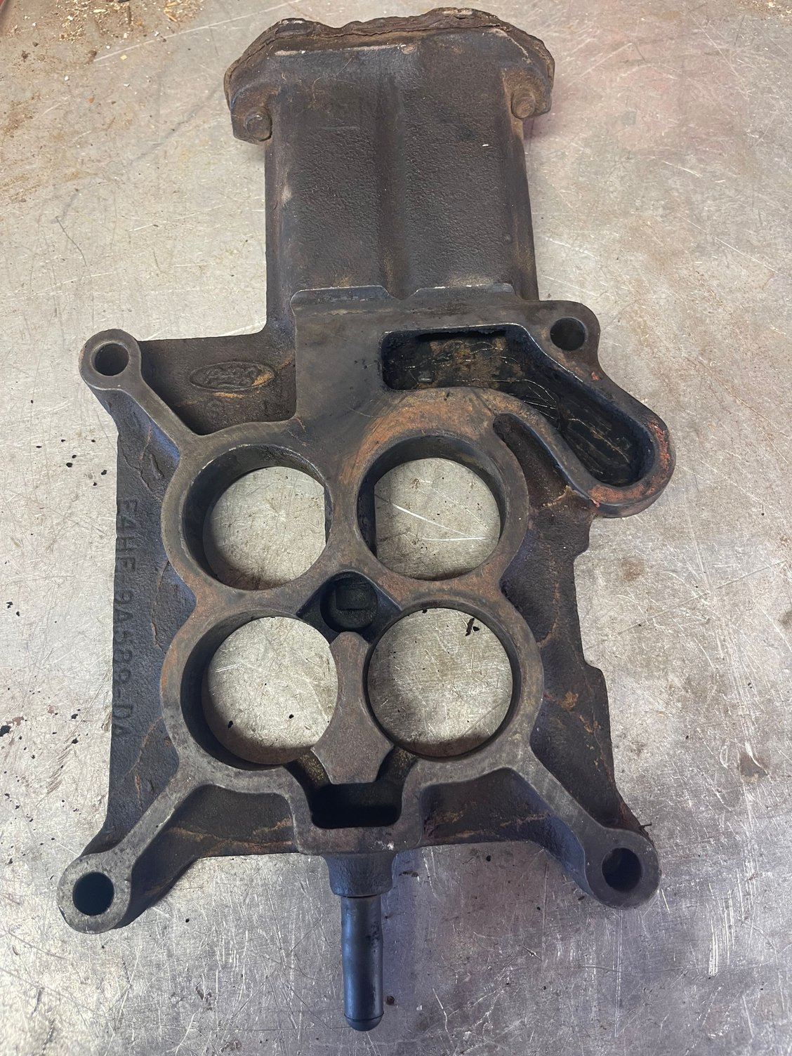

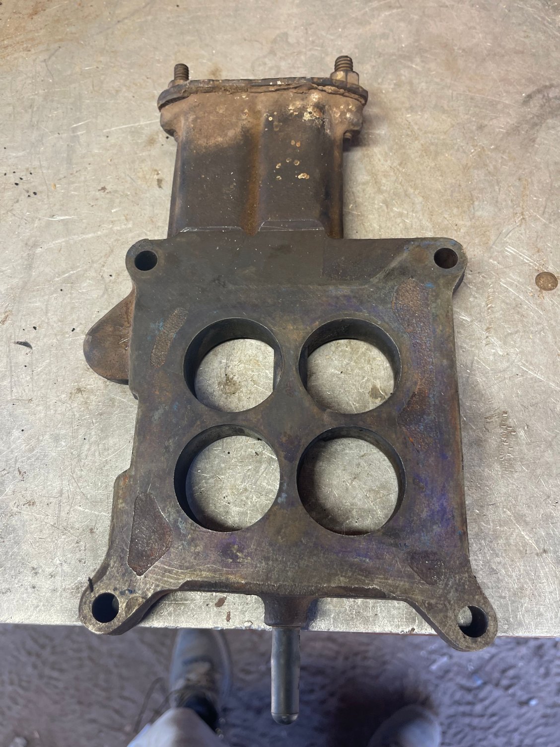

Hello, I have this 1985 460 from a F-250 4x4. When I got the truck it had a Holley 600 on it. The previous owner had removed some smog equipment. I changed the carb and it started and ran fine most of the time. I just decided to install a Holley Brawler carb. Upon removing the Edelbrrock I was reminded of this weird factory spacer under the carburetor. It is apparently partially modified but still is forcing air to denigrate to center of the gasket. What is the best solution for this situation ( short of a new intake manifold? The Motorcraft part #. E4HE9A589-DA. Thank you

That EGR plate gets it's exhaust feed from the heat riser in the intake manifold
Plugged off like you have it is the best option short of replacing the intake

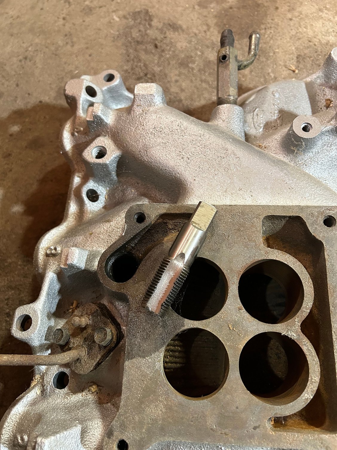

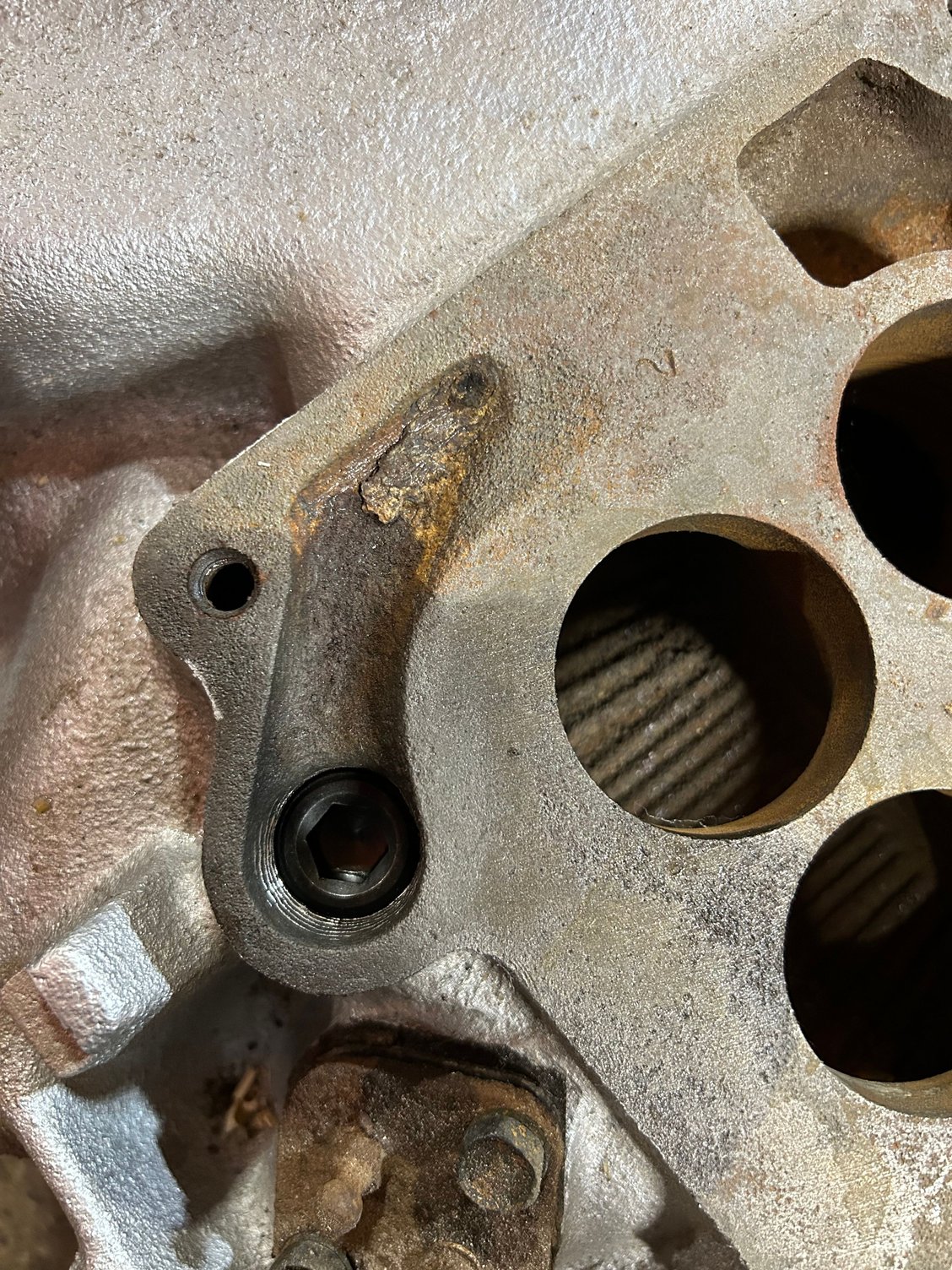

You could also use a 1/2 NTP plug. You can go to Harbor freight and get a tap and die set for 1/2 NTP. Run the tap down that EGR hole just enough to get threads. You don’t need to go all the way down and then plug it off and then you can put on your new gasket and that EGR spacer plate back on and that should help stop burning up the gaskets.
I just did this a few weeks ago for a 460 I’m overhauling. It was pretty easy to do.
