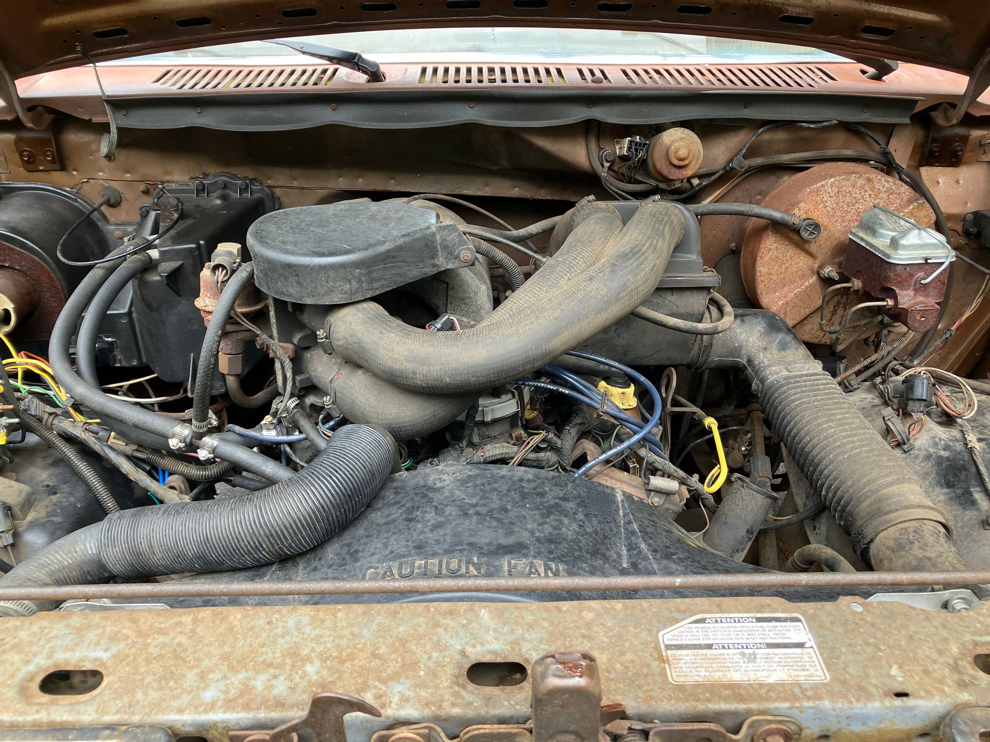

I looked on Fleabay for the seal and they sure were proud of them. I looked at LMC truck and while it wasn't cheap, it was cheaper, even with shipping, than other places. I put the original assembly back under the hood until I get a replacement. I've got a custom aftermarket unit until I can source a replacement factory style. I try to stay original on mechanical parts as metal costs money. Style and body parts sell cars. Stuff you can't see, costs money, and they wouldn't put it there if it wasn't needed. On the air cleaner assembly, I need to find another air duct as mine is full of holes. I snapped a few reference pictures yesterday before I started pulling parts.
Except for the air cleaner assembly, what you see is what I have. It's oily underneath (Gasp! A Ford leaking oil???? ) but the valve covers don't look to have ever been off. Since the photo was taken, I've removed the A.I.R. pump and I plan to cap where the hose goes just to clean things up a bit.
Indiana doesn't have emissions testing, at least not down here in the S.W. point, so if somebody wants to do a factory restoration and needs it, they're welcome to it.

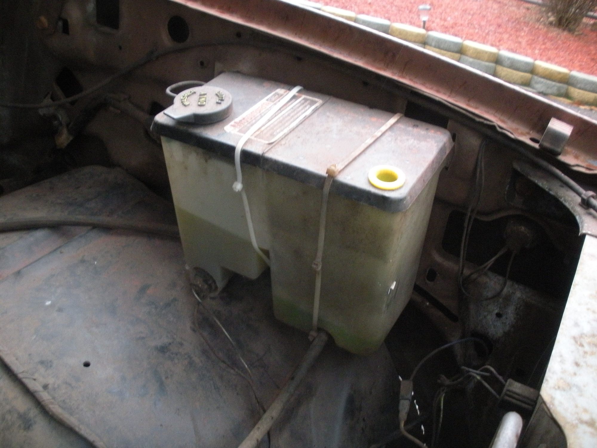

One question I have is, where is the radiator overflow hose ?
It doesn't have one. Nor does it have an overflow tank. That was one thing I was looking for. It would normally be in the area of the second battery so I'm going to look at the boneyard to see if anything from that era is in there to get ideas. I'm not sure the factory location of the fuel filter as I'm pretty sure it wasn't on top of the engine due to vapor cavitation issues. It only has one tank and an aftermarket fuel pump.

The radiator over flow hose went to the front hole, which is plugged on your's, side of the washer fluid tank.
Mine is a bottom feed, but yours was top, just make sure the end of the hose is blow the lowest level of coolant in that tank.

I wonder if his is also a bottom feed but with the battery where it is they could not hook the hose up?
I dont think I have see one feed through the top hole.
Mine is not a recovery tank it is an over flow catch tank.
It also does not have a way to fill it, or clean it, as it has no caps.

Yes, bottom feed maybe makes more sense. Notice I use a yellow cap plug to cap mine. The level in mine changes as it heats and cools as it should.

Mine is top feed, but not through the cap, through a separate hose hole moulded into the plastic. Top hole but the hose goes all the way to the bottom. No chance for leaks through a fitting since the entry is well above the hot fill level. Look for a recovery bottle from a 6 9l engine.
