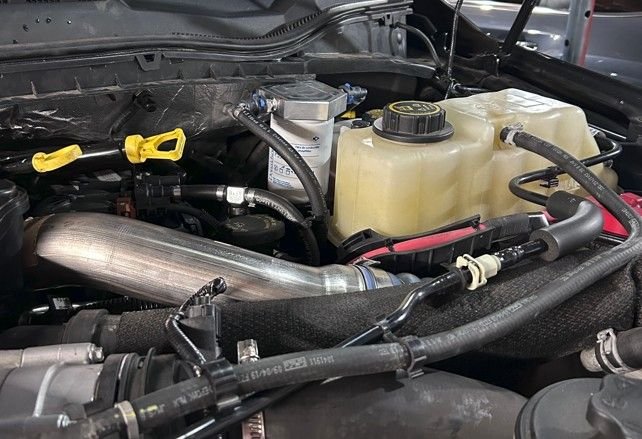

I started off by snapping the retainer clip on the vacuum line quick connect because I didn't know how to release it...a little extra force is not always the answer. Here's the quick connect.
If you ever snap that little black clip, the Dorman 800-023 is the exact part you'd need to replace it. Got mine at Autozone.
I did have to read carefully and consult a few different sources to ensure I had installed the fuel line correctly and did have to move one line I had connected incorrectly - again small variances from what was documented in the instructions and what my vehicle actually resembled. Still after about 6 hours, not counting hunting down that little clip and running to buy a couple 1/4" drive extensions and a long Torx T25 bit (really needed to access the front FSA bolt on the top of the CP4), I had everything together and when I fired up the truck, no leaks, thank you Jesus! Yes, I did a lot of praying working on this, and some asking forgiveness for cussing some...no one's perfect.

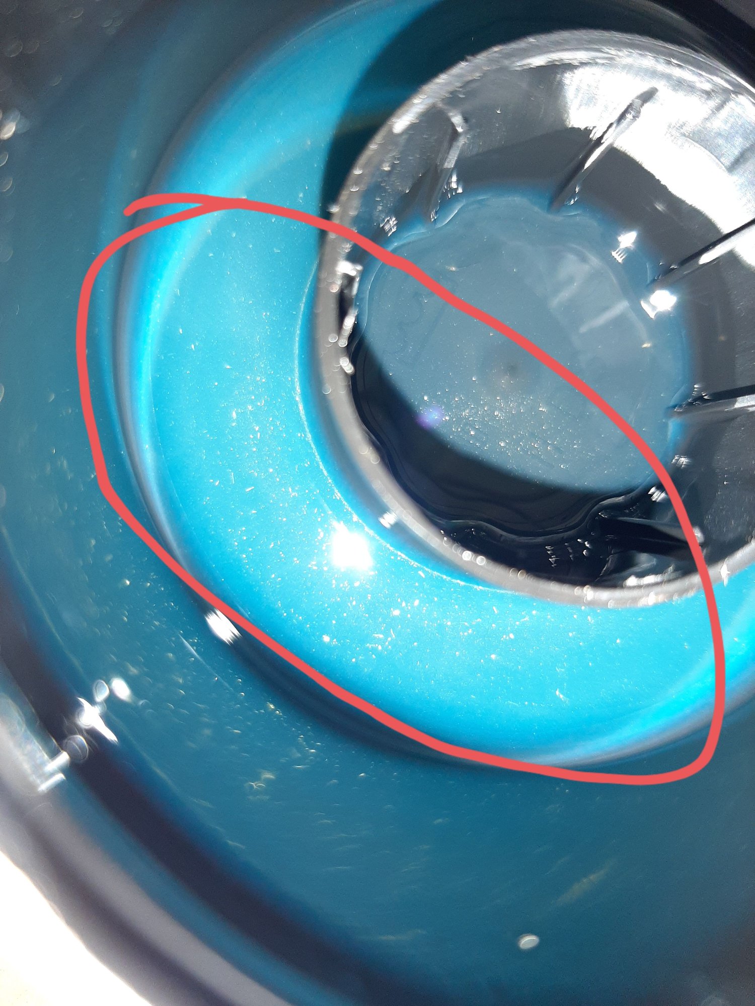

My customers that let me service there 17+ trucks every 30k, and the 20k or so on the 2016 and older dont have issues... Almost Every truck is a work truck being worked hard by someone that doesn't own it, so of course bet on it. The ones I consistantly have to replace the fuel system on are ones that have not been letting me service there truck and either go way to long between filter services or using the china fuel filters. The one in the picture is the latest one waiting to get fixed in my yard. This one has had China filters on it for the last couple fuel filter services... This one actually runs, starts, drives great. It only would set a P0087 when towing heavy and the driver puts his foot in it.. It was wanting 29k psi but was only making 25k psi.
To each there own, but I dont install the return filter kit. All it does is keep any metal from getting back to your tank... The factory filters do a great job at keeping anything left in the tank from getting back to the engine...
