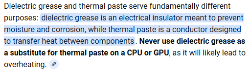

FORD sends clear silicone dielectric greaser
The clear silicon is for the electrical terminals only.
Two different things for two different purposes.

. I will clean it up real good and use the clear silicone dielectric grease.
You apply the dielectric grease when you plug it in, and it only goes on the electrical plug to keep moisture out.
