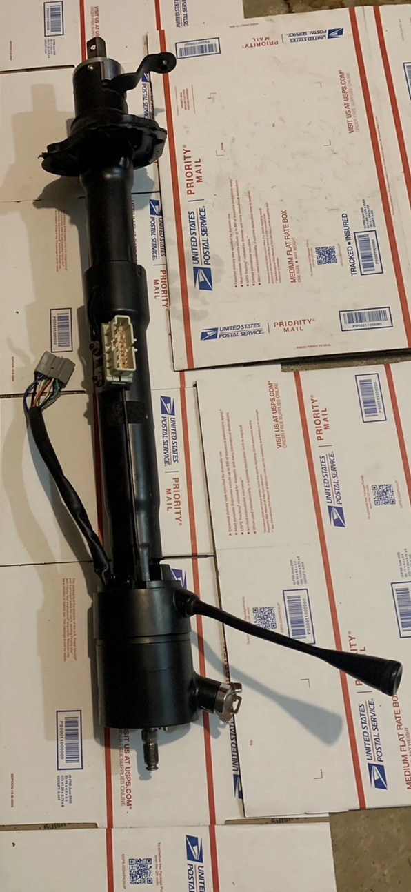

My tilt function is history, grabbed the steering wheel too many times to get in the truck. I McGyvered two cedar shim shingles with 4" hose clamps to keep it straight, but it's got to be fixed. RSC Steering Column Service has a 100% satisfaction rating on Ebay. I've never used Ebay, and just registered on the site yesterday to locate a rebuilt column. New or NOS doesn't appear to be available for 1988, and I don't want something out of a junk yard truck.
I've read all the site guidelines, and this is not an effort to advertise for this re-builder. I'd just like to ask other Ford truck owners if they had done business with RSC, and if the excellent rating of this seller on Ebay is justified. The complete rebuild includes new upper and lower bearings, turn signal switch (mine is barely functional), ignition actuator rod, etc.. It's $755.00 after core return, not cheap, but there's a lot going on inside that column, too many things that I could easily screw up in a piecemeal repair attempt. Any feedback from FTE members would be much appreciated.

Why not try to rebuild yours?
The issue is the three screws that holds the lower column to the upper.
Over years of using the steering wheel to pull you into the truck, they loosen then break.
I have replaced them three times so far on my 88 over the past 500,000 miles

to be honest, it may be cheaper to find a tight column in a salvage yard.
i understand your reluctance to do the repair yourself, as i am also "older than dinosaur poop" as my grand daughter says.
plus with my health issues, getting into position to actually get the past out to do the repair and then back in are not fun anymore either.
there are a few listed in CA on www.car-part.com between priced between $200 and $450, with a few more listed "call for price"
