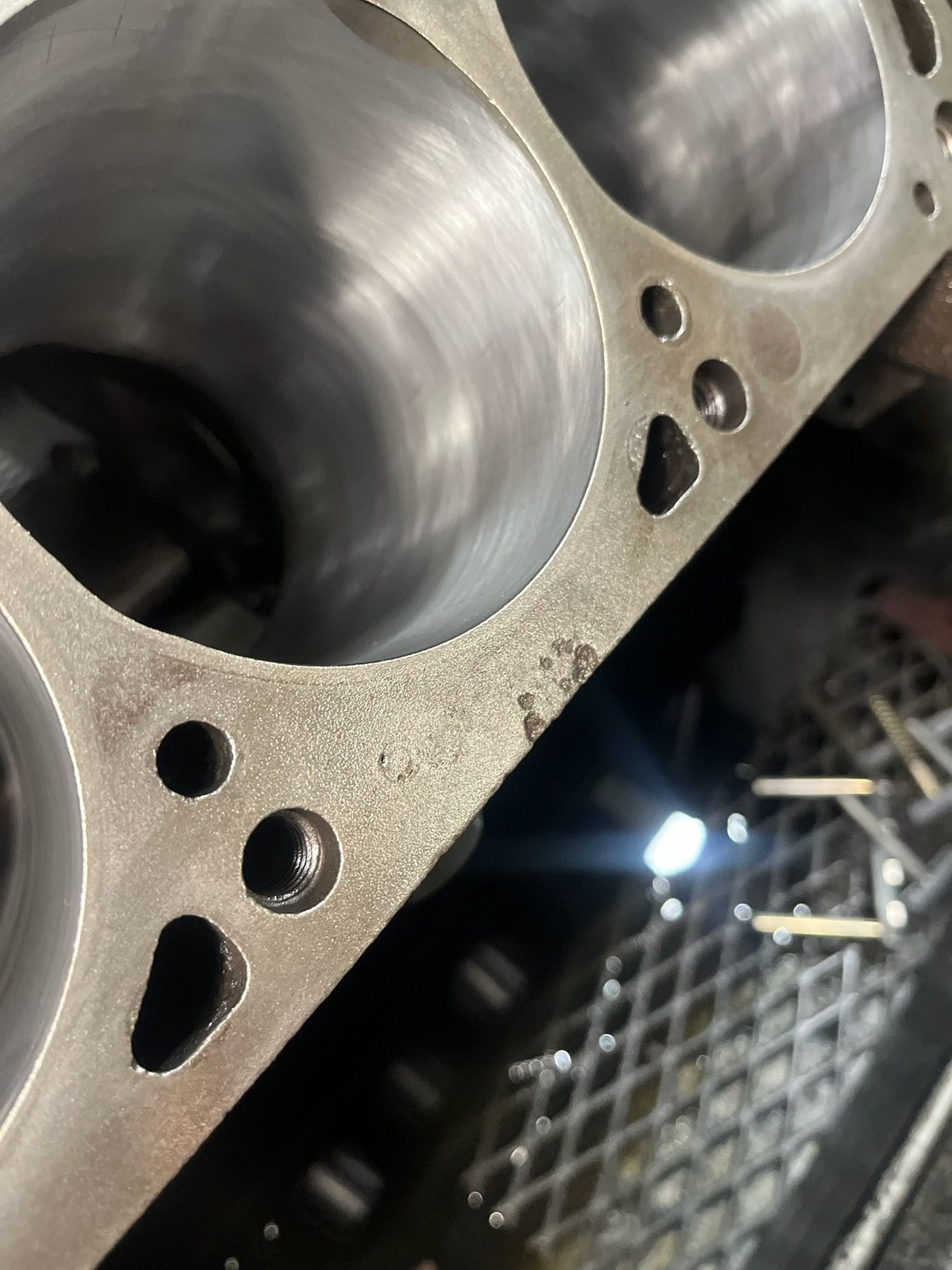

Does this need to be decked?
My machinist is asking if I want to have this decked because of these spots. What do you all think? I'm leaning toward saving the $100

Looks a little rough.

TBH I think I'd invest it. Those dimples are putting a lot of faith in a head gasket. It's good they're that close to the edge but almost half that sealing surface between cylinder and edge is compromised in that area. I'd spring for the hunny

Do it now because the block is out of the truck, already apart and at the machinist. Think about how you will feel if you do not do it and the headgasket lets go after it is back together and back in the truck. $100 bucks is cheap insurance to know, that area will not be a problem. Kinda like buy once, cry once.

Dude.... it's all of a hundred bucks. I know that costs can add up fast but I would not even consider cutting corners with stuff like this.

Well, I talked earlier to the machinist and he said it should be fine. You all have me doubting the decision now, haha. I guess $100 isn't much. Costs do add up fast though.
I hear you on this one believe me... doing my 360 FE rebuild right now... and I'm looking to save $$ too. But, relative to the whole job $100 is probably not "that" much and peace of mind that the head'll be tight. One of my mottos is "pay once, cry once" ... this is likely one of those situations.
I also believe that your machinist is looking for a yes/no so that if you say leave it, (and then it fails) he'll say ... "well I asked if you wanted it done and you said no" ...it's a reasonable question for him to throw to you

I would not deck mine over anything I see in that picture.
I would do what I've always done without ever having a failure. Clean the block & head surfaces, look for serious damage, check for flatness, prep my head gaskets with a first coat of High Heat Aluminum Engine Enamel (aluminum has powdered aluminum in it). When dry, I'd apply a second coat, let it at least dry to touch too, then put them on followed by the heads, and torque them down.
I don't care what kind of head gaskets, that's what I do and to this day, never have I had a failure.
