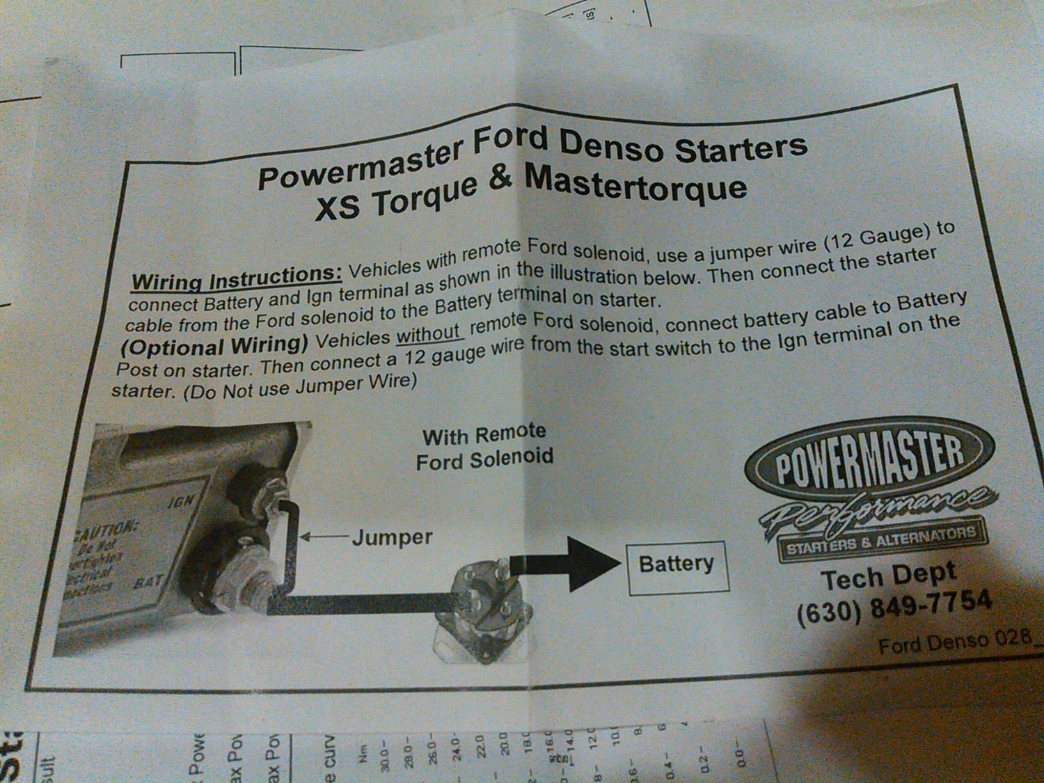

So you got a Powermaster high torque mini starter correct? PM XS Torque....There are some wiring differences, so not exactily plug and play with the OEM wiring. There a few threads that cover this.
Yes. And I'm aware of the jumper i have to do. Im fully prepared for this fix. 🤞

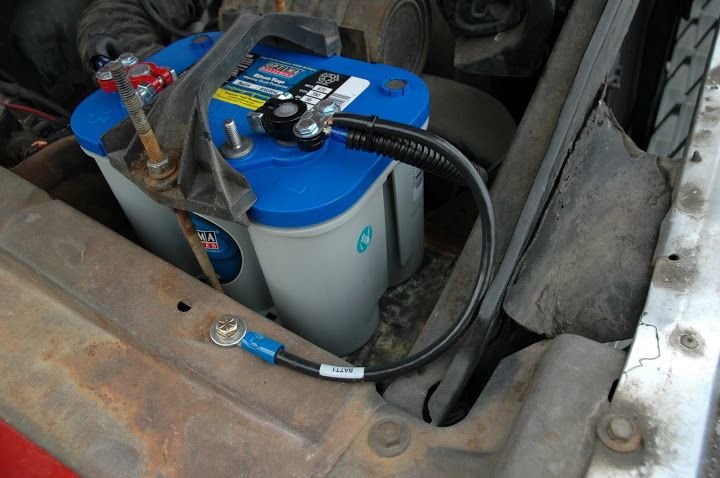

whats the battery ground for? Will i need that? Just wondering since i didn't read anything about that.

That is a fellow FTE members awesome idea on how to simply add another ground. You go not persay "NEED" it, but it is a very solid and good idea.
