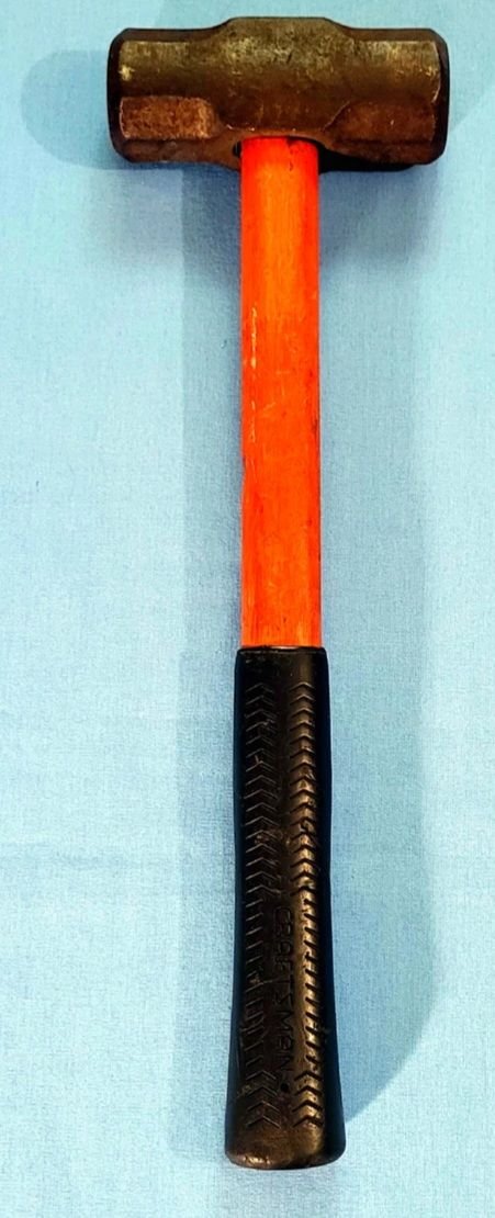

Originally Posted by torq'ta 5 8
The best 5 tools I ever bought, for stuburn nuts/bolts.
missing (1) tool. My bfh.
Old Feb 9, 2026 | 01:54 PM
wannabuyaford's Avatar
wannabuyaford
Joined: Jun 2023
Posts: 318
Likes: 25
Why didn't I think of that? That'll work great on a 30 year old o2 sensor and exhaust pipe.
