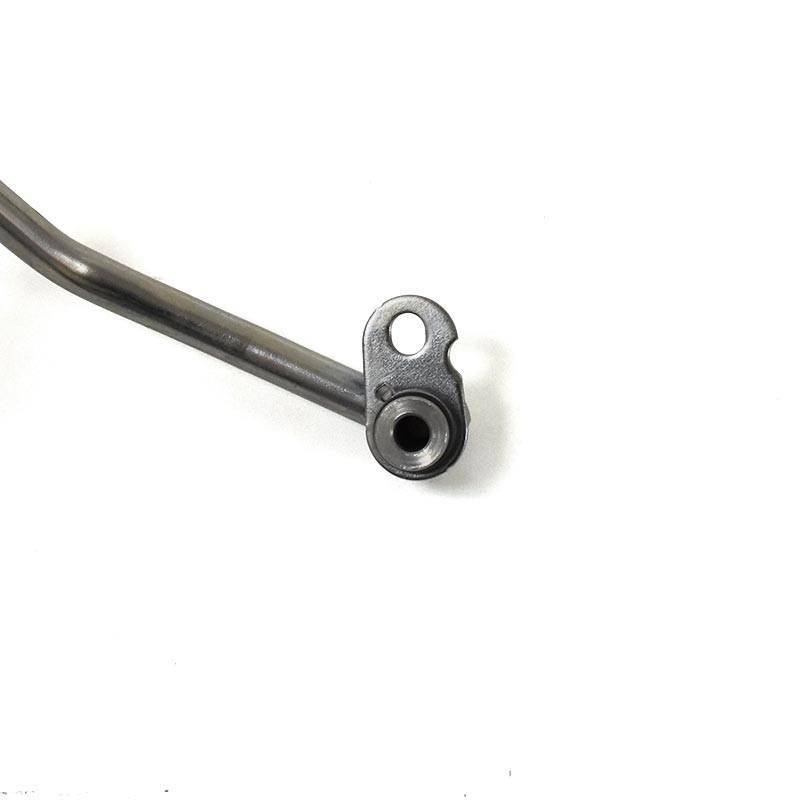

Not going to bother with the coolant line. Inspected with a mirror and it’s in great shape. The 2016’s have a revised line secured with a bolt vs the quick connect/clip on the earlier models.
old:
Old style quick connect
Revised
Revised

Great information... thank you.

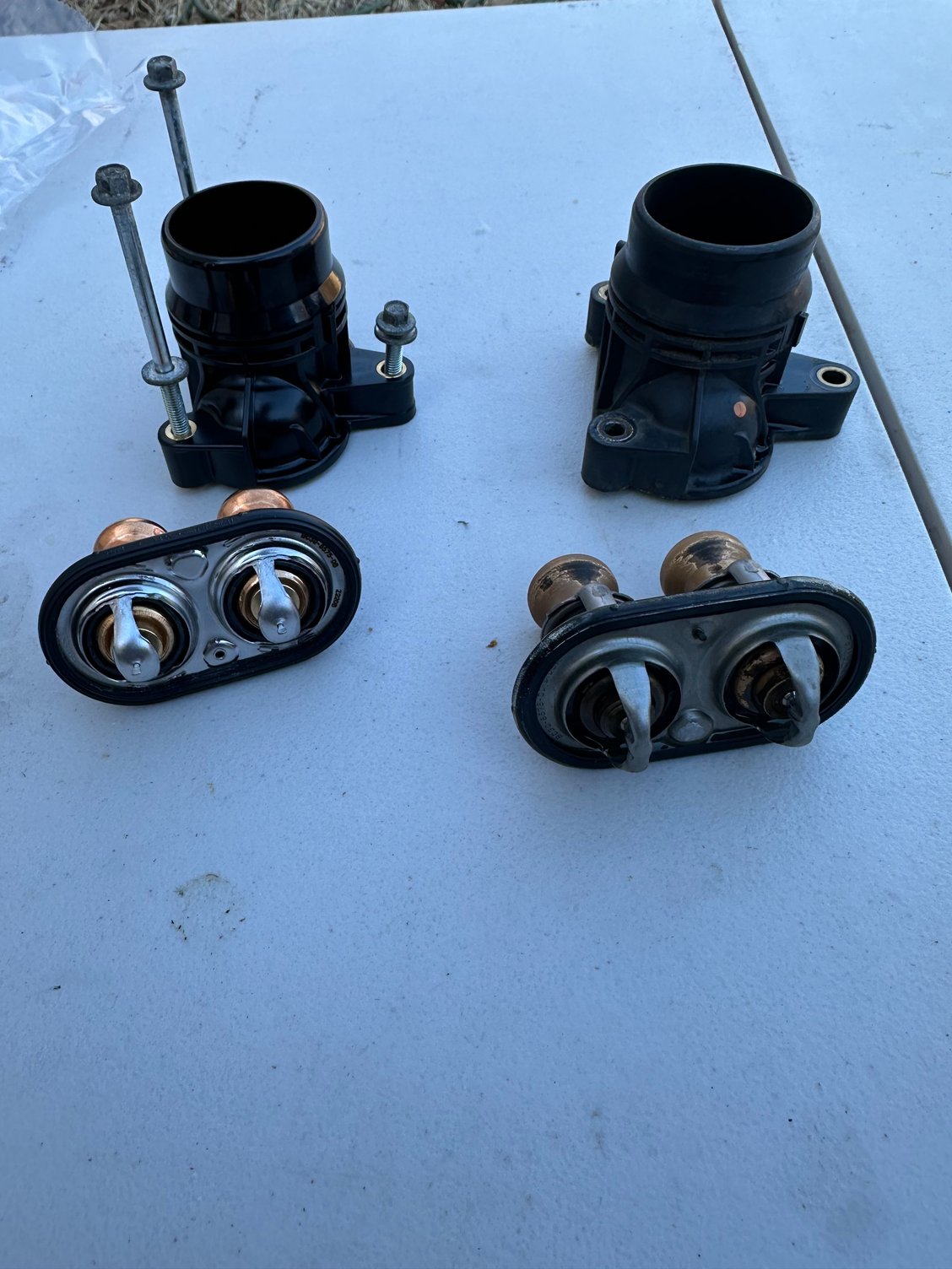

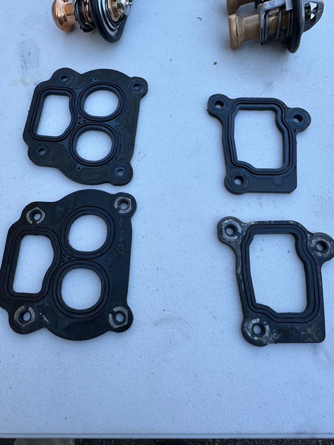

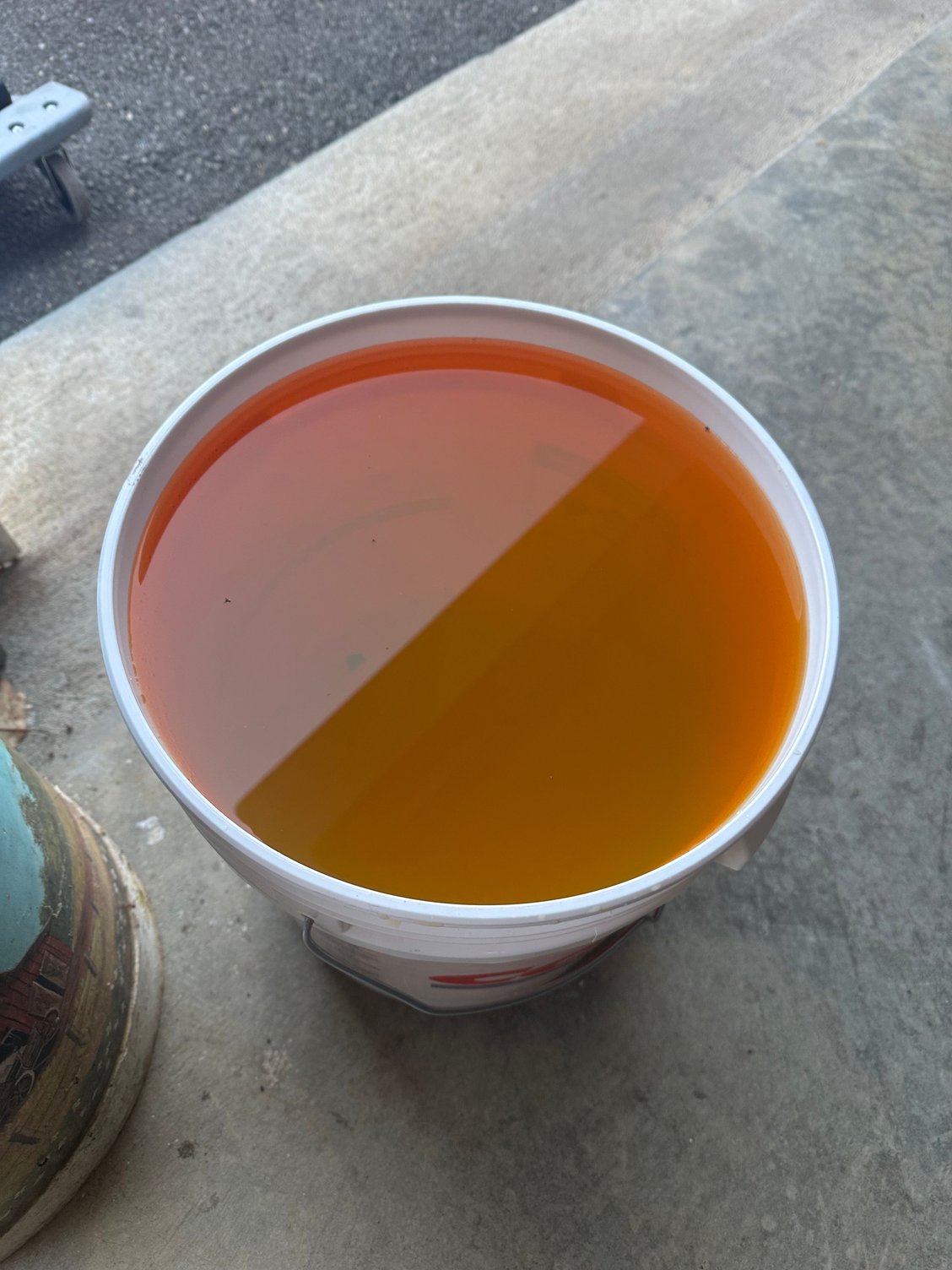

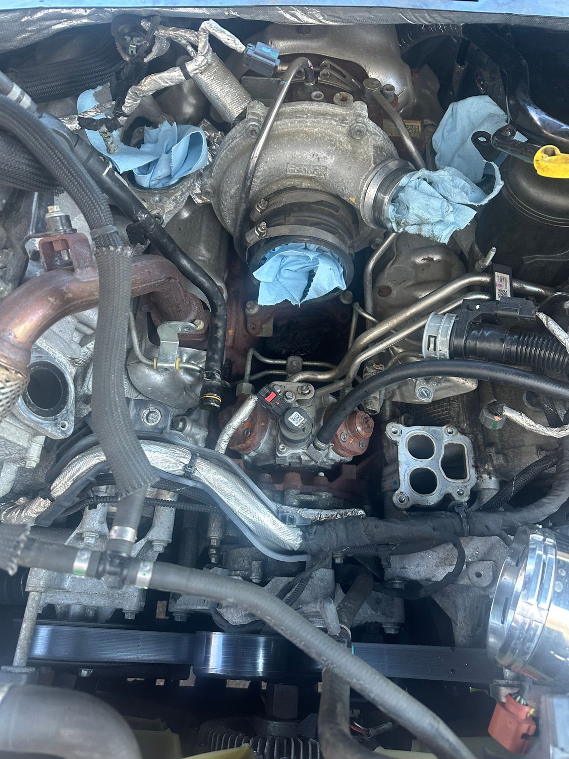

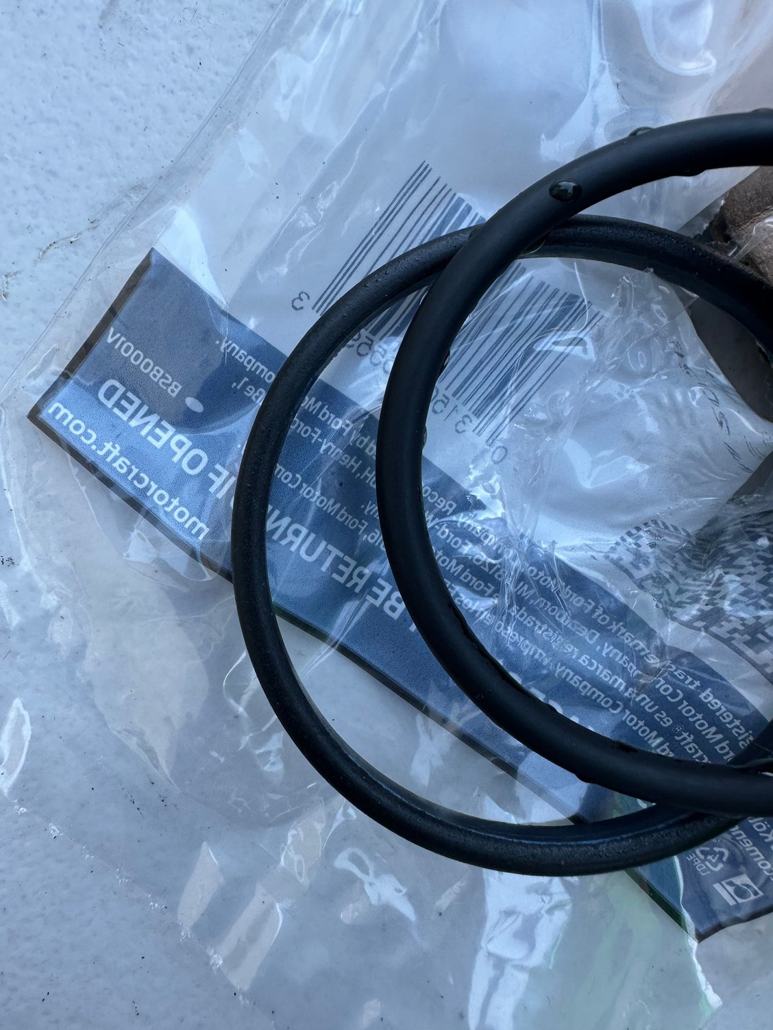

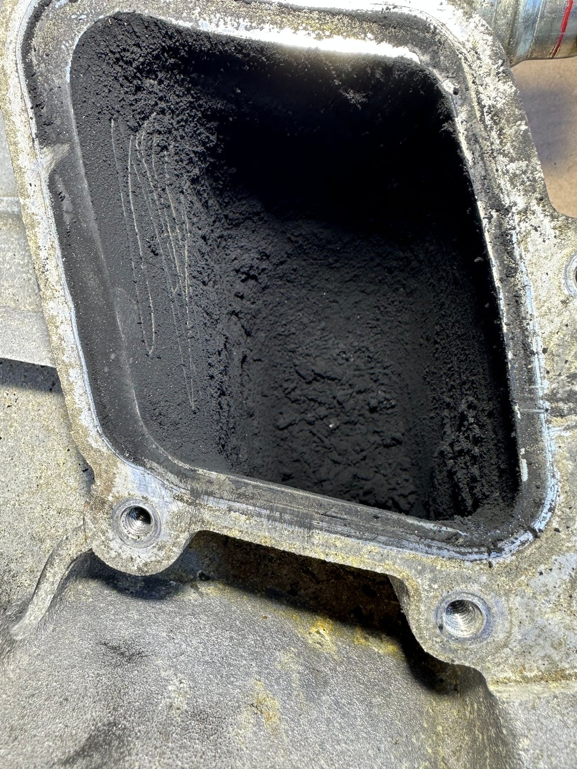

Ok, got it done on Saturday. Upper intake manifold is such a pain! But overall, not too bad. Leak honestly could've been from the upper radiator hose with the o-ring so flat but shouldn't have anything to worry about for a while. Also took the time to tighten the vacuum pump bolts. 2 of the 3 accessible from the top were loose. Mahle kit GS33691 includes everything you need including the o-ring for radiator hose to thermostat housing and new thermostat gasket. (I replaced thermostat and housing just cause)
disassembled
disassembled
old vs new
old vs new
replaced thermostat + housing while in there
upper radiator hose uses 2 different size o-rings. rts1070 for the lower connection to thermostat housing, and rts1069 for connection to radiator.

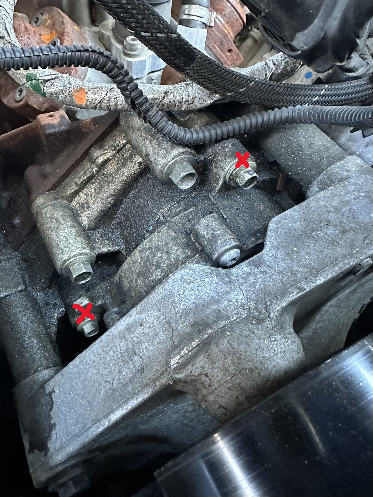

Loose vacuum pump bolts seem to be a common issue on these trucks. Should be accessible for most by removing the intake pipe.

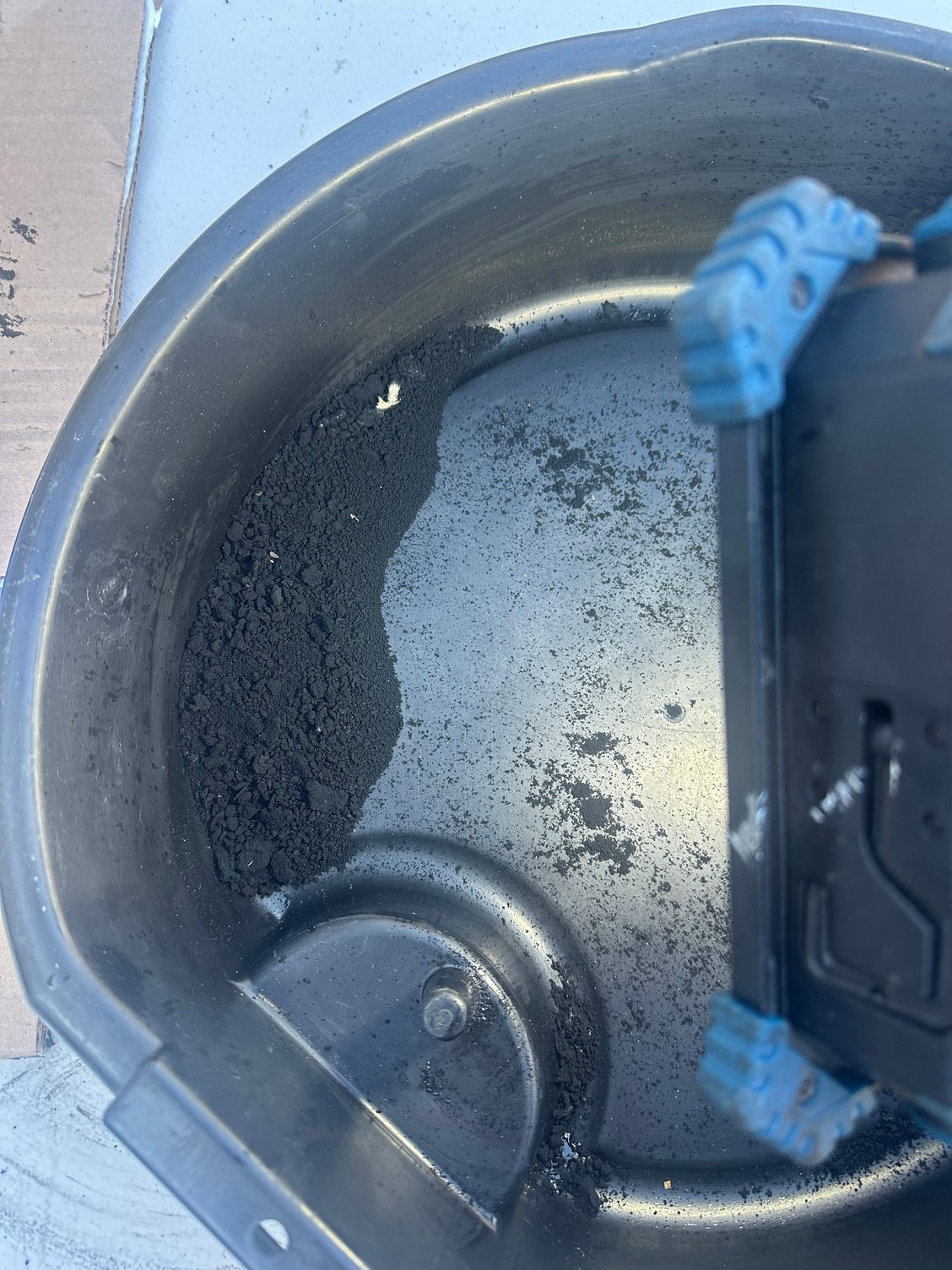

Cleaned ~30k miles ago when installing DPK.
Still a considerable amount of soot buildup.
Drained and filled coolant almost a year ago and a good amount must remain in the block. Not as yellow as I expected.

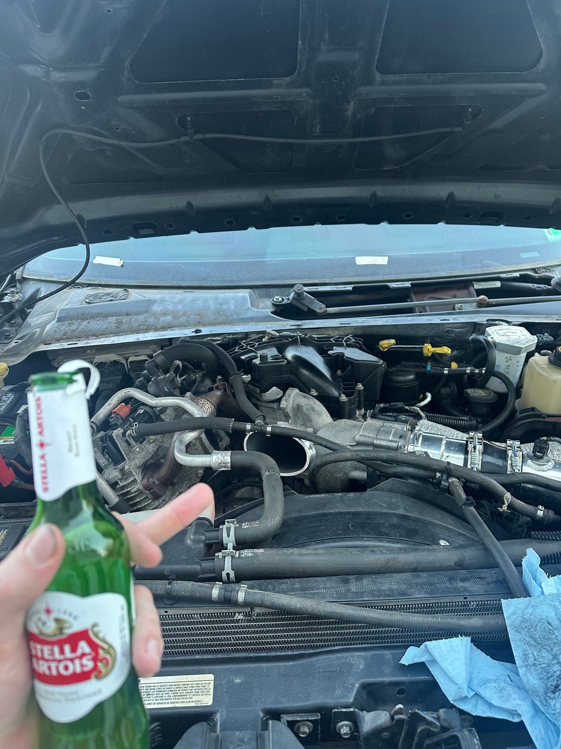

Celebratory beer after re-installing the upper intake manifold. such a pain!!

Are you intentionally flipping the engine bay the bird??

Yeah, after laying across the engine bay for some time busting knuckles finessing the upper manifold into place while getting poked by the hood release I was a tad cranky. Should really invest in a top side creeper
