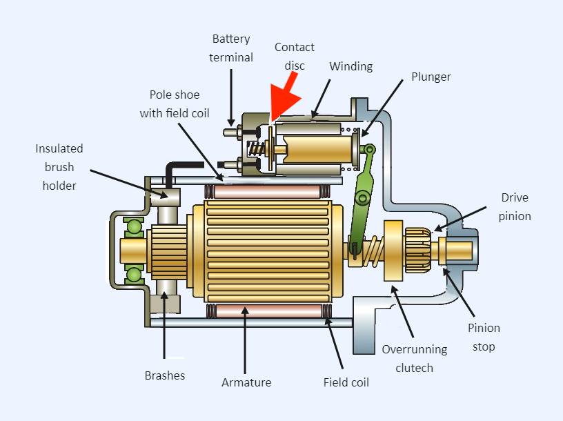

The contact disc within the solenoid, mounted to the top of the solenoid, is not making full contact, probably.
