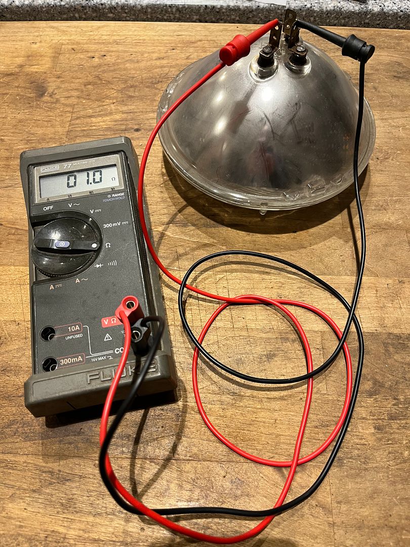

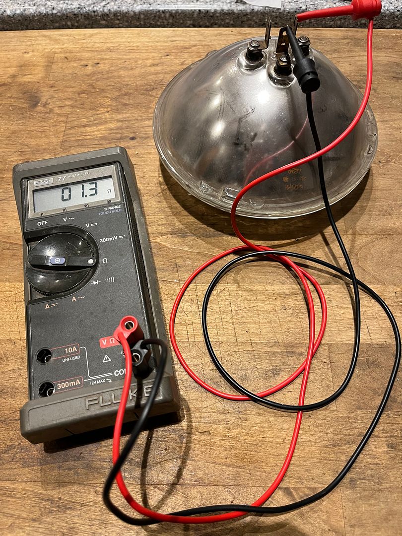

You can test the bulbs using your multimeter on the ohms setting. Ground is the horizonal connector so black meter lead goes to it - although not critical for testing ohms. The vertical connectors are low and high beam. Touching your red meter lead to one and then the other should show a low ohm reading of between about 1.0 - 3.0 ohms. The current from the meter battery going through the filament will heat up the filament slightly and change the ohms value for a few seconds. As long as they are low ohms and not infinite ohms they should be good. The values might vary slightly between one connector and the other. That resistance combined with the current from the truck battery when turned on causes the filament to glow which is the light that shines.

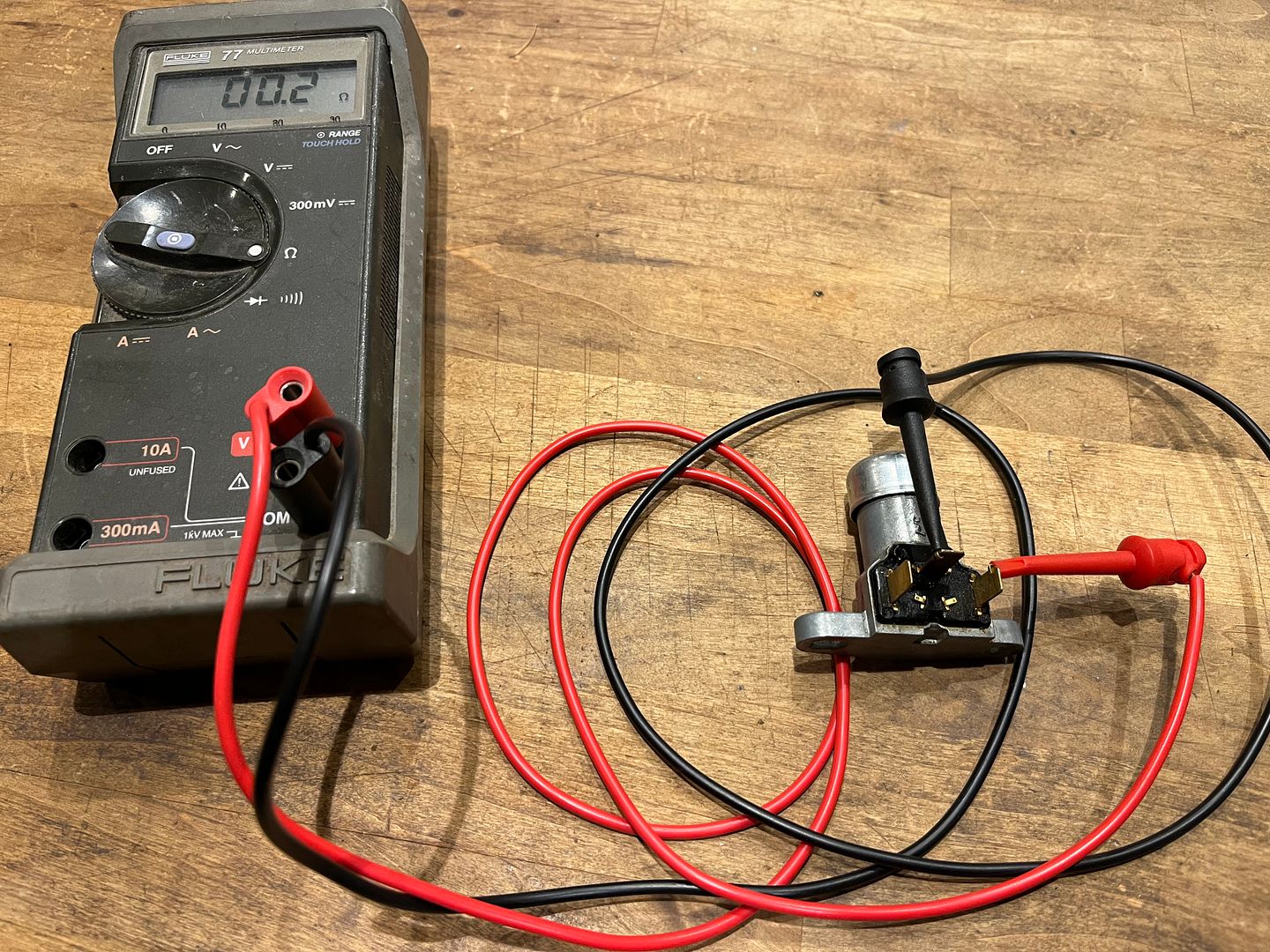

Likewise, the floor dimmer switch can be tested. The horizontal connector is 'power in' in this case and not ground but it's the common connector so black can go to that one. Then red to one or the other. It should show very low ohms on this like 0.1 to 0.3 on whichever side is active. Once you see the low reading then push the button on top of the dimmer and it should go from very low ohms to very high ohms - as in infinite ohms. Do that for each side and you may detect a problem, like if one side doesn't go low ever or if one side fluctuates constantly that is a bad sign I've seen as well.
