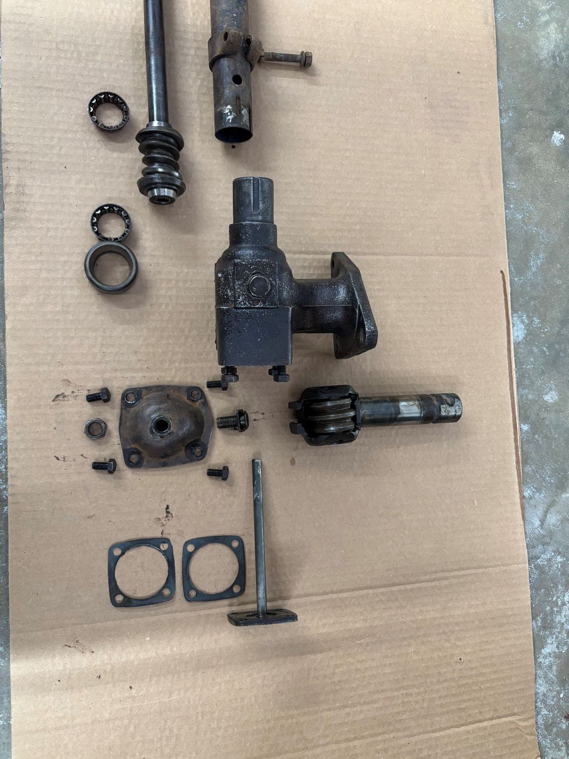

Based on comments received, I decided to disassemble the steering box to look at the condition of parts. The box was filled with grease. The worm gear and sector gear appeared to be in generally good condition and operated easily through the full gear engagement. I will reassemble the steering box until I decide whether to reuse it, or go with the heavier duty box, or power steering. I have a good bit of work to complete before reinstalling the steering, but was trying to look ahead.
Disassembled steering box and rod.
Closer view of the worm gear.
parts look good. I'll bet it's been rebuilt in the past. The worm looks better than any "used" worm I've ever found

Thanks for the observation. This is the first I've ever seen of these internal steering parts, and need to rely on the experience of others.

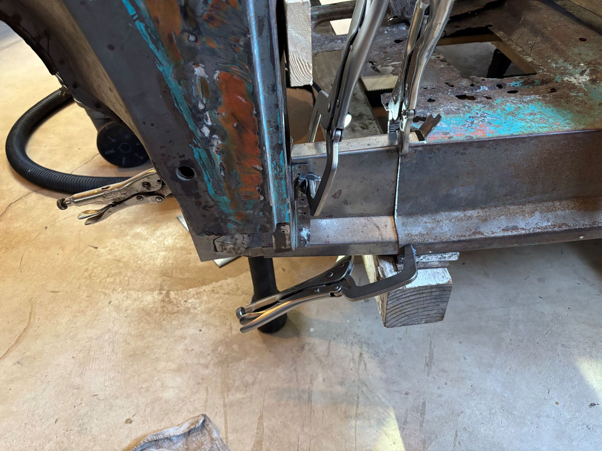

Rocker and Floor Panel Repair
Fabricated pieces of rocker panel.
Partial rocker panel removal.
Partial rocker panel removal view from under the cab.
First piece of rocker panel clamped in place for welding.
Repair for corroded kick panel at floor dimmer switch and new floor panel clamped in place for welding.

I'd sure replace the bearings at least,they are 70 years old. I had mine rebuilt with the full kit from Dennis Carpenter.

Thanks for the comment. All bearings and springs have been replaced.

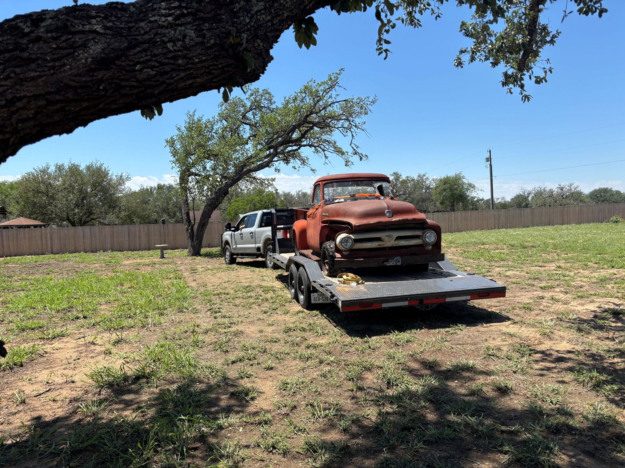

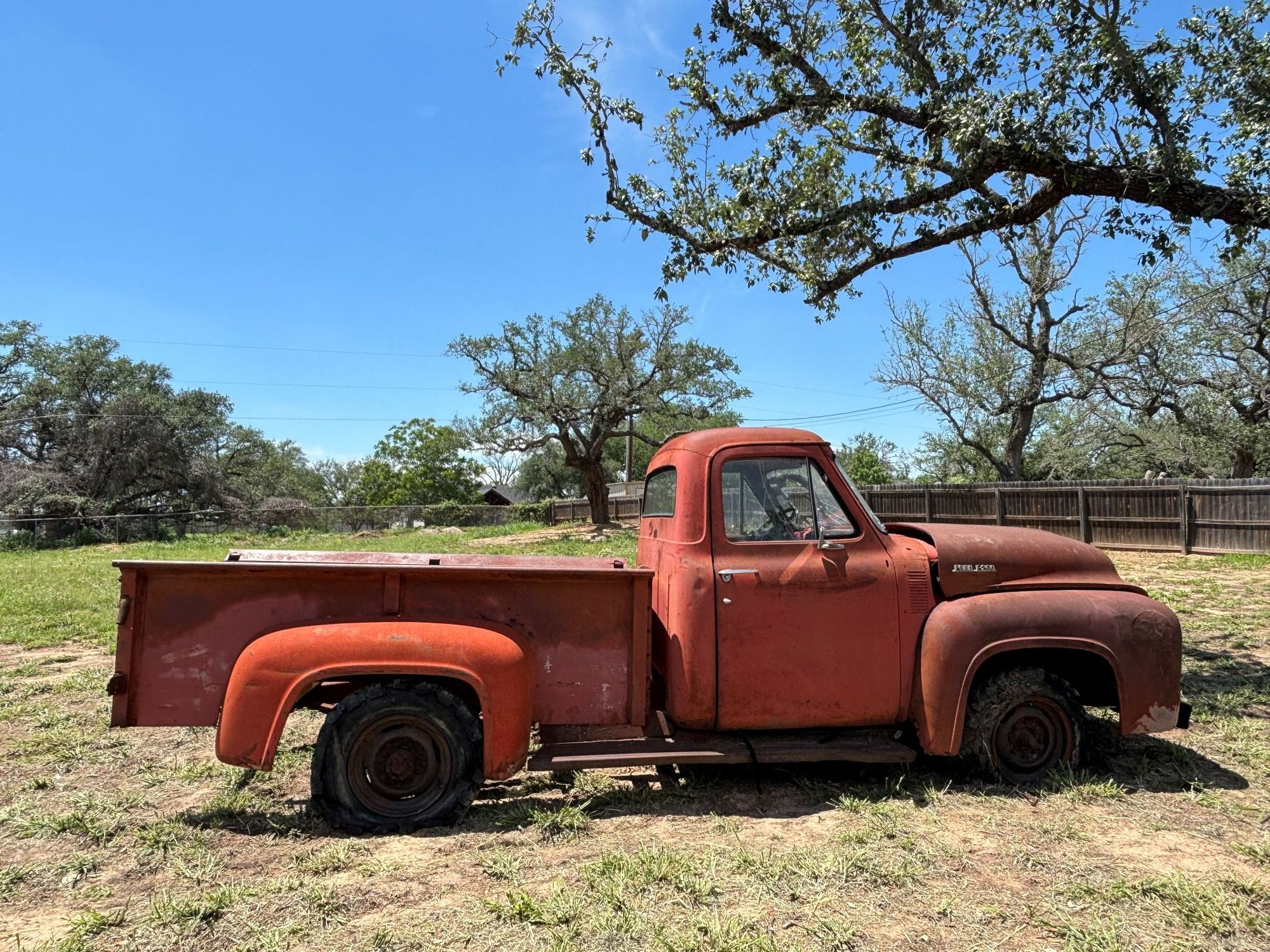

Parts Truck
I bought a 1953 F-250 pickup for a parts truck for items currently missing from my 55 F-100 build that are compatible. I currently plan to use the bench seat, steering wheel, fender alignment rods, horn, front hood emblem, original gauges (maybe), radiator, heater, door and window hardware, and lower front shock mount bolts. There may be other items, but I haven’t fully determined that yet.
The truck has a 215 CID EAA straight six engine and three on the tree transmission that I don’t have a use for. Engine crankshaft turns, but I don’t know anything about the overall condition, except that it has been remanufactured by a motor rebuilding company no longer in business in Houston. Engine has the starter, generator, carburetor and an oil bath air filter. If you see anything that might be of use to you that is not listed above, please let me know.

Originally Posted by bigwin56f100
There are still nos parts available here and there for the 4C box (f350-600 box)
I've been installing the f35-600 boxes into f100 for over 20 years and everyone loves them.
for starters they are heavy duty compared to the f100 boxes. Also the larger trucks don't get the miles that the f100 pickups got. They are always in good condition in the f600s. Grain truck, fire truck etc
I core f100 boxes and everyone of them has a bad worm gear. Chipped/broken on the worm or the worm looks like a razor blade. Always in the middle. So when you try to adjust to take out the play the steering worm/sector bind on the full turn due to less wear on the full turn
