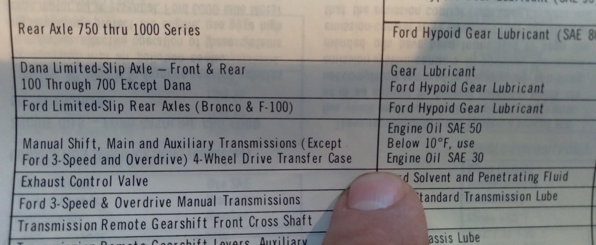

The 435 DOES NOT call for gear oil. I'll send a picture of the 1969 ford dealer lubercant chart if you want. It calls you sae50 transmission oil.
If you use gear oil you won't be able to shift it.

Here's what ford has to say.

They also call for GL4 which is low to no sulfur. Amsoil would flow with no problem since it's a full syn, it has a -56C pour point. Not very many oils have this low pour point. The lighter oil may flows better at cold temp. but the spec I find for syn 50w pour point is -42C. So it would be stiffer than the 75-90w.

Quite sure that spec was superseded with GL 1, 2,3 and 4 since 1969 or '66
I would just use GL4 gear lube
GL5 the newest spec, I would NOT use
