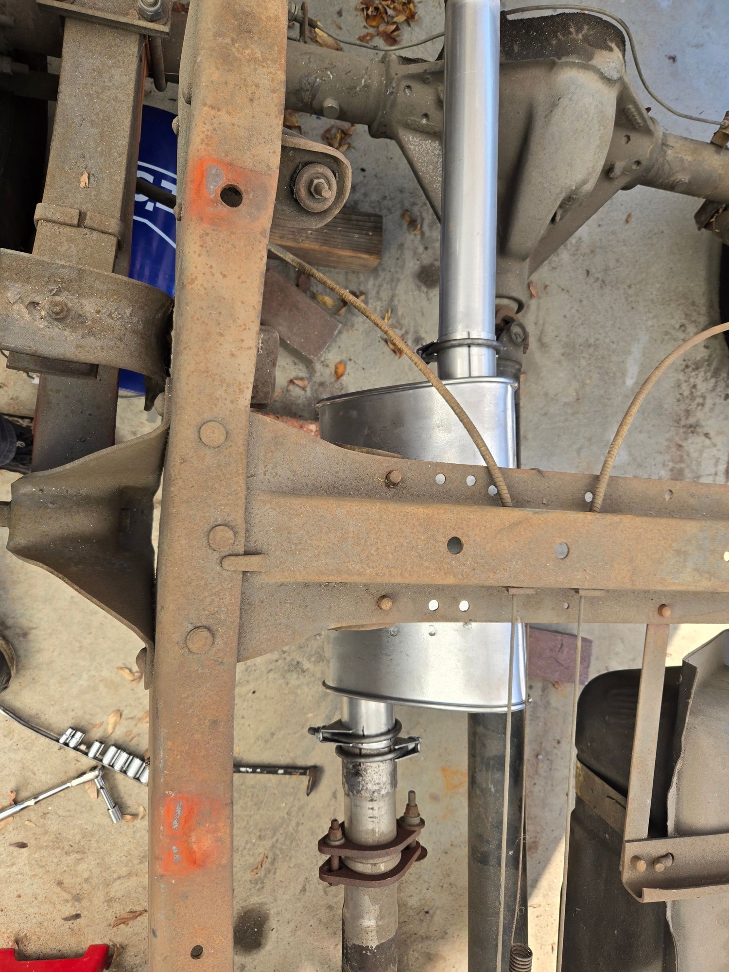

I have had a FM 50 on my truck for about 5 years. I never did like the drone at 40mph. I was watching YouTube and came across a David Vizard video (is that correct spelling?) on exhaust. I think it was this one:
In it he tears up FM mufflers and explains why they hurt hp. He also recommends a muff. he helped design and said that it would add 10 hp over a FM. You see, I watch YouTube vids and it shows me how to spend my $. So I bought one of the DynoMax mufflers and it has been sitting on a garage shelf for 3 years, waiting to be installed. Today I installed it, and sitting in my driveway it sounds pretty much the same as the FM. We'll see when I get the truck on the road. Thoughts?
I drew a red line around the flow directional device the Vizard added.

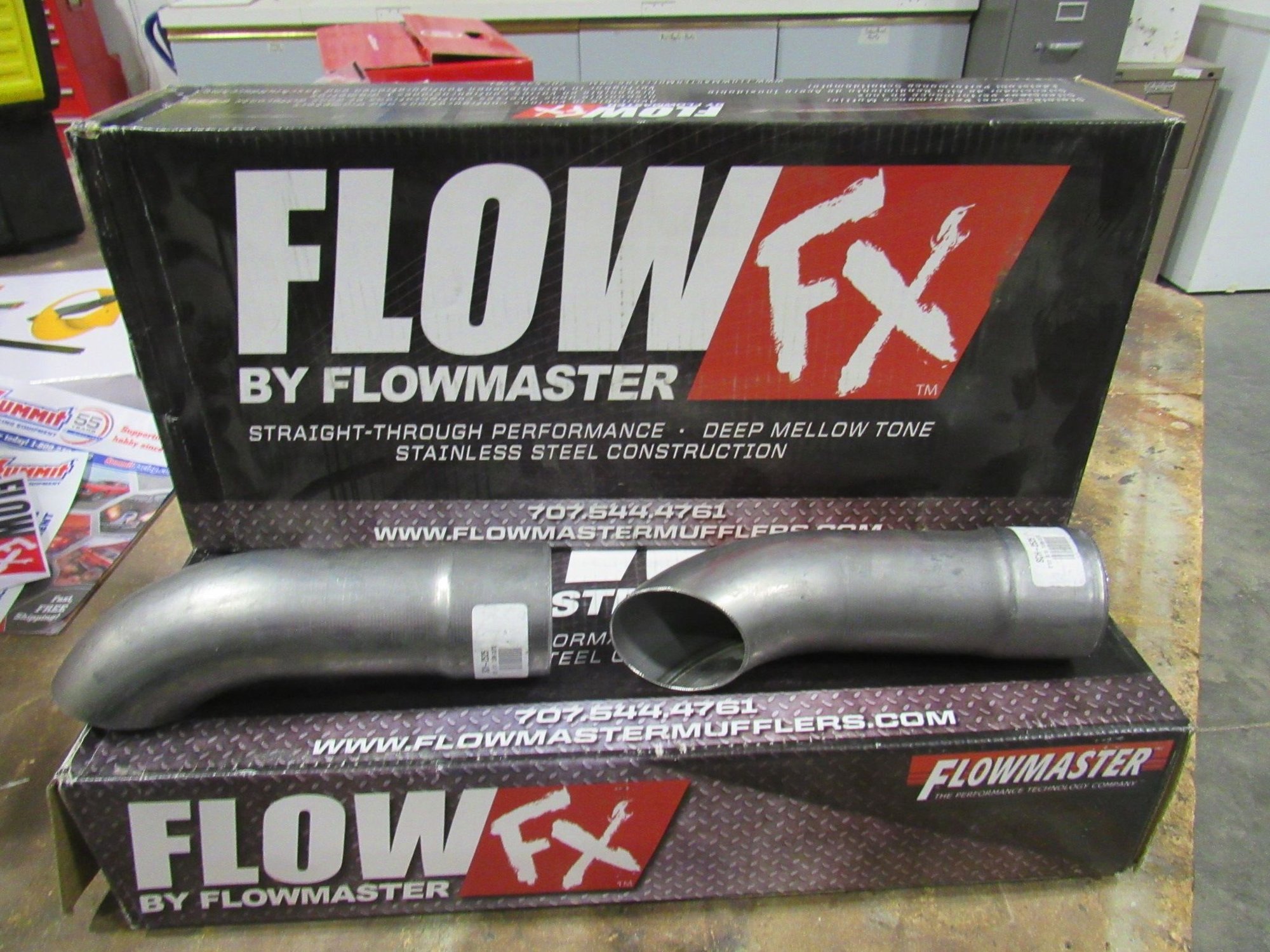

Here's my truck with open Headman Hedders
Just the hedders with turn downs on the end of the mufflers.
New exhaust, 2 1/2", exit behind axle. Flowmaset Flow FX.
It only took a few months and I dumper the Flowmaster Flow FX mufflers, they were way too loud for me.
I bought a pair of Dynomax Super Turbos and I am much happier with the sound and I couldn't feel any difference in power between the Flow FX and the Super Turbos.
