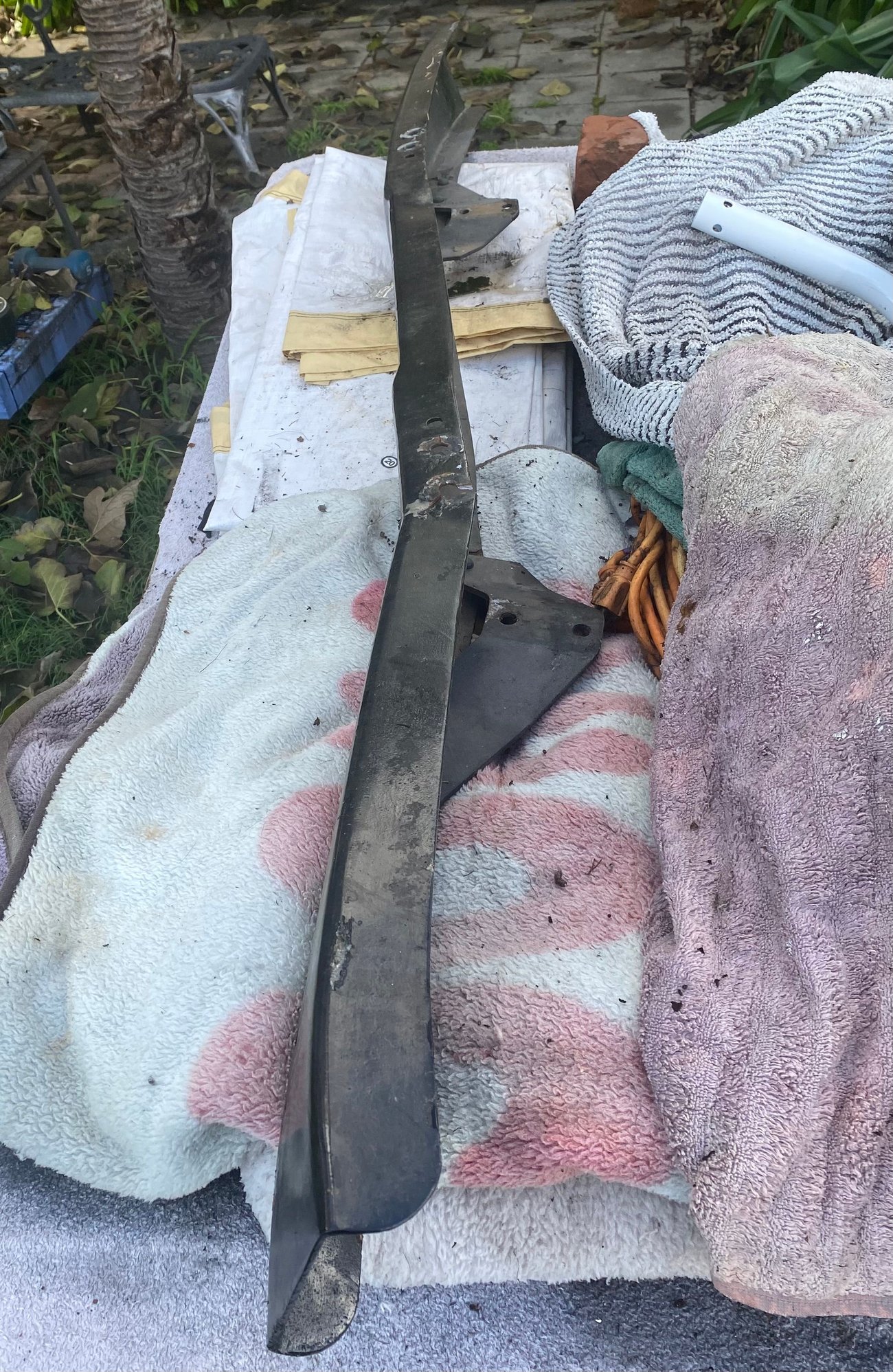

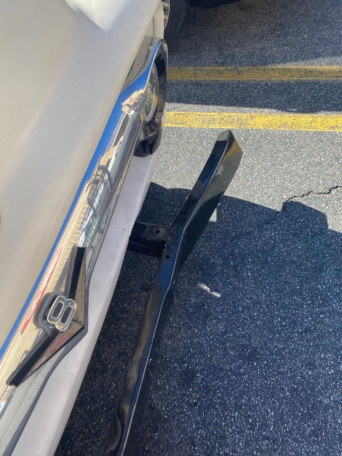

Hi folks. I took my truck for a quick run and stopped at a parking lot. I pulled in and up to one of those cement stops that sit in front of parking spots in parking lots. Like we all do all the time. When I pulled up, my front bumper went over it with no issue, no sounds.
However, when I came back, maybe my tires cooled, who knows, but my front bumper was stuck on the cement , specifically a hidden piece of rebar that just poked out from under it. So I could not back out! To be clear, I did not know about the rebar until after i finally backed up.

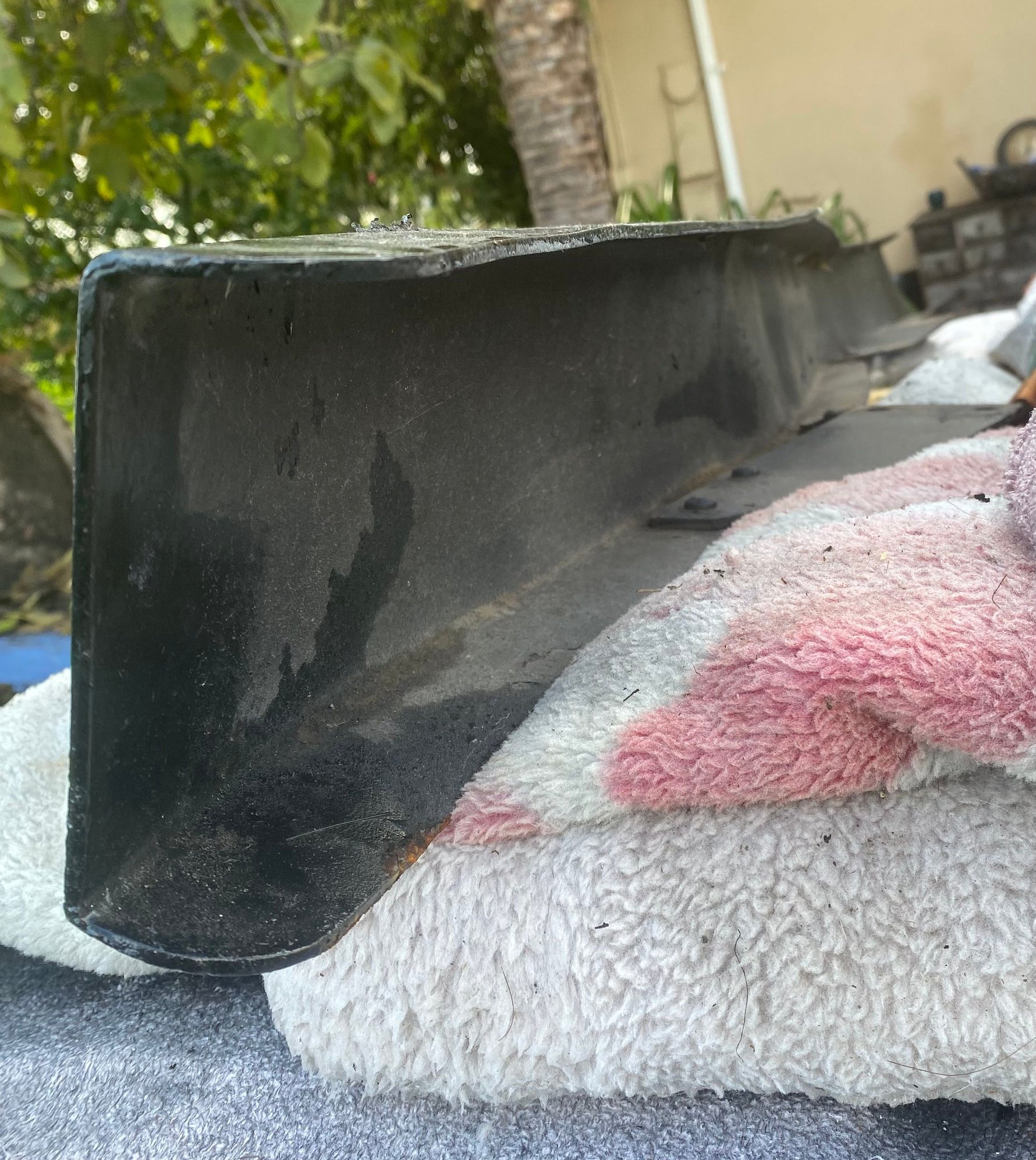

But I made the wrong decision and used more throttle. Well, it worked, but also bent my bumper! See the photos.
Any advice on this and how to straighten a front bumper back out? I’m thinking heat and force from a Jack. Or find a shop with a big press. And yes, it is now removed off the truck. I would not try and bend it while it’s on the truck, lol. I may just need to buy a replacement, but I’d prefer not to spend the cash.

That’s pretty bad. LMC Truck, $134. Plus shipping. Nice truck. You will spend more trying to straighten the old one.

All kidding aside, I have found that straightening a bumper will only have the result of making it look like it did before - by using way more time and effort and professional equipment than you'd expect to be needed. Whatever angle and amount of force that caused the damage has to be replicated in the exact opposite direction and force. That is very hard to do on a shop bench. Anything less and you will consciously notice a lessor effort. You won't help but notice the re-bend evidence and stretch marks.
You have a nice looking truck. And a glossy black simple stock-type bumper. Might be quicker and easier to hit up the catalog parts company and get a replacement. A little bit of filing down the rough edges and paint prep, some paint and clear coat and you'll be looking at your truck with pride again?

I agree with the others, in that you will probably never be happy with the straightened bumper.
But to get it close I would use a wood 4x4 or some other stiff working surface and several large C clamps. You can use shims and wedges to get pressure exactly where you want.

I agree that it would be tough to get it to look “right”. I see an LMC delivery in my future. I actually ordered one from a different company, then they canceled the order after 3 weeks saying no stock from manufacturer.

Mine got bent backwards, almost to touching the body. I took it to a bumper and powder-coating shop, who straightened it perfectly, sandblasted it, and powder-coated it for $150. The OEM bumpers are much heavier than the repro's, I'd at least try to save yours.

Like Ross said, it'd be worth hanging onto and messing with. You can buy a repop for now and mess with the bent one when you find some time
Do you have access to a press? Take your time, go slow and you can probably work a lot of it back out
