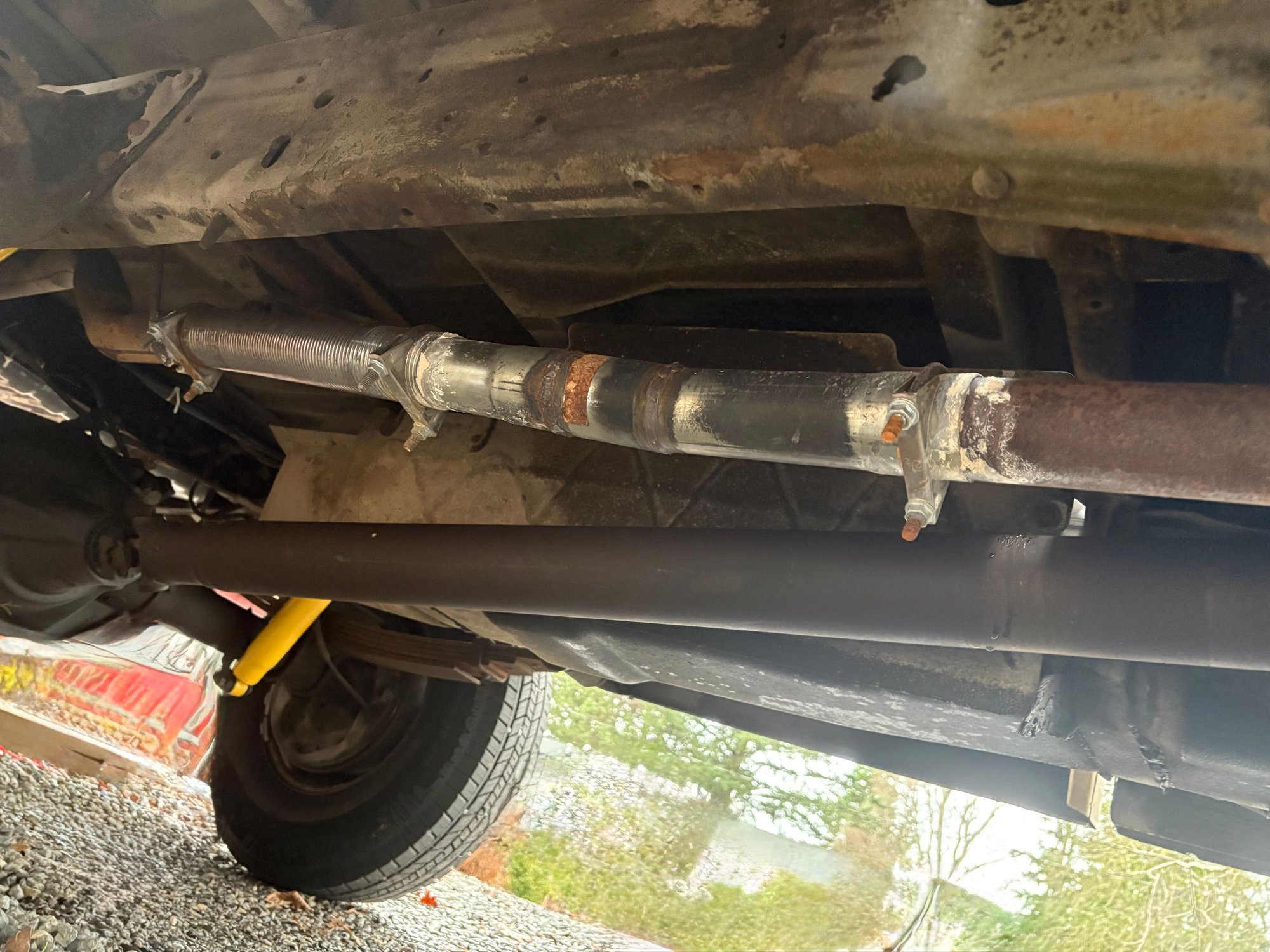

Old Jan 12, 2026 | 02:38 PM

Old Jan 12, 2026 | 04:10 PM
AuroraGirl's Avatar
AuroraGirl
Joined: Jun 2021
Posts: 5,221
Likes: 805
Originally Posted by Custom92
dude the tractor sound is what i want lol like an old ford. I know its backyard as hell but i tryed my best lol. ill try to get that tube fixed soon.
what the hell...
what is that flex pipe looking stuff?
Also, what is that white stuff on the right side of photo? Is the ends welded at all to the stock pipe?
I am pretty sure we are just dealing with exuast leaks at this point

Posts: 7
Originally Posted by AuroraGirl
what the hell...
hahaha lol im pretty sure it’s literally called “flex pipe” my welder is 220 so i don’t have a plug in to reach where the truck is located so i couldnt weld those joints, so were you see the clamps is where i couldn’t get the welder. the white is an exhaust sealer that i put on at the same time. And it ended up just falling off but stayed in the area in between the pipes. i had no clue what i was doing lol. The original muffler had a low side and a high sides so the flex pipe helped get it aligned. If it is just exhaust leaks making the noise then thanks for the knowledge i had no clue when it came to the exhaust system. I’ll figure out how to weld those joints that aren’t, and the tube going to the cat.
if you want to keep it a clamped setup, get a pipe made that mimics the center 3 pipes (flex, two solid pieces) then use Band clamps (I can help you find if needed,j ust give me the diameter of the original pipes) and then clamp it in with those and a bit of the exhaust copper spray

Originally Posted by 97-psd
So…. Let’s get the muffler delete sorted out first then see what kind of sounds you still hear. Any muffler shop should be able to sort that out for you without much cost.
ill weld it up i barrow a small welder from a buddy. the only reason its not welded is cus i have a welder that has a 220 plug and i couldn’t weld those joints
create a solid pipe for the flex portion, your exhaust is intended to move as one piece on all the hangers, now it will break the flex with time because the tail pipe is moving around separate
oh ok i can do that. i just took this video to give yall lil more info
