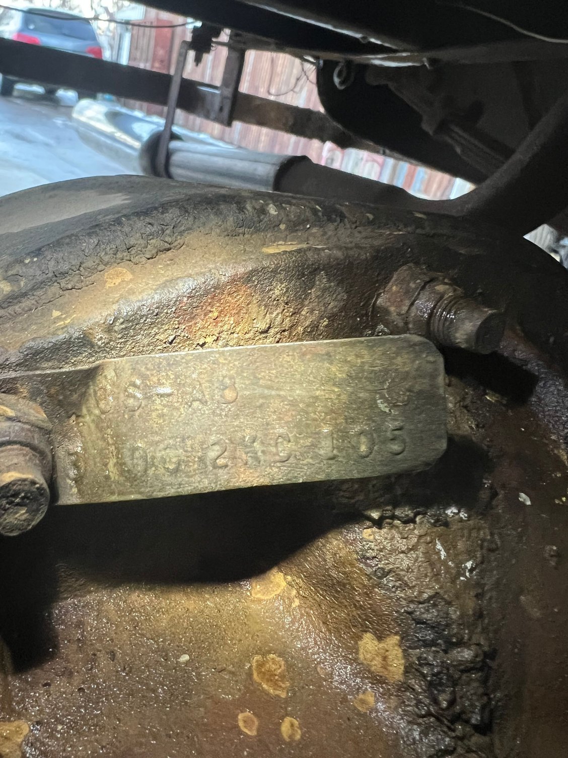

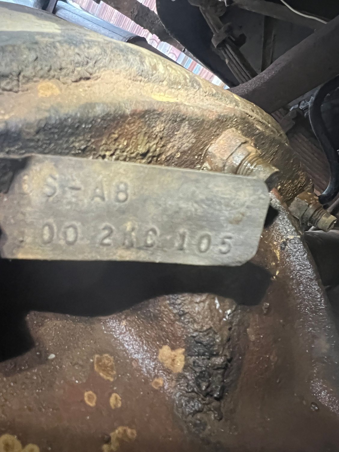

I recently bought a 1950 F1 that has already had some work done to it. It has a Buick 350 and auto tranny. It also appears to have a different rear end . I need help figuring out what it is so I can buy brakes for it. Looking at the tag on it , it looks like it says WBS AB ( or A8 ) But I can not find that code on the ID charts. Any idea what year it is and what it came from. It does state the gear ratio as 3.00. thanks

Looks like early 63 Ford passenger car 9", based on the tag numbers. You can tell more by looking at the axle bolt pattern, brake size, etc. Measure the brake shoes, diameter and width. Check the wheel bolt pattern on the axles. The more information you can provide, the better the answers we can give back.

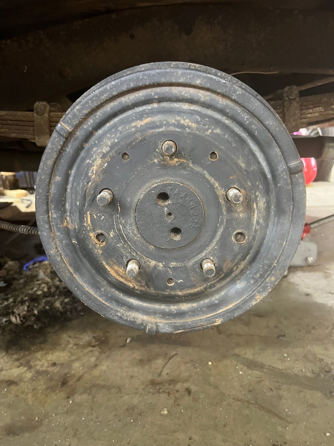

I’ve looked over that list and can not find one that matches . Maybe I’m missing something . The bolt pattern on the axle is a 5x5 1/2. The brake drum is 11 inches inside diameter. The brake shoes are 1 3/4 inches wide . Any more info I can provide ?

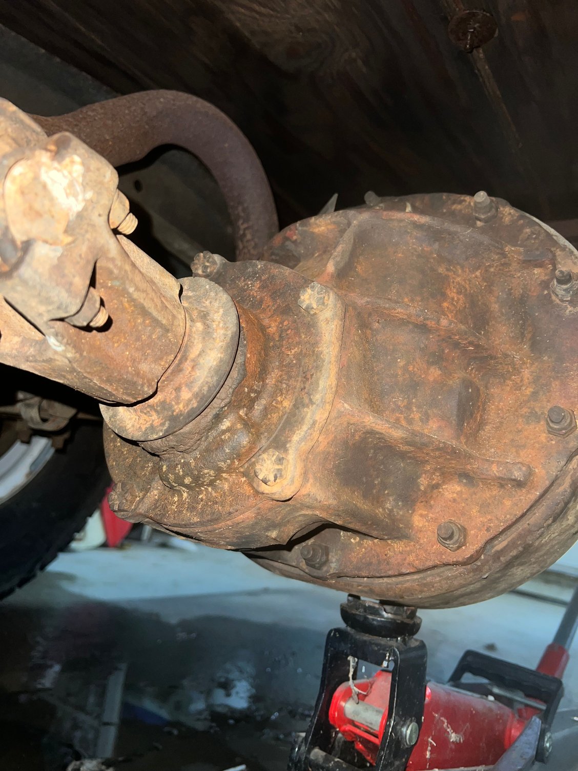

Based on the brakes and the axles and bolt pattern, there's no doubt it's an F-100 truck axle. Early 60's most likely. There's no self adjuster cable. What does the back side of the pumpkin look like? Is it smooth or does it have the familiar hump? That got changed in about 64. Ford used the 11x1 3/4 brakes for many years. Pick a year and tell the parts guy that's what you need. As long as you get the same size shoes and can turn your drums, you're golden.

The pumpkin is smooth on the backside .

I'm going to go out on a limb here and say, based on the information given, the AB suffix is for 63 F100 3.00 9" axle, and that's what you've got. Everything else adds up. It's just not listed in the chart. The 2KC date code would place it at 1962 October, 3rd week. 1963 model year production would have started a couple months earlier, at least.
