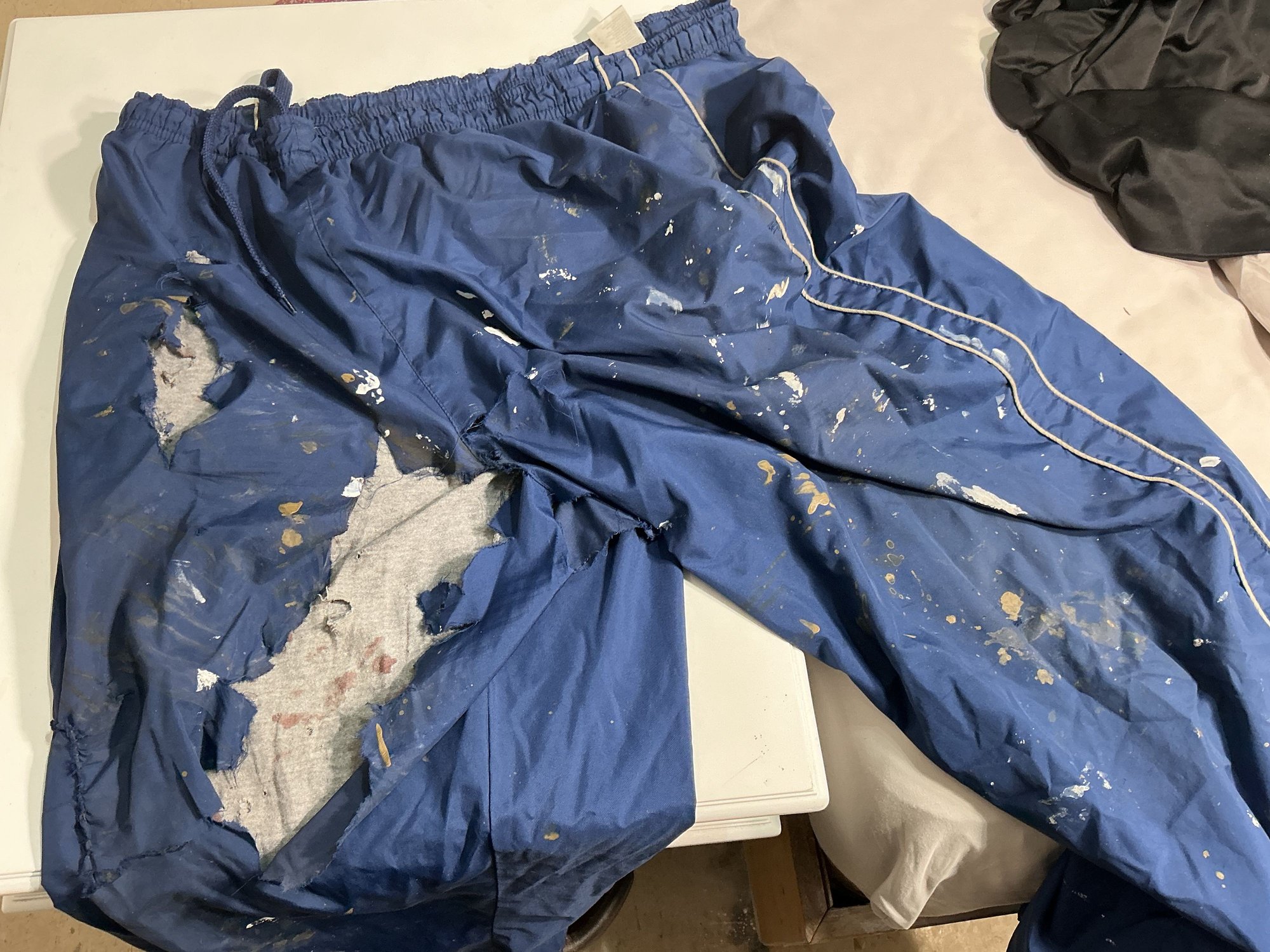

For beginners out there, do not use cheap cut off discs. Their edges fray and will catch an edge throwing the grinder uncontrollably. I was lucky. Going with Makita for the time being…

Lucky. Didn’t realize how lucky until I sat down and thought about it. You would not believe how uncontrollable that kickback was. Coming over the top of 1/8” angle iron to go down the other side like always and that disc caught and kicked back into my leg and dug into some athletic pants I had on and would not stop. The grinder was switched, not a paddle. Had to reach over and unplug it from the wall. Thought it was just a freak accident, felt the blood dripping down my leg, was afraid to look at it, but wanted to finish up. Put in new Black & Decker disc and IT DID IT AGAIN. Thats why I have two grabs on the leg. I felt it was the discs, might have been less then perfect technique but have made that cut before. Threw away 15 or so Black & Decker discs had laying around and got some Makita cutting discs and grinding discs. Look a whole lot better.
Edit: I know, some damn good looking legs..

Additionally, wear the proper PPE and not "athletic pants" when working with power tools that can bite.

Another vote for better clothes, although I doubt most people would wear leather, and jeans while sturdier aren't going to slow a grinder down much.
Speaking of PPE, is there a guard on your grinder? and what style? I know at least one of my Dewalt grinders came with 2 guards, a general purpose one, and a more enclosed one thats meant for use with cut-off wheels. It may not have made a difference if the wheel caught and jumped, but it will contain shrapnel better if the wheel explodes.
I do know a lot of people that just remove the guards and toss them because they "get in the way" I'm not one of those people, but I'll admit to never using the special cutoff wheel one. Using two hands with the side handle will also greatly increase safety and precision when using a grinder. That being said, you can't always do that, and still a chance it runs away if you're in the process of putting it down with one hand.
I don't know how many corded grinders have added safety features, but the newer cordless ones do have electric brakes and some circuitry to help. I know the 20V Dewalt one had some sort of anti kickback feature, and it has worked a couple times when I've been using it.
All that being said, I did get a gnarly scrape on the back of my hand one time when a wirewheel caught and jumped at me. I've also had a wirewheel get caught up in my pants/sweathshirt when it got too close. Be careful out there!

Have to reassess the whole operation, this could have been really bad. Thought good common sense would keep me out of trouble, this proved otherwise. Certain practices and techniques have to be followed, an angle grinder is in a class by itself. Just don’t want to become self conscious though, hate that, just got to go with it. Got the grinder on a deal used, did not come with a handle or guard. Have to try and find a guard for it (Metabo, later found out it is am Hitachi with a Metabo name on it) because proper technique is having sparks flowing at you to get rotation right so kickbacks go forward not into you. Do you really believe a handle can make it possible to control a kickback that violent that I experienced? Got some Walter ceramic discs coming, that might help. I am only using top of the line discs from now on, though my technique may have played a part.
Thanks
mjac
My favorite pants:
