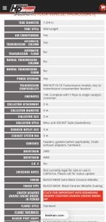

The notes state that it because of the crossmember
I went to Hedman’s website. There are several that might fit but I don’t have enough information about your truck to narrow down the options.

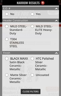

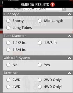

Originally Posted by silverfox17
My4Fordtrucks, if you're referring to A.I.R. etc., there is no smog system but currently is an EGR
and there are also these things
