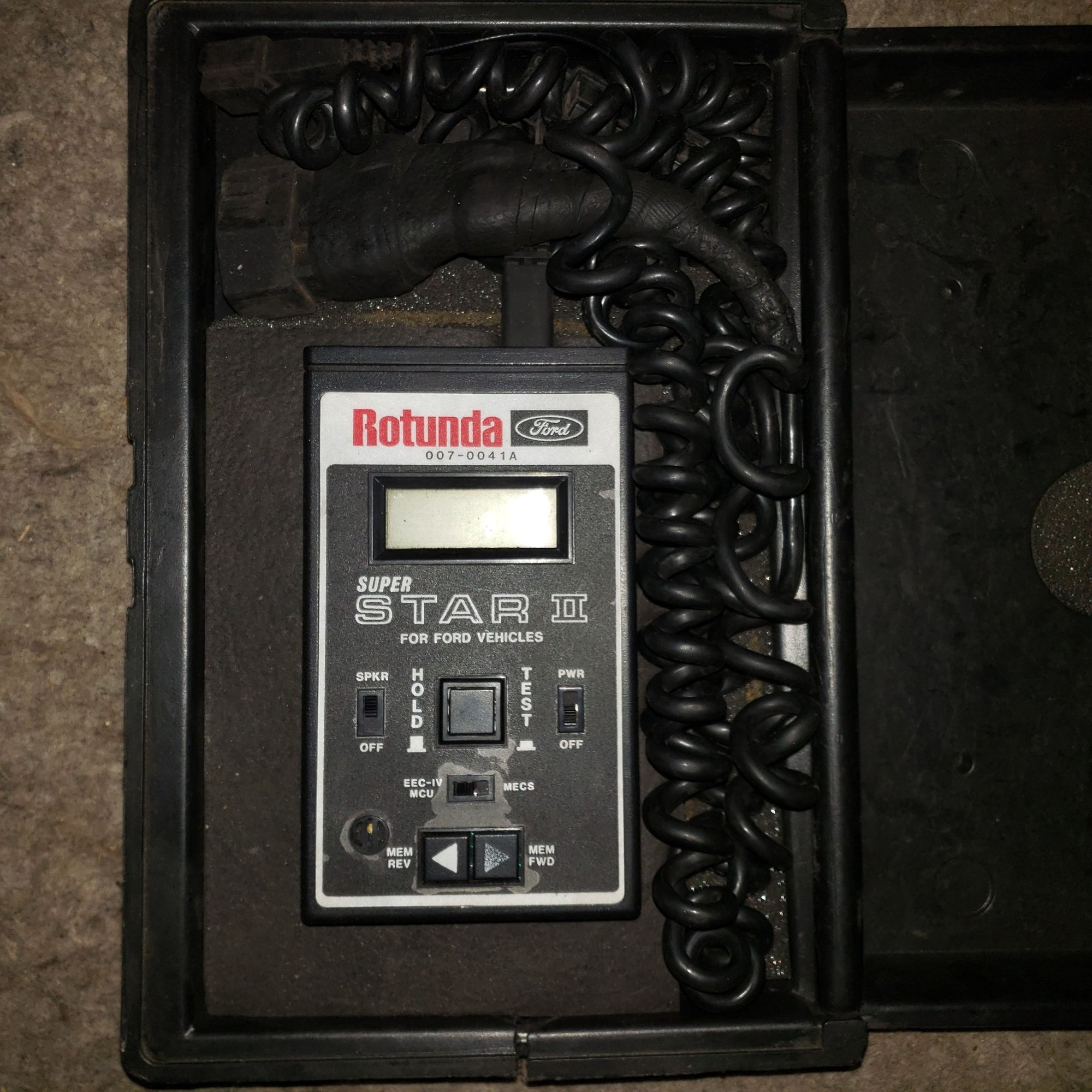

The Ford scan tool in 1989 was a Super Star 2

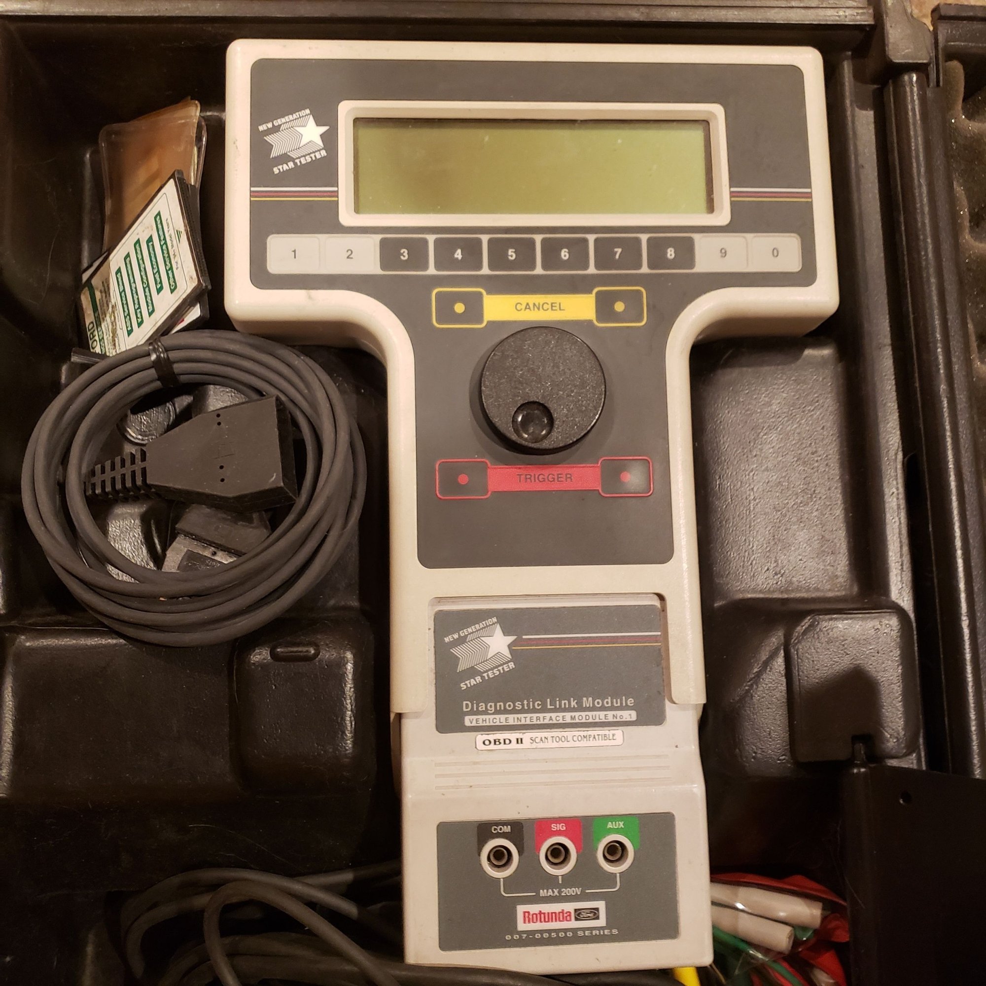

Here's my NGS
The dealer bought 6 of them and I ended with mine because they sold the company
These were 5500 when we bought these

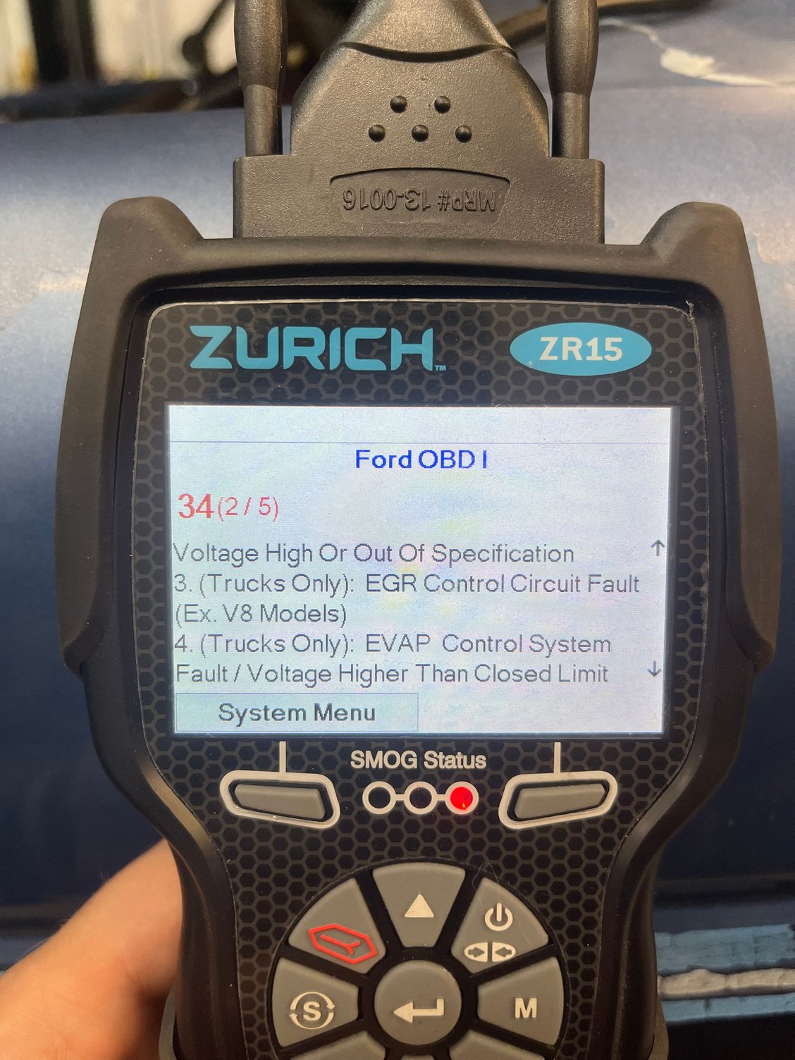

I purchased the Harbor Freight Zurich ZR 15 OBD2 readers which is made by Innova.
I never mentioned that it could read OBD1 codes but the Innova ones did. So I bought the OBD1 adapter from Innova and it works just fine for reading the codes.
