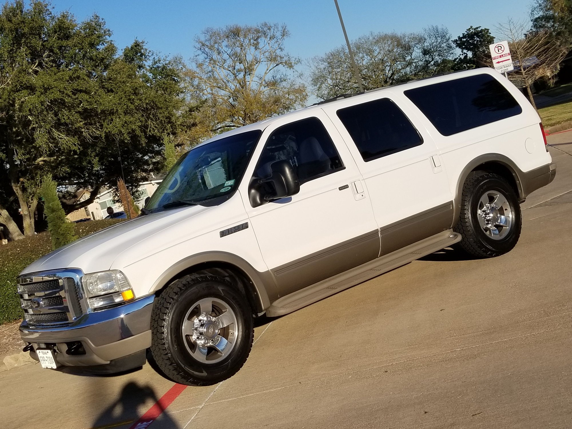

I run a 275/70/18 on stock 2004 18x9 wheels on the wife's 2wd Excursion and there's plenty of clearance. These tires are .7" taller and .4" wider than the 265/60/20 you're looking at. The key will be in the wheels offset, and I'm not sure what stock is. I like the wheel/tire setup on it as it fills up more of the fender well.

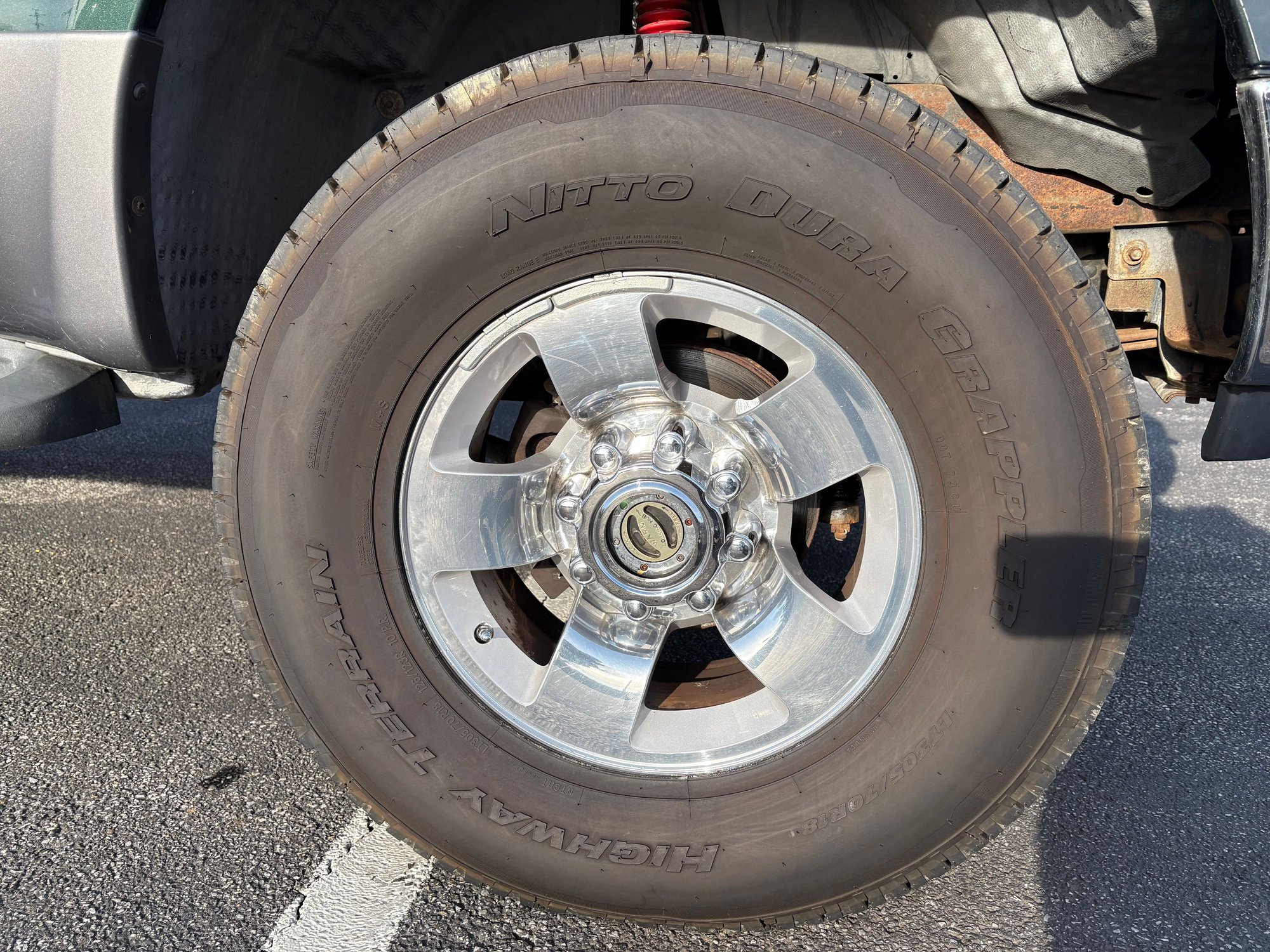

Can I see a picture of the rims you have? Just curious. Ill assume for a 2004 F250/350 Harley Davidson edition 18" wheel?

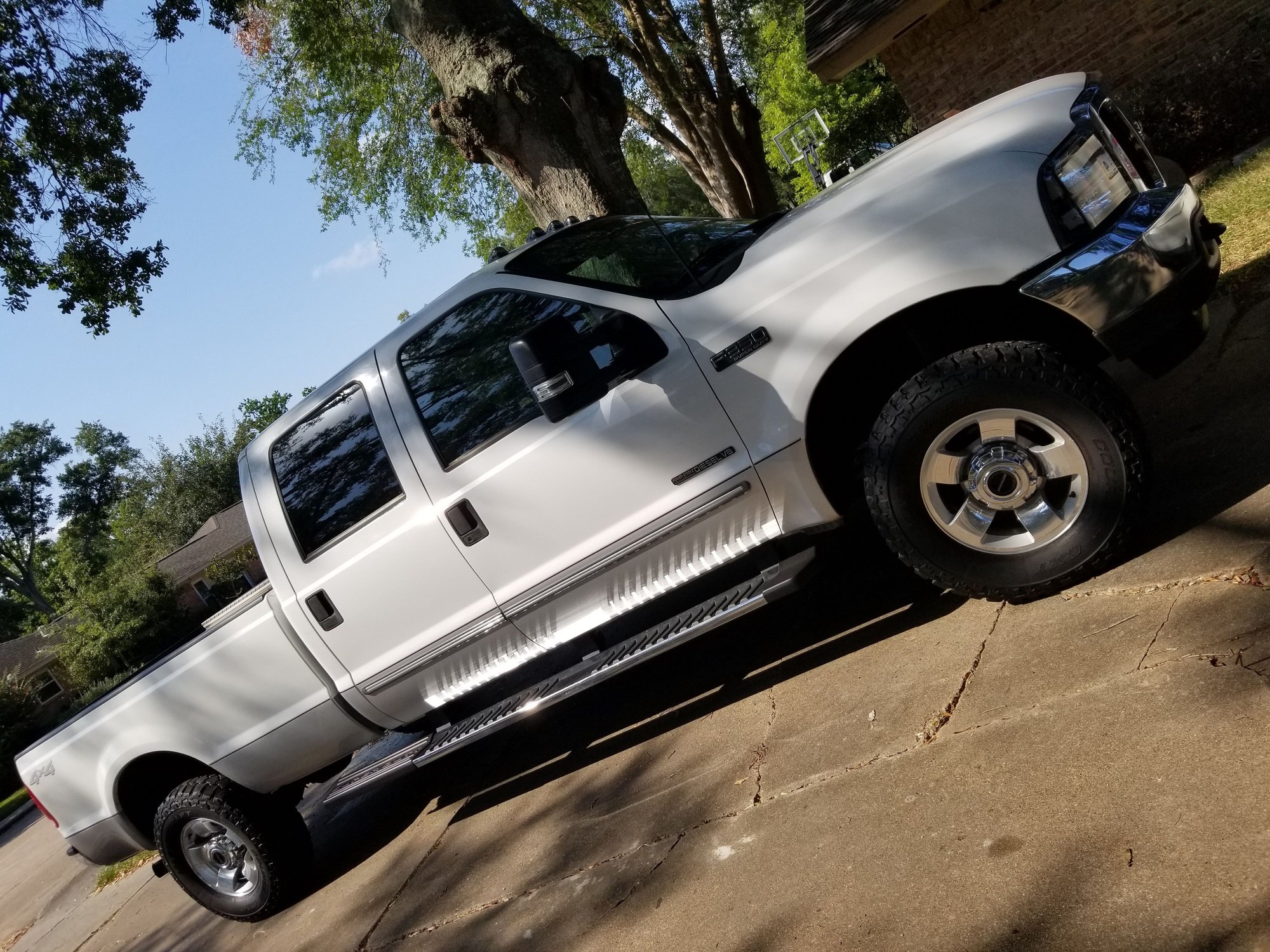

There's those, the King Ranch, and Lariat editions...there's another Ford SVO?, but the chances of finding those are rare. However, they're all going to be 18"x9" factory offset wheels. I have the King Ranch editions on the wife's Excursion and the Lariat editions on my F350...

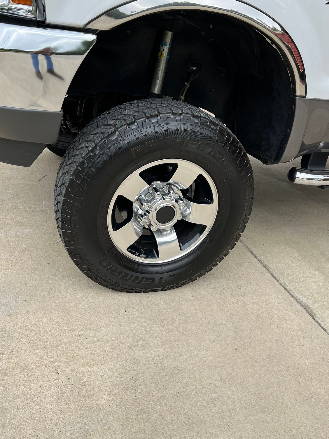

Here you go

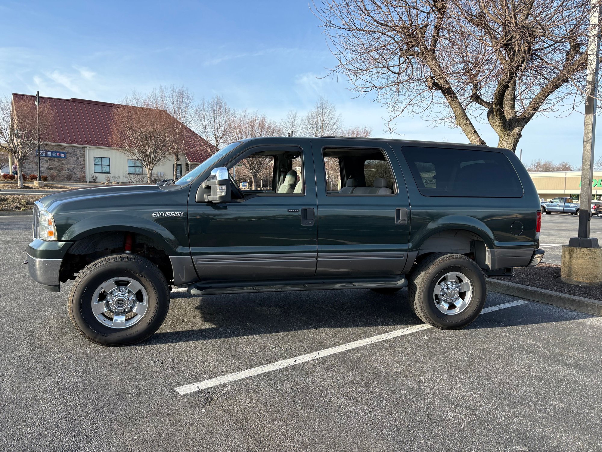

And here are the ‘04 Lariat 18”X8” wheels with 305/70R18s (35.25”X12.8”) tires.

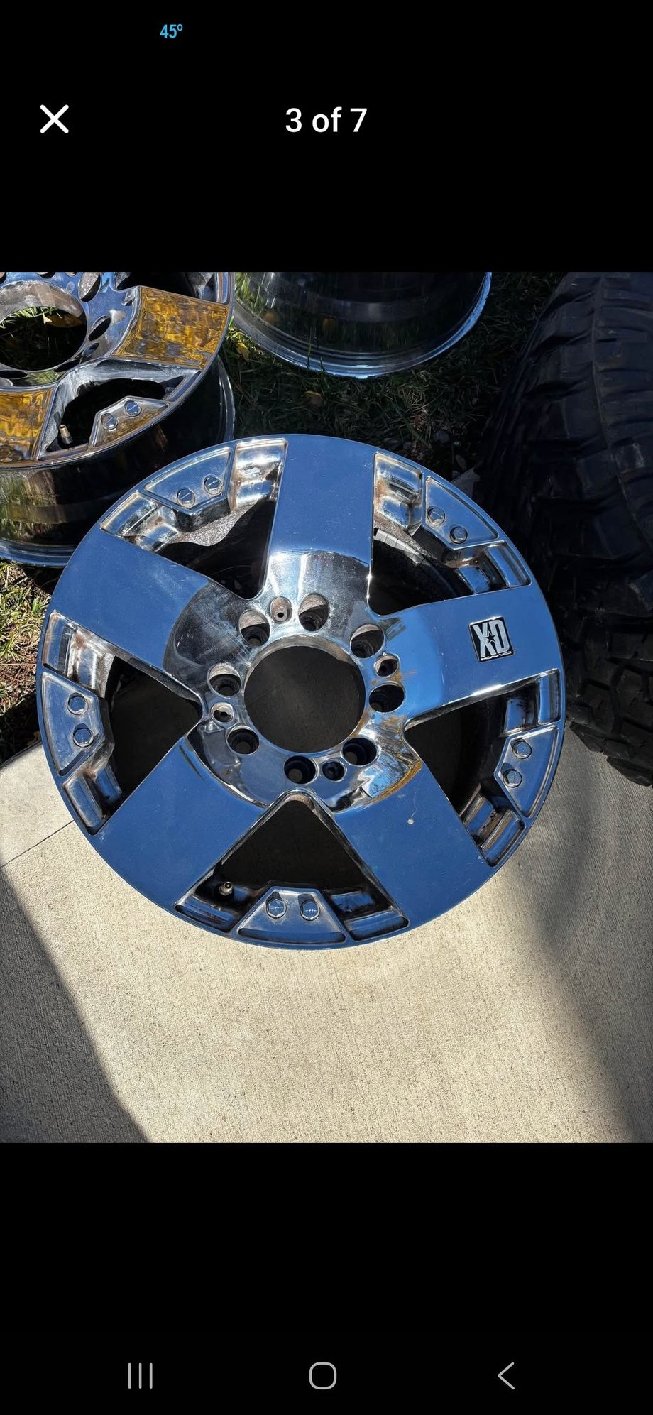

Whoever is was sold those XD wheels, looking at these now... 2017 King Ranch wheels. 20" with stock Cooper tires that are 275/65/20 I think? Our stocks have a 12mm offset and those are 40mm offset. The guy had them on a 2007 F250 and said they didnt rub.
