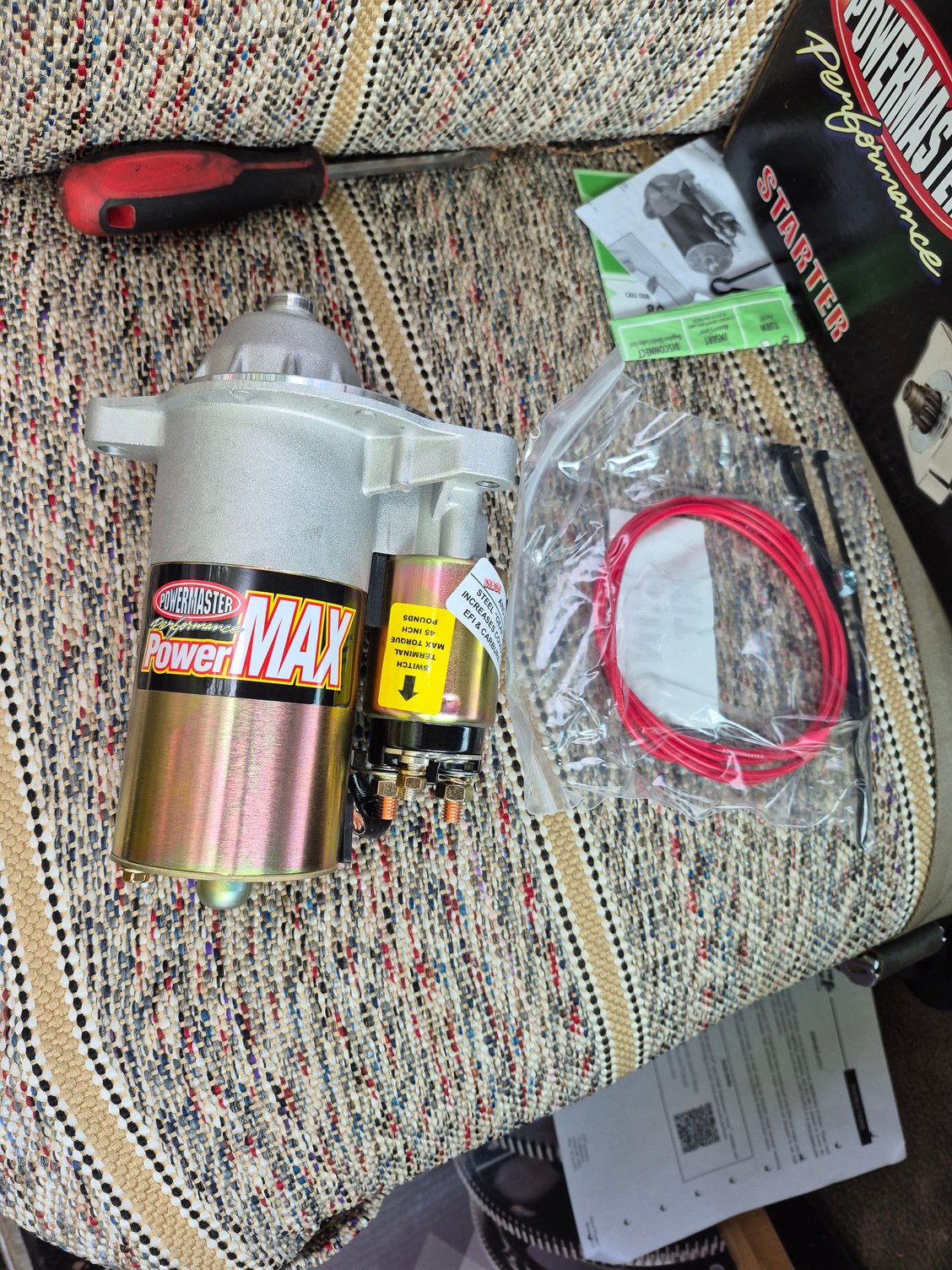

I've had a Power Master starter on here for the last 18 months.
This one.
Granted its not that clean anymore, but was working just fine until the flexplate gave up the ghost. And it's the one that went back on, except for when I tried the factory style and yes I did put the wiring back to factory for that one.
