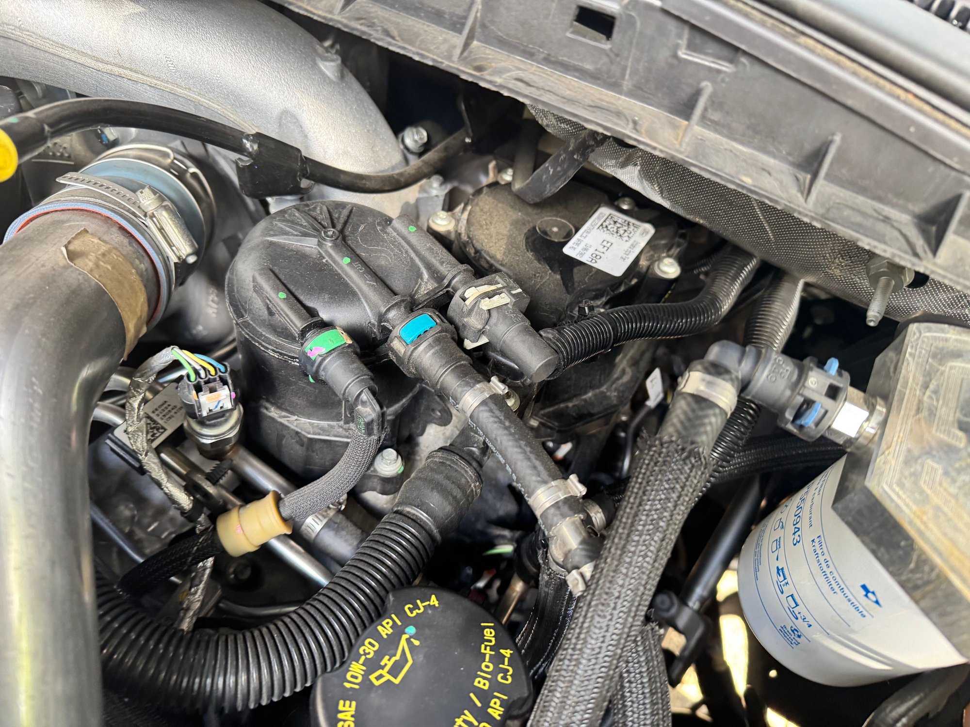

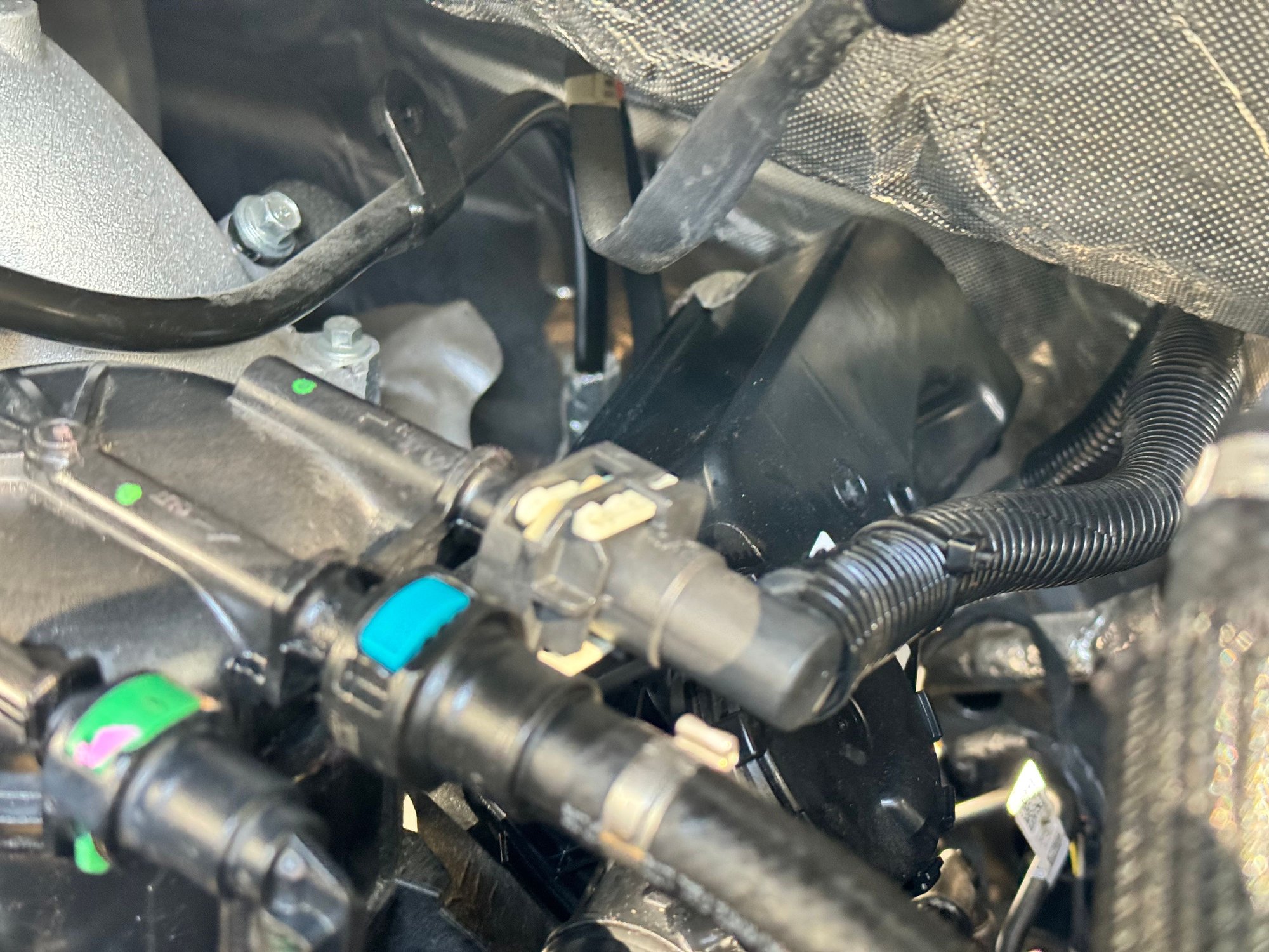

Yes it has one. I changed mine out this past summer and will most likely be rerouting it to atmosphere next summer. For now I installed the newest 2023+ model. It’s not to bad to do but those back 2 bolts take a bit of work to get them out without dropping them. You can see the CCV in the following picture. Towards the top with the big white sticker.
The original. Top center with big white sticker.
Old on bottom, new on top. The new one is smaller and easier to get around!
The new one installed.
