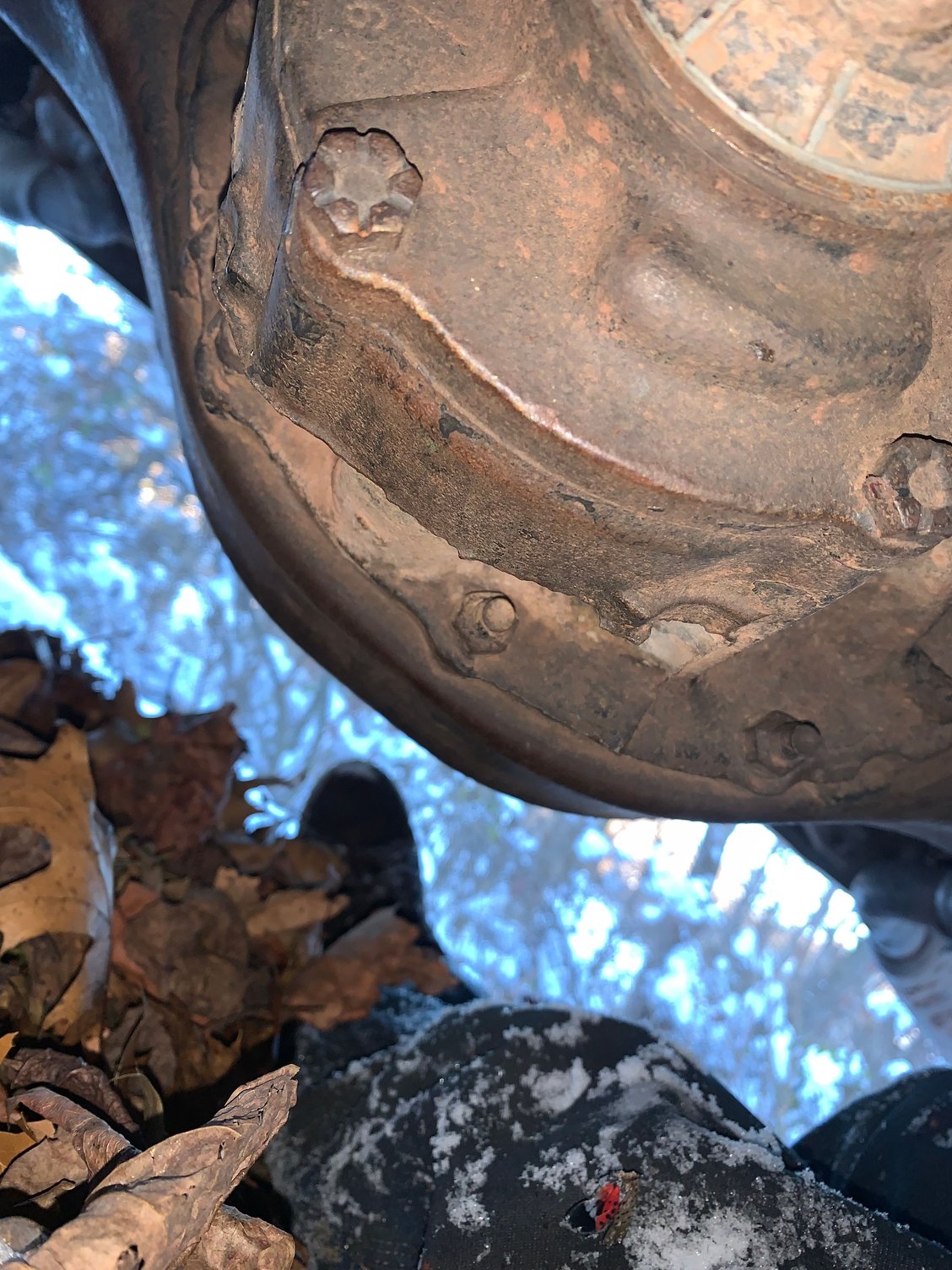

What rear axle am I looking at? 1986 ford f150 5.0 srod

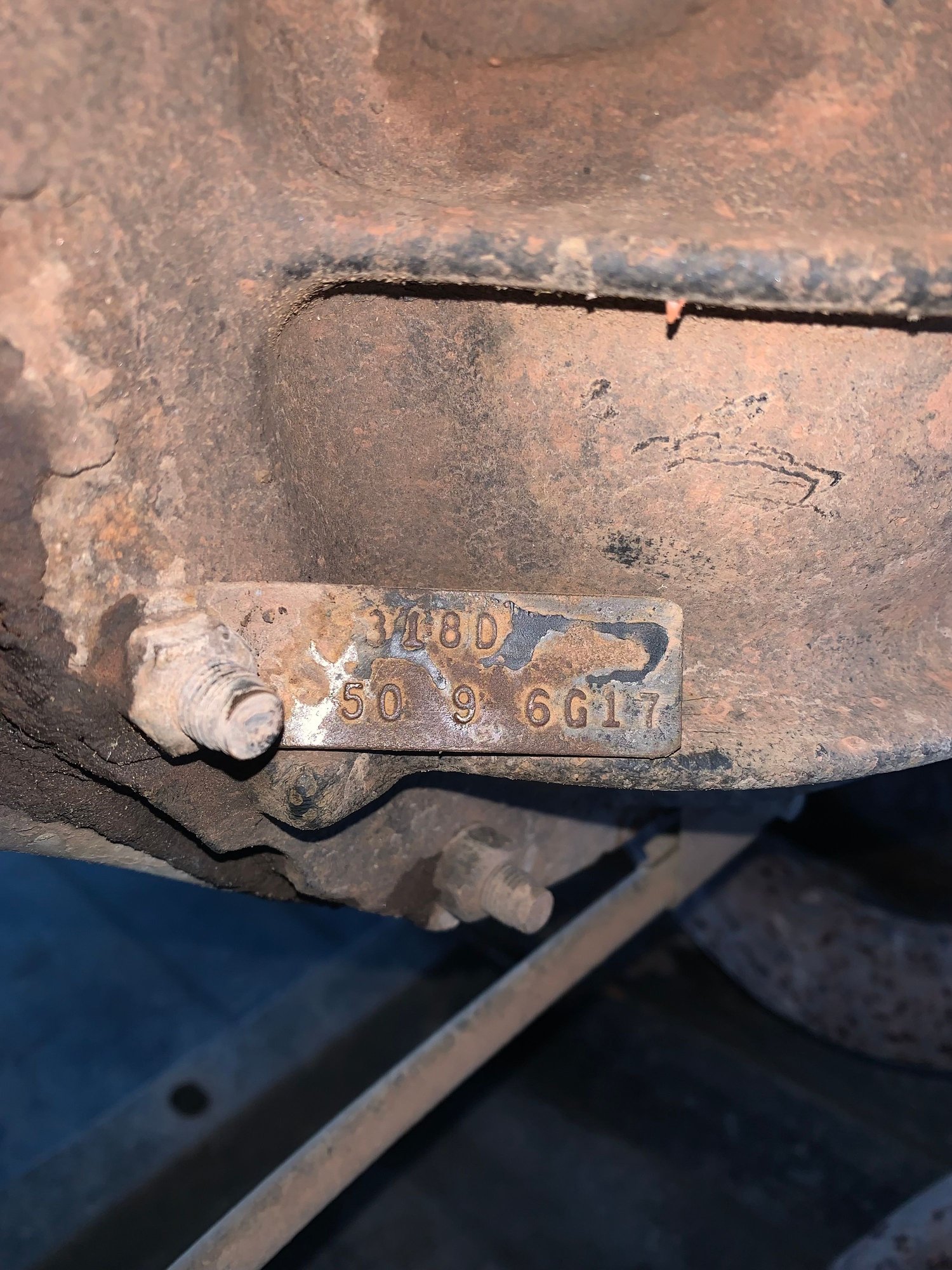

It would have been nice to take a wire brush to the tag so we could read it and a picture a little farther away to tell what model, but I think it would be a 8.8 by that time.
Also a picture of the door sticker as that would tell us the model and ratio when we look it up.

it says
318 D
50 9 6G17

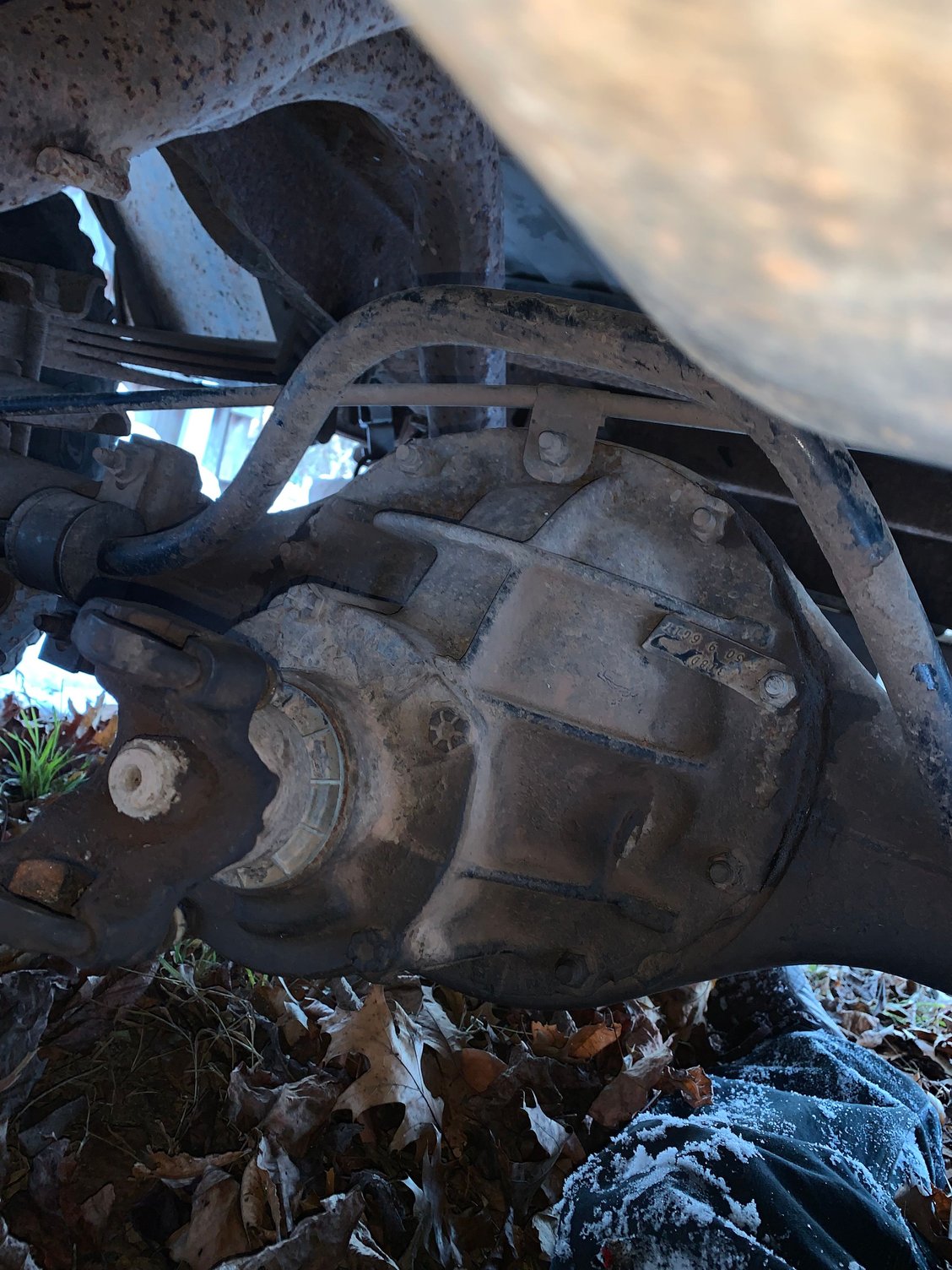

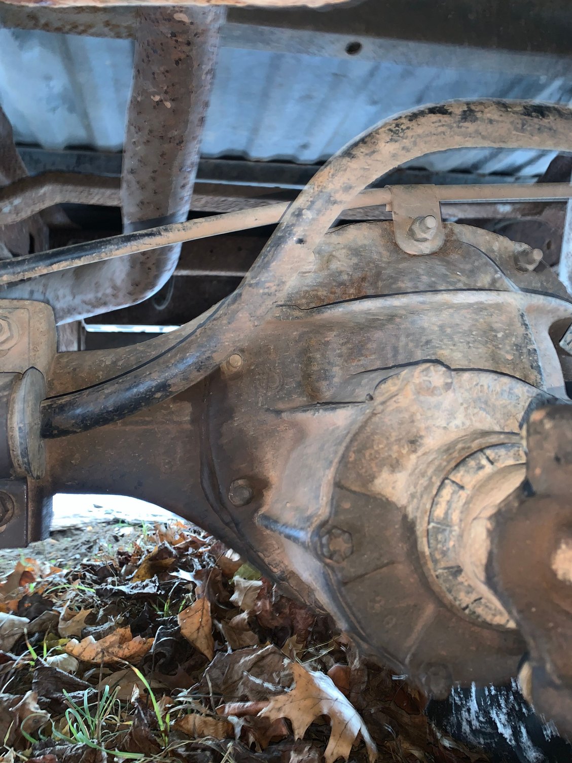

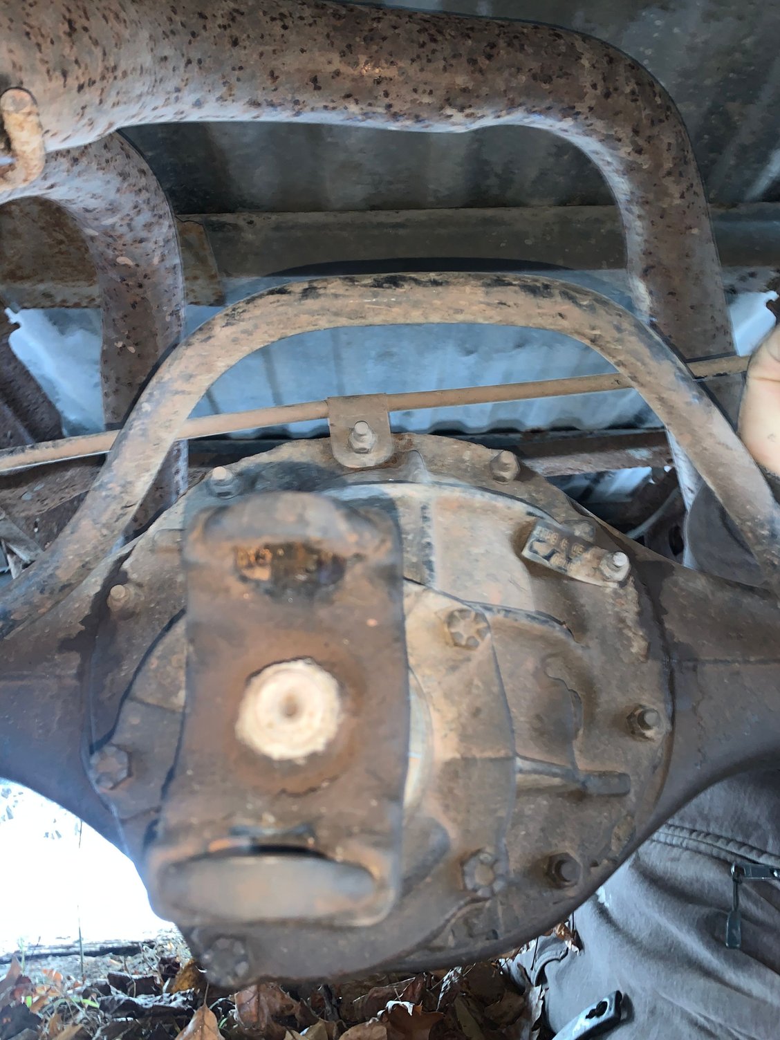

and here are some more pictures

3.50 to 1, 9 inch Ford rearend.

9 inch. That's a great piece. Take care of it.
