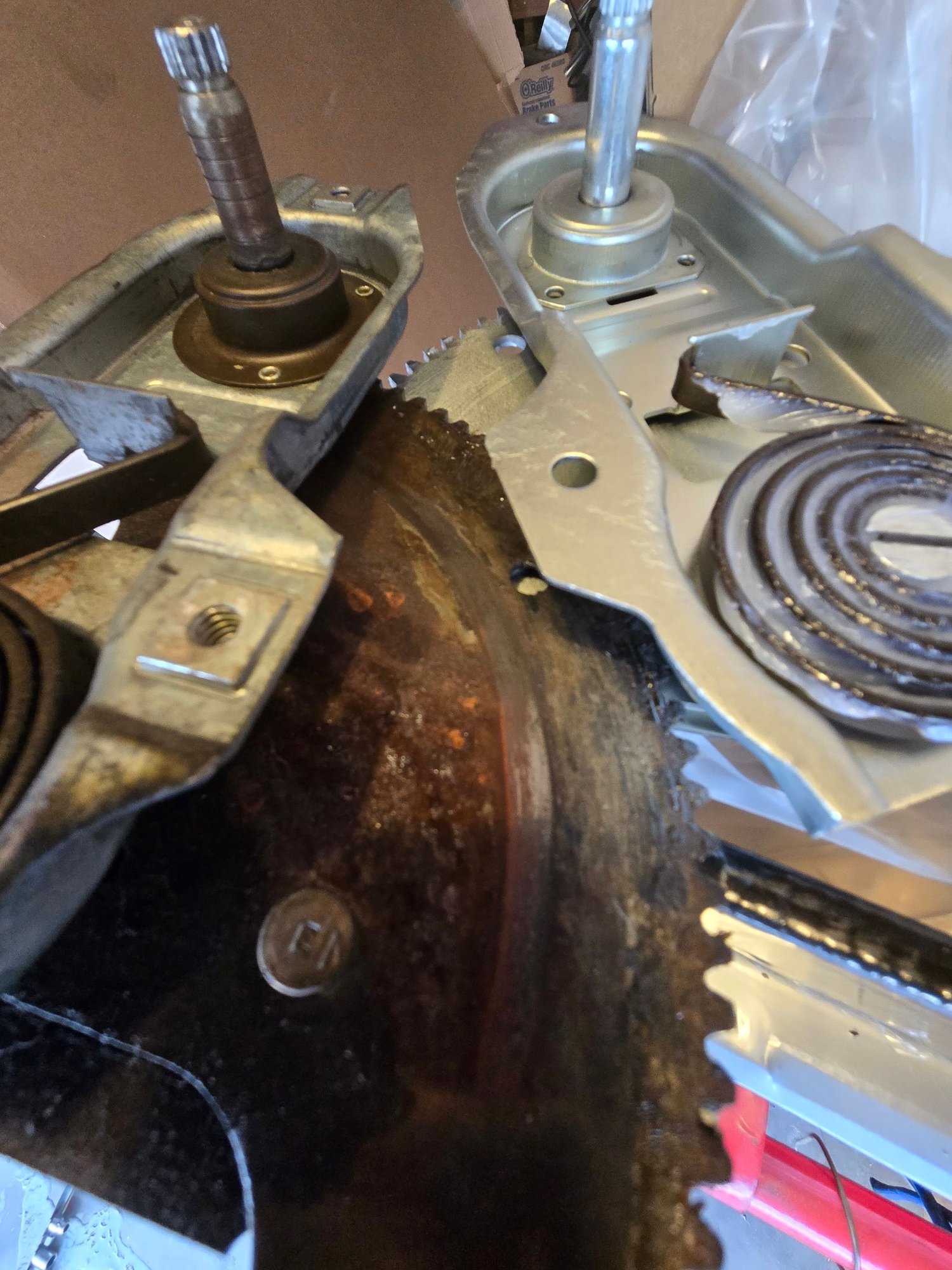

Hey, I wanted to ask you guys. Pls look at these photos. The oe window crank mechanism has three countersunk nuts. The aftermarket ones need fender clip. I'm not sure the proper name of those clips. That means that the mechanism will sit back about 1/8". Do you think that is a problem?

I think you'll be fine, there's some room between window crank and door panel.

Dorman clip nuts https://www.oreillyauto.com/detail/c...t/dor0/961325d
Clip On Nut. https://parts.cat.com/en/foleyequipm...UaApe1EALw_wcB
U-Nut clip plate. https://www.stockcarsteel.com/U-Nut-...ad?quantity=25
Clipnuts lol https://catalog.monroeaerospace.com/...ies/clipnuts-1
https://spenceraircraft.com/hardware...clip-nuts.html
Rivetless Nutplate https://www.clickbond.com/products/nutplates
That 1/8" set back will (maybe ?) "shorten" the shaft length sticking out the door panel for the window crank to attach, right? I have seen some window regulators riveted in place and some bolted in place. So not sure and never measured if the mounting way makes a difference.
