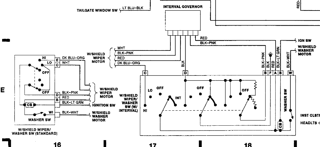

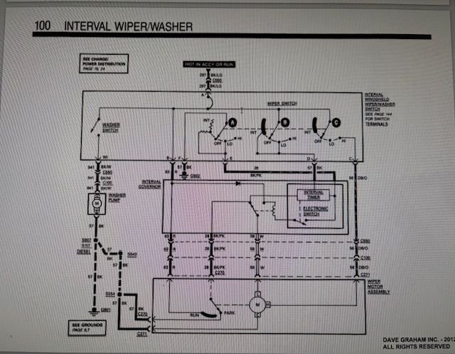

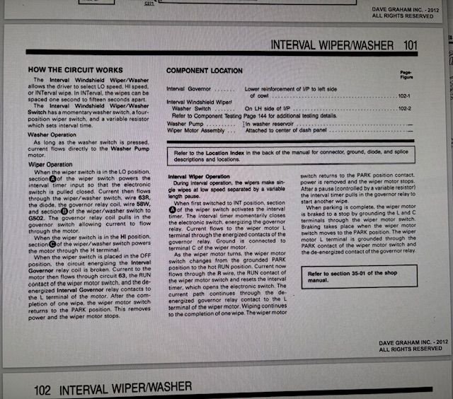

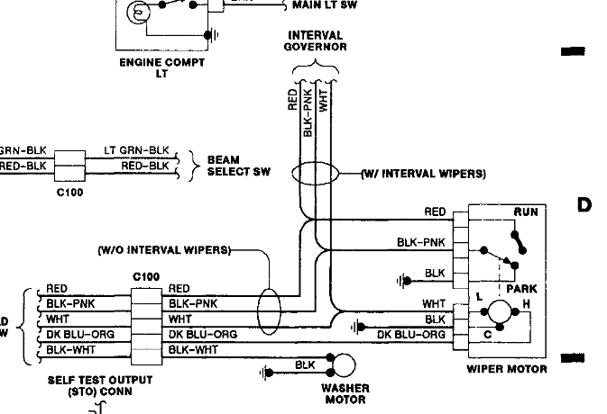

Hey guys, thanks for all of your help! I really appreciate it! Been a busy weekend, and really trying to get the u joints finished up in my other truck, so my wheeler's gotten bumped back on the priority...
thanks for posting up the schematic, but I'm not good with electrical at all, so tbh I can't make heads or tails of it unfortunately. I'll try to get back out and retest which conecter had powere all the time and which one didn't tomorrow.
