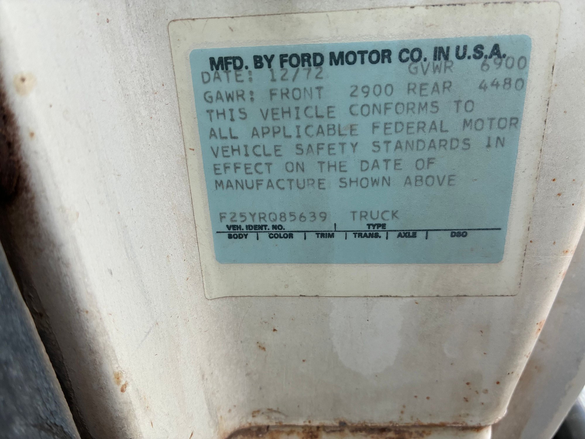

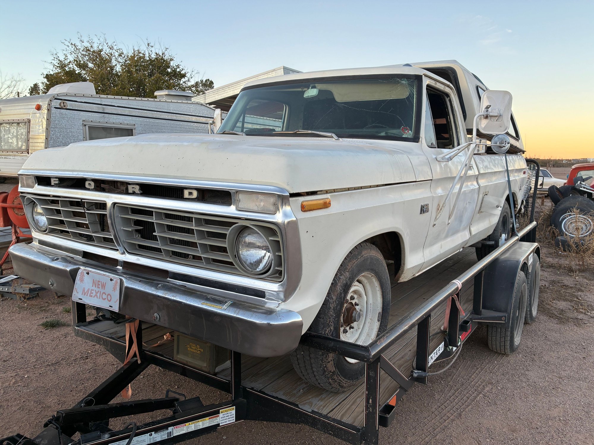

I bought this “1972” f250 no title truck. However , to me it looks like a 73-78 model. I am applying for bonded title .. should in apply for 1972 title or 1973 title ? The state will give me a title with either year… I just want to make sure my new title matches the corrrect ….

Looks like a 73 to me.

I've got one that was manufactured a couple months before yours in October of 72 that is a 73 model year. Title says 73 as well.

That VIN on the tag is for a 73. Check the VIN on the frame to see if they match.
F25 -73/ F250 2W/D
Y- 360 2
R- San Jose plant
Q85639 - 1973
Old Dec 10, 2025 | 10:35 AM
m78's Avatar
m78
Joined: Apr 2007
Posts: 615
Likes: 93
"Q85639" in the VIN says its '73

DMV ran vin and numbers...built and assembled in 1972 in a Ford plant once located in California it was sold as a 1973 model...so yes, it is a 1973 Model. This truck has lived a Southwestern life and it shows! Thank you all!
