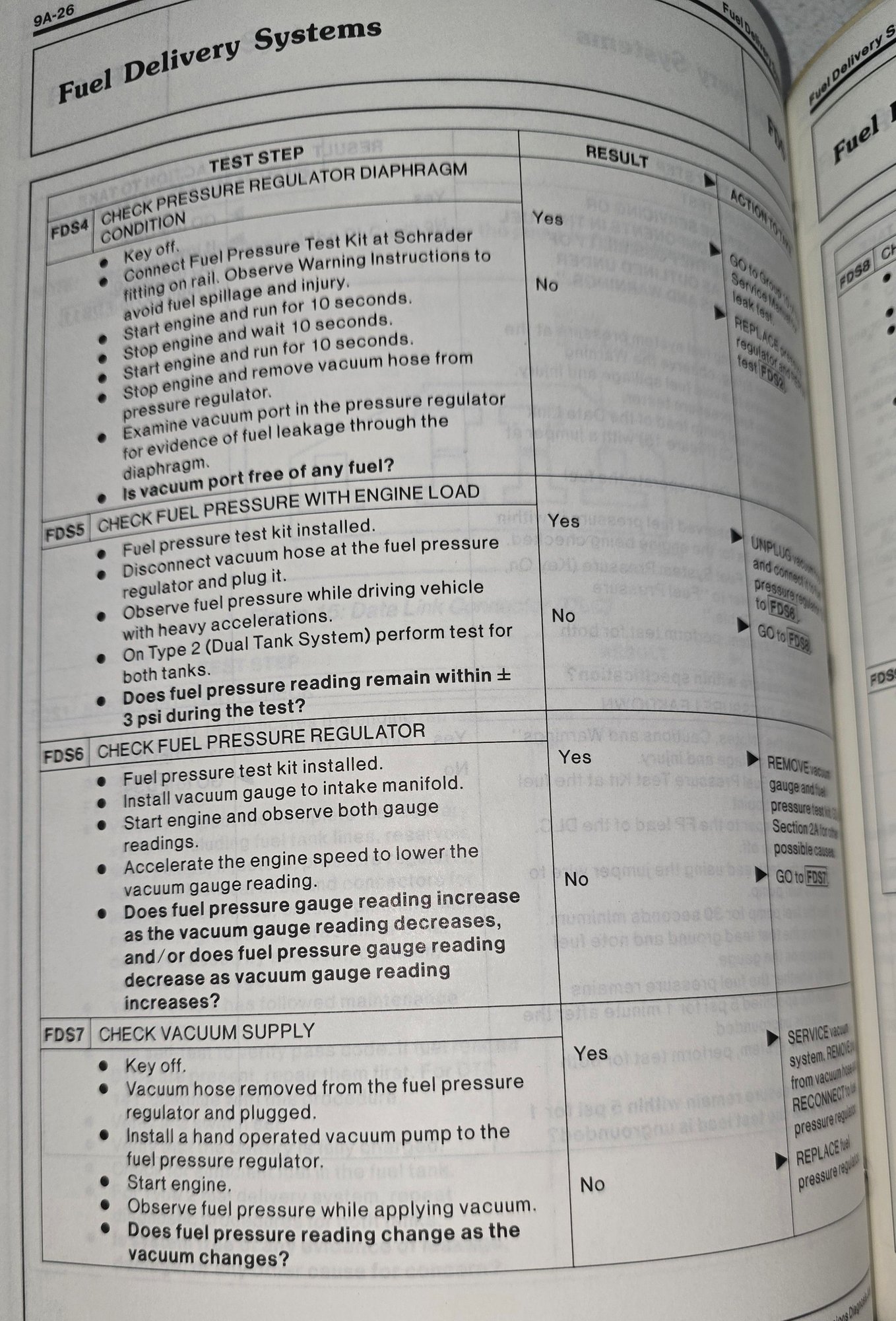

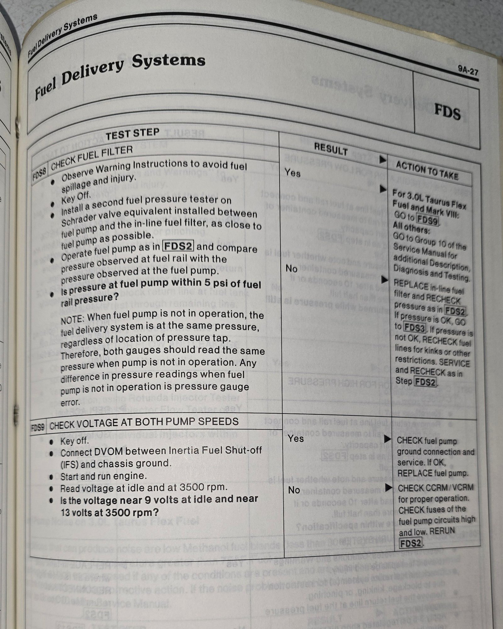

These are the regulator tests out of the PCED (pinpoint test FDS6 in particular)
All of you interested should read every page, including the flex fuel stuff
It's just a matter of time before we all need to bone up on flex fuel
Been there and done some of that already with thousand dollar Taurus flex fuel pumps
The injector color and pounds per hour chart is good if hitting a junkyard for injectors
