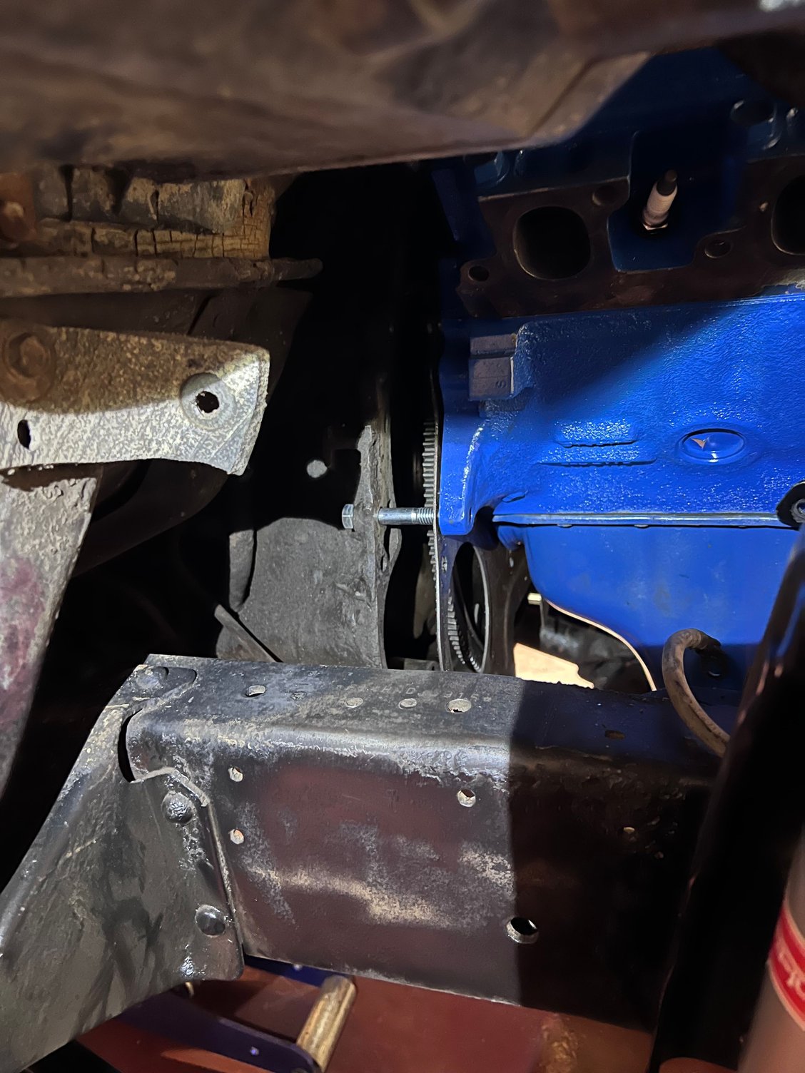

After MANY colorful words and phrases I've gotten the new engine bolted onto the perches.
I ended up having to disconnect the trans crossmember at the frame, drop the driveshaft and using ratchet straps to evenly pull the transmission back about three inches.
Engine with motor mounts settled perfectly onto the perches.
Using the ratchet straps in the opposite direction helped pull the trans back into proper place- this was surprisingly easy, under 10 minutes, to put into the correct alignment and bolt down.
Flex plate was aligned to TC(drain plug as well), Bellhousing was fully attached to the block and then flex plate to torque converter nuts were attached; this ensures I didn't pull the TC out of its correct mated position.

Part 2: I'm an IDIOT
2 short days after enjoying my small victory of getting the engine finally settled and mated up to the transmission I've discovered I'm an idiot.
I've been slowly finishing off the engine assembly- exhaust, fuel lines, alt, etc etc etc. On target for initial start Tuesday night or Wednesday am
Today I came upon a part that should have already been installed- the worst part possible: the spacer plate that goes on the block behind the flex plate...................
I had seen it all along sitting there but had a mental block that it was the inspection cover for the bell housing- Nope!
Since the engine is mostly complete at this point I've decided to attack the opposite end and pull the transmission back.
Hoping I can just unbolt it and pull it back 4-5 inches enough to remove the flex plate and slip in the spacer plate.
I really don't want to totally remove the trans or to undo all the recent engine assembly progress.
Anyone ever done a flex plate R&R differently or am wasting my time trying this approach.
Thoughts/comments appreciated.

bummer. that plate gets sandwiched between the block and the flex plate. Those bolts need to be torqued to spec in a specific pattern and w/ thread sealant as I believe they go into the oil passages, at least on a SBF. That block off plate also has the hole for your starter to mount to. Probably best to take the engine out and do it correctly. You have the front clip off already, so should be too much of an issue getting it out and in again.

Thanks guys for the positive thoughts. Only those who have stepped into the "dumb sh-- line" can appreciate that feeling when you find that missed part just hanging around....
Front clip has been on for this entire job, only hood is removed.
I decided to de-install and lift engine as opposed to pulling the transmission.
Got it all done except the torquing of flex plate bolts 80 ft-lbs this morning in under 90 minutes.
My current issue is I'm a one(old) man deal and I need a bit of help locking down the crankshaft while torquing the bolts.
No buddies around today to keep going....everyone is hunting.
