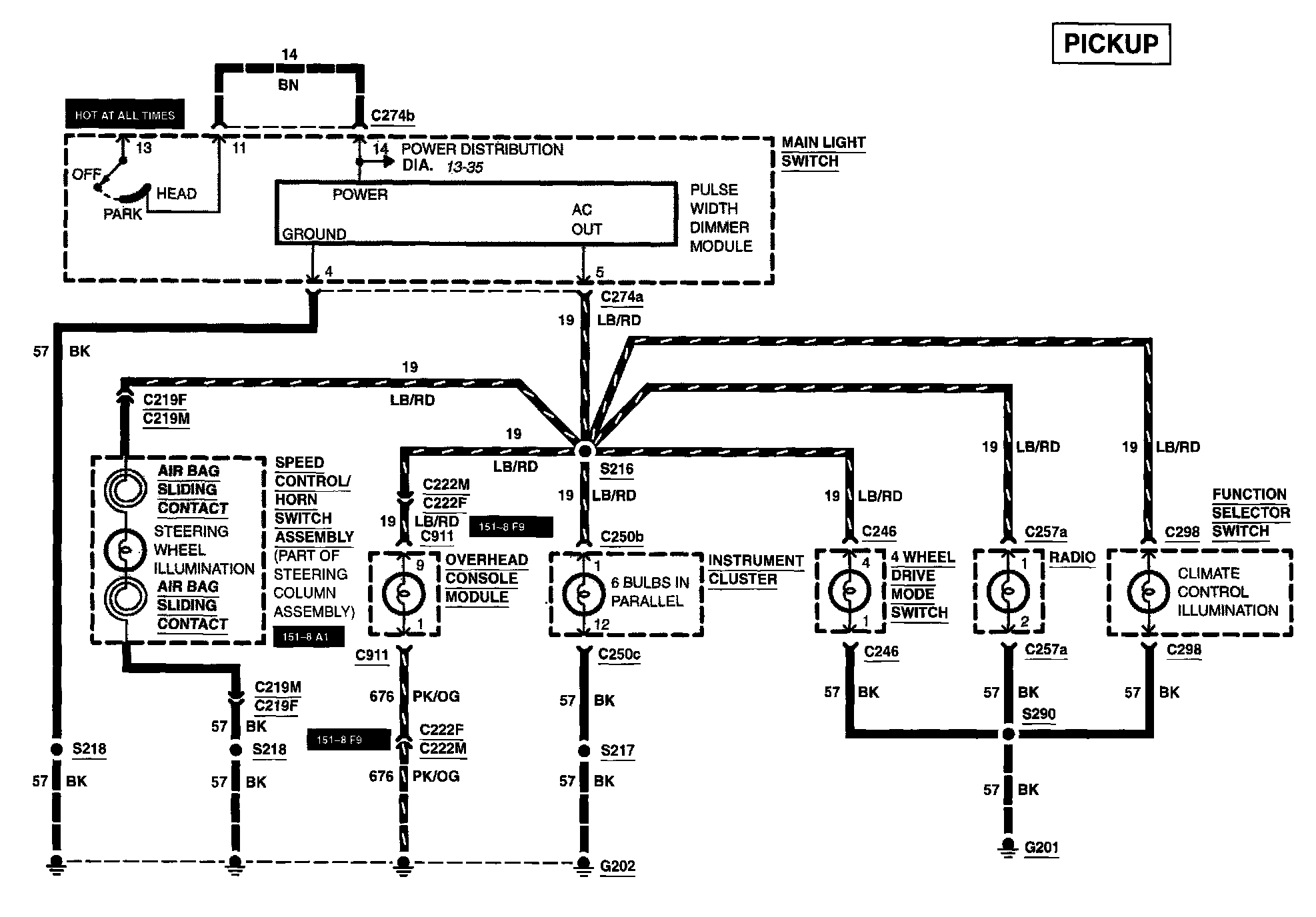

Went to drive the truck tonight and the speedometer/tach/ac control backlights were not turning on. The CEL, AbS, head lights etc lights illuminated as usual. Not sure where to start.

I would start checking at the headlight and dimmer switch. For power and then go from there.
