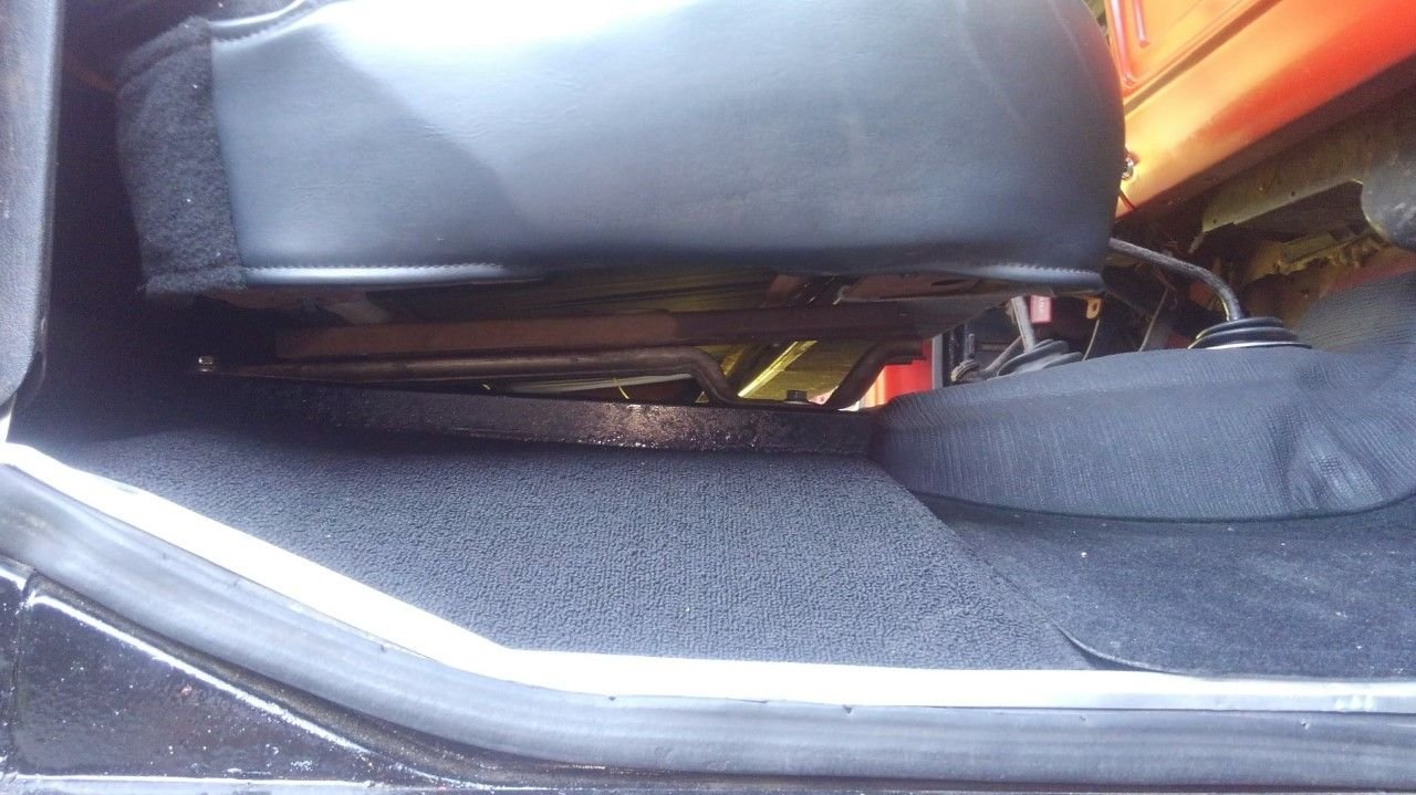

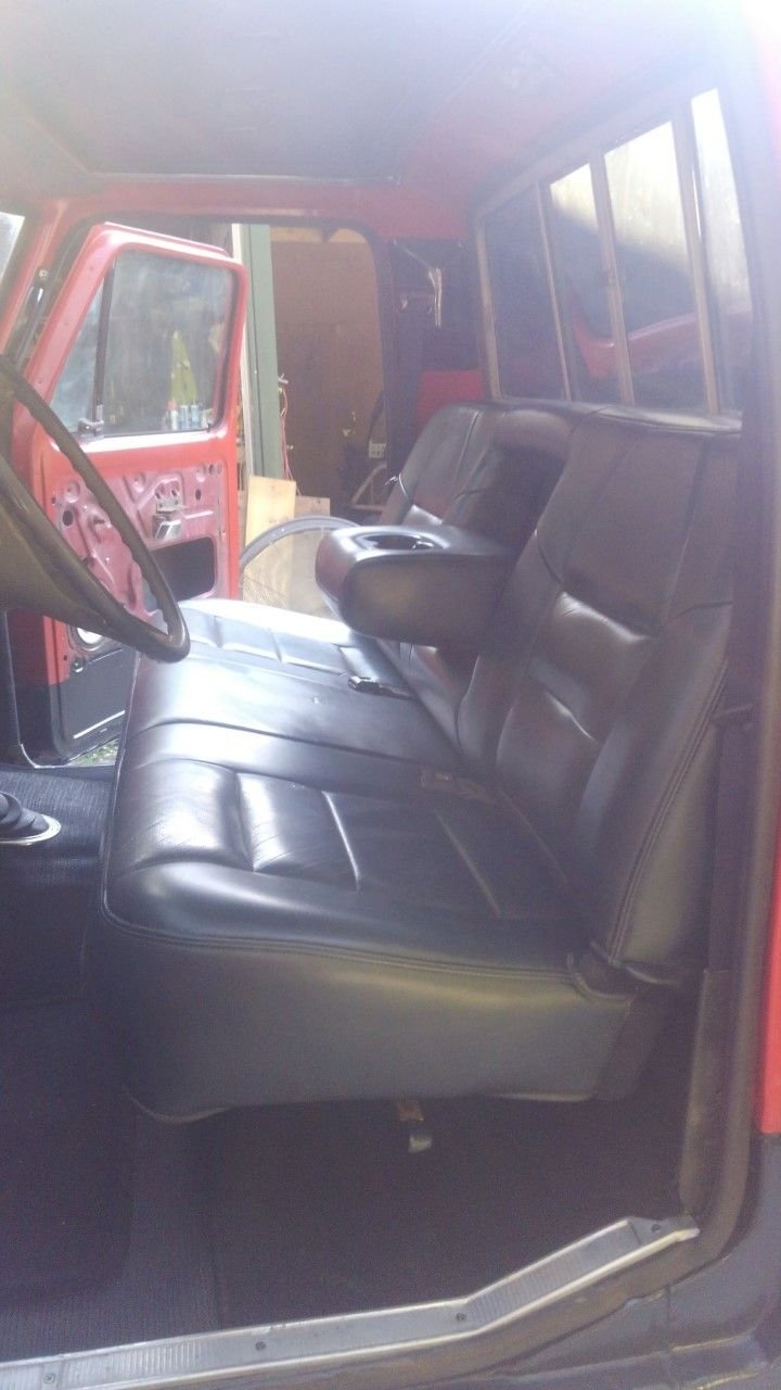

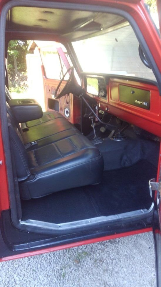

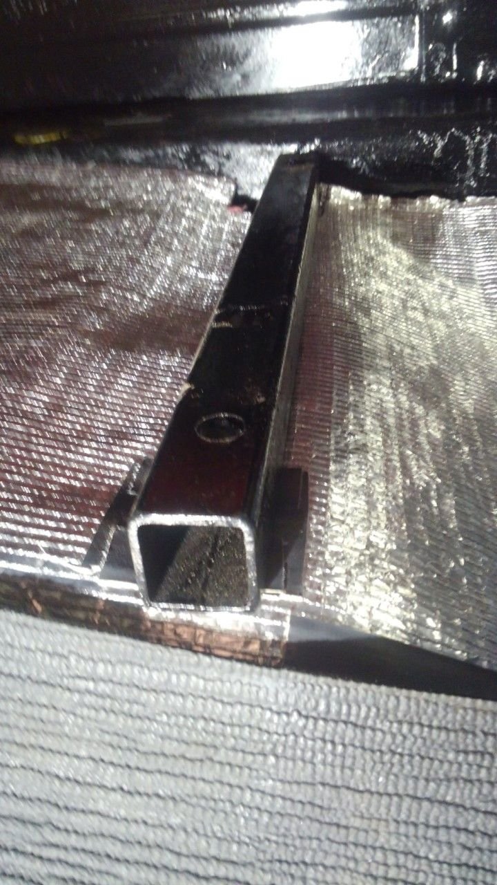

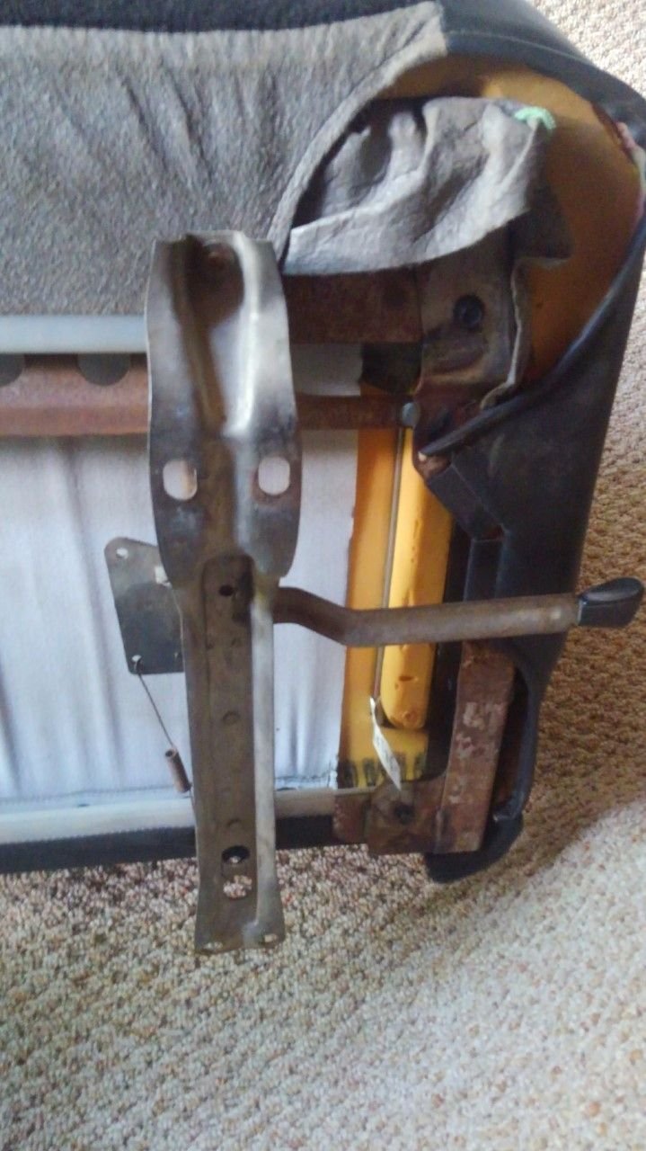

Yes, the 78 rails should fit on the bottom of your 88 seat. I put a 2000 ish Super Duty crew cab rear seat on my 79 rails. You might take the 88 seat it its current rails and test fit it in the cab, just to see if it lines up with the current hardware holes. If not no worries, read on.
Put your 78 rails back in the cab, set your 88 seat on top of those 78 rails. Roll the windows down and close the doors and get an even gap/measurement from the door panel to the seat edge.

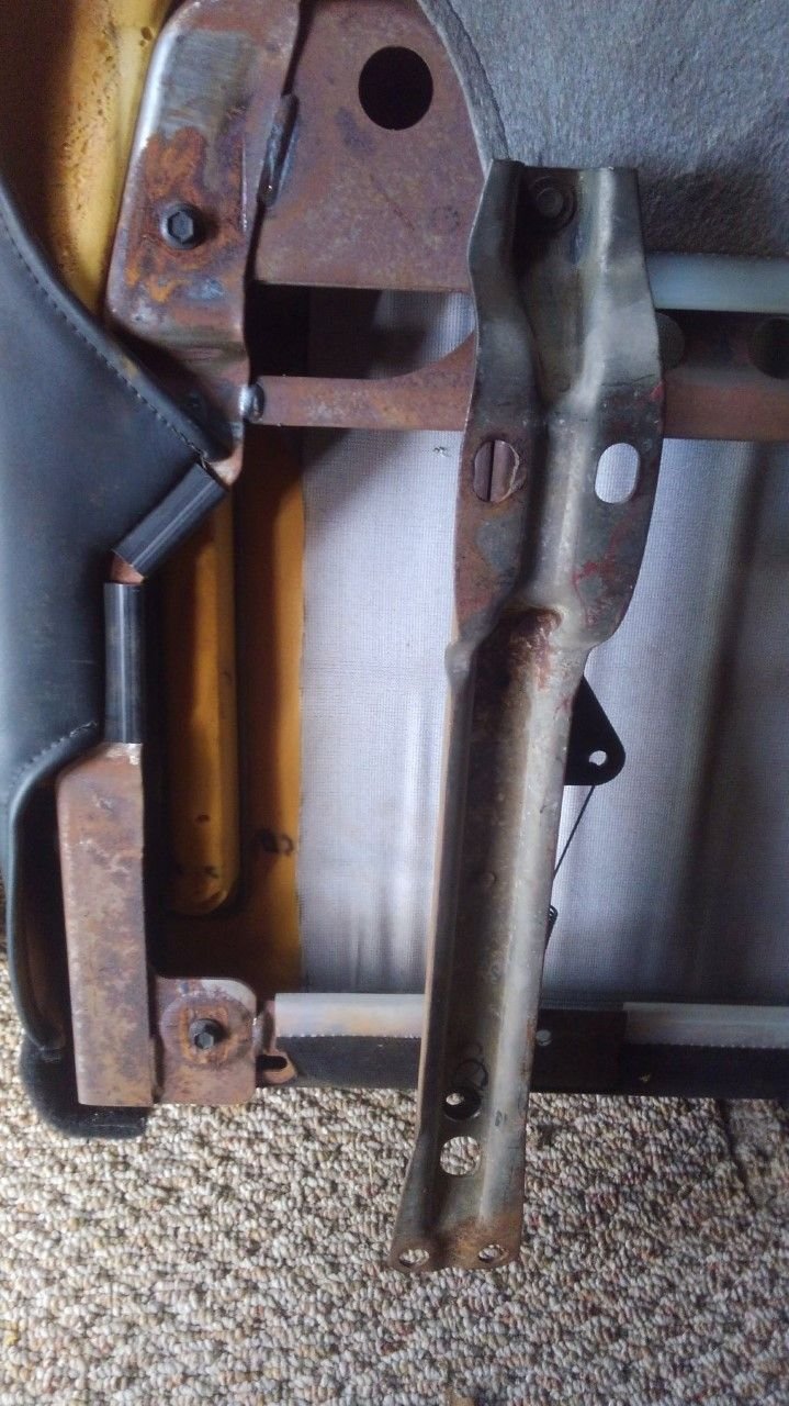

Then open the door and carefully get in the truck (try not to move the seat around) and set on the seat to check for a comfortable seating angle. I had to install riser tubes on my seat. If it's comfortable, mark the current position of the 78 sliders on the underneath of the 88 seat frame. Remove all, drill, install sliders, reinstall seat.
You can see the new holes I had to drill in the lower part of the track to get it to bolt on.
The square tubing I used as risers.
Seat and sliders on top of risers.
