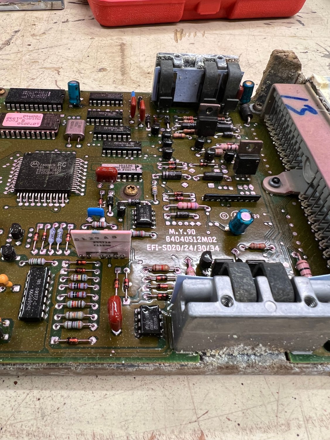

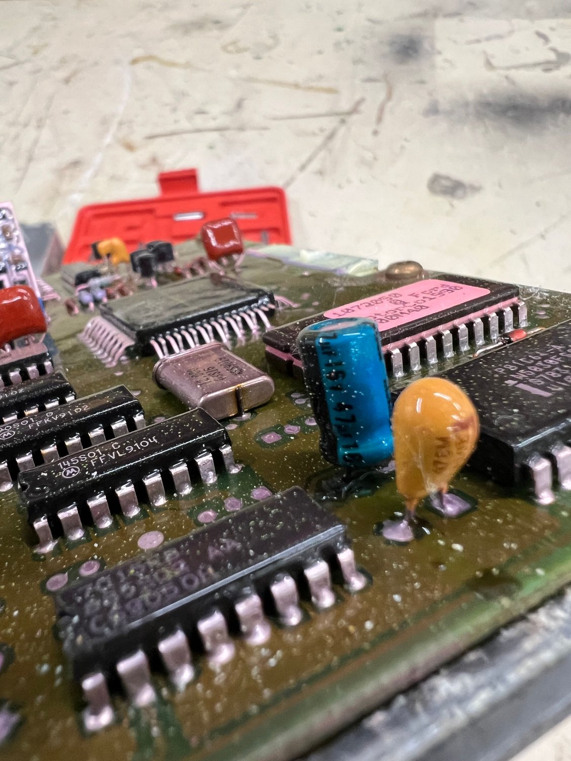

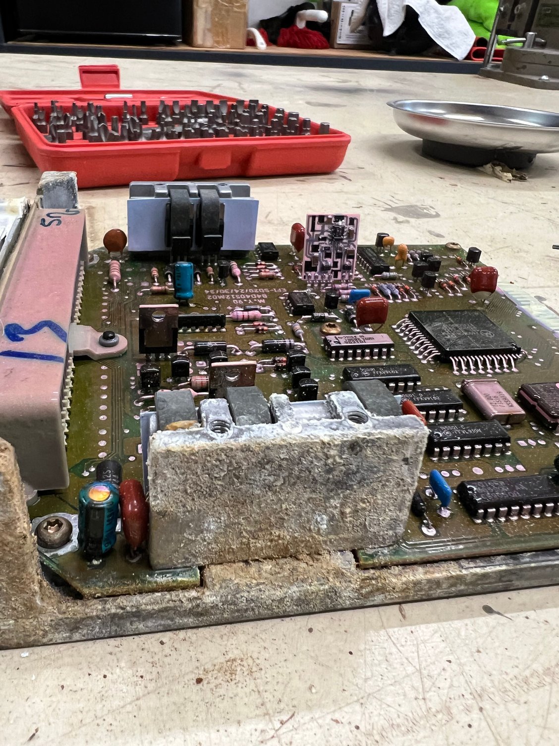

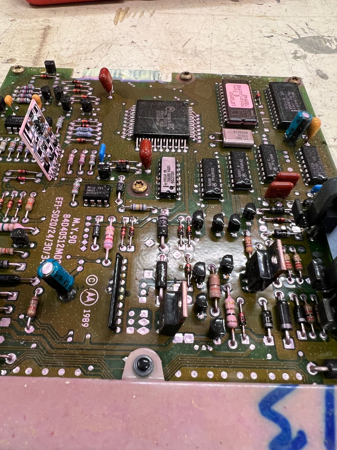

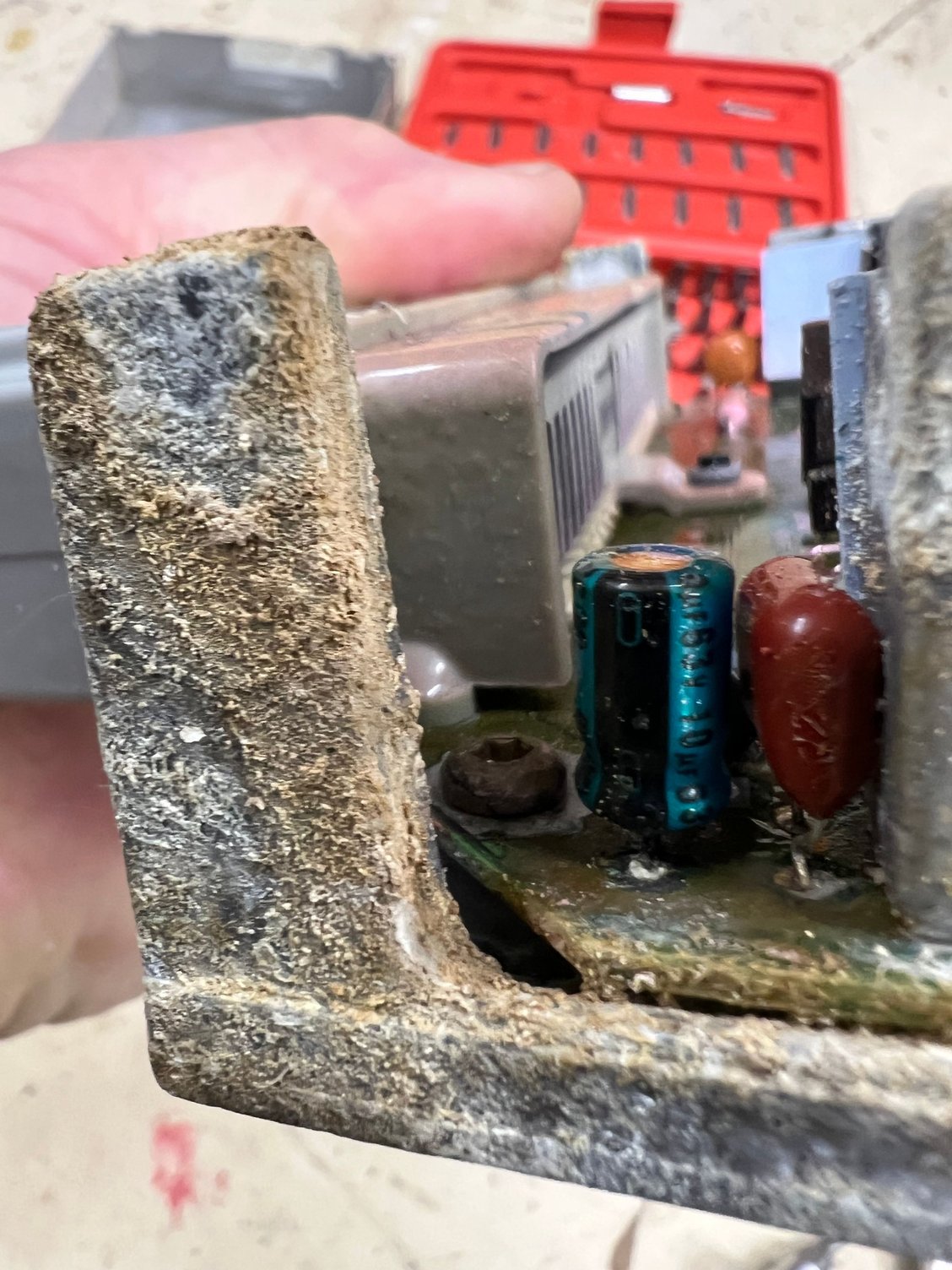

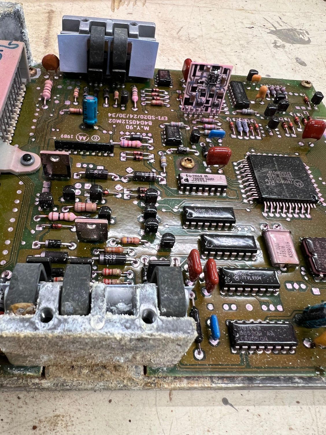

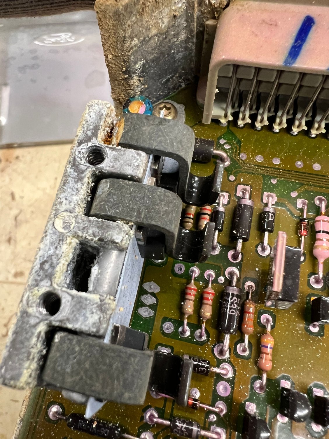

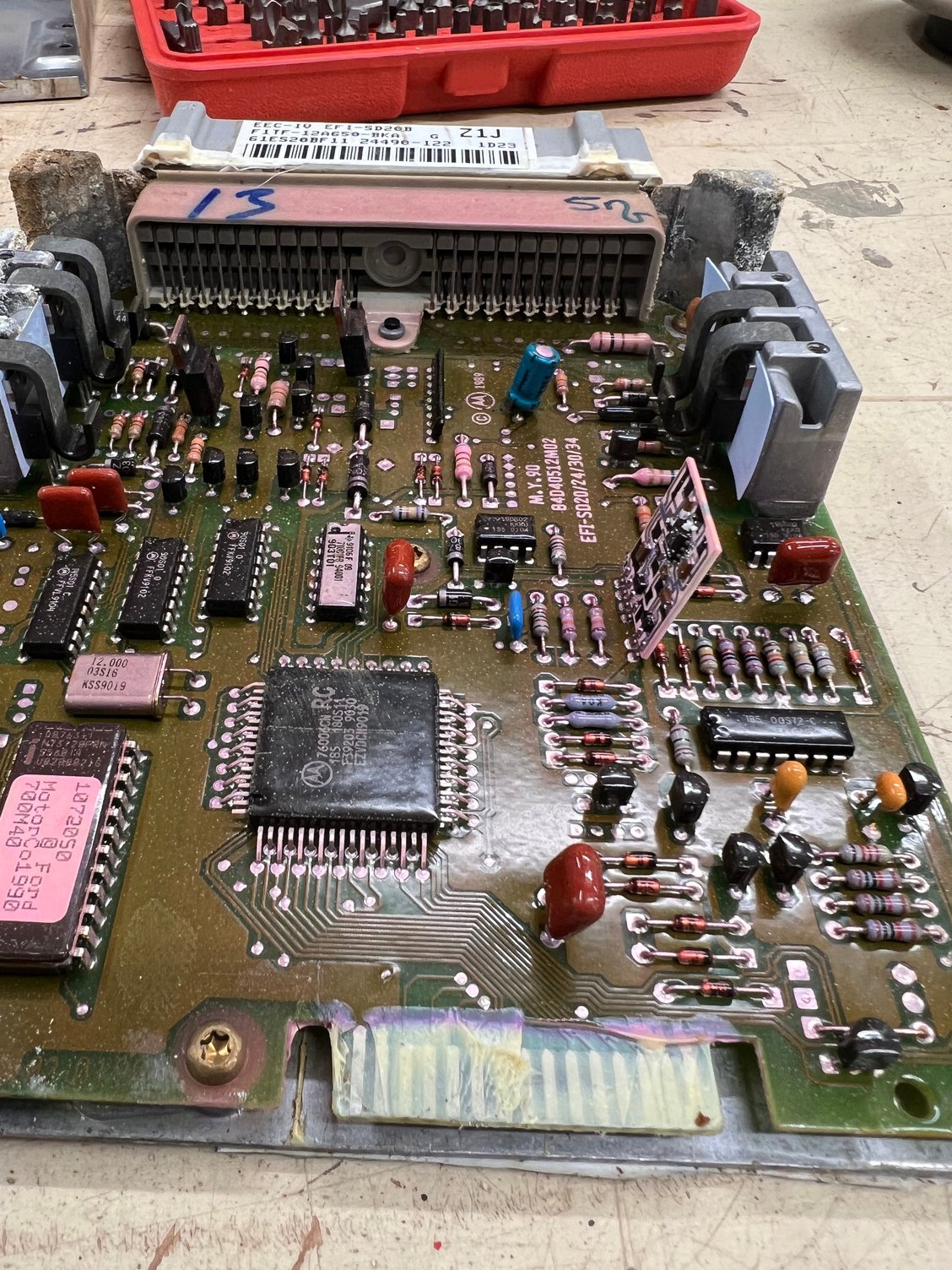

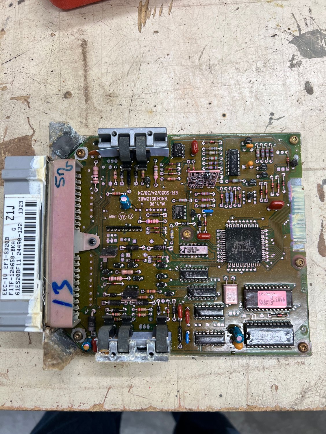

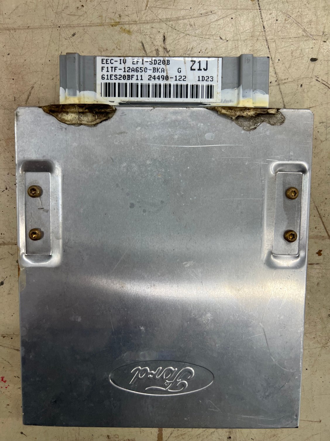

Looks pretty clean inside?
Old Nov 25, 2025 | 02:31 PM
Beatertruk's Avatar
Beatertruk
4wd Low
Joined: Nov 2025
Posts: 13

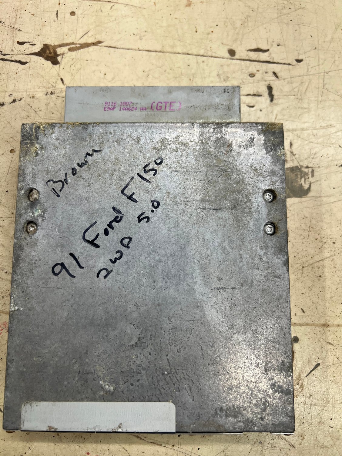

Since the case has that 91 writing on it I’m thinking maybe someone has already tried replacing this.

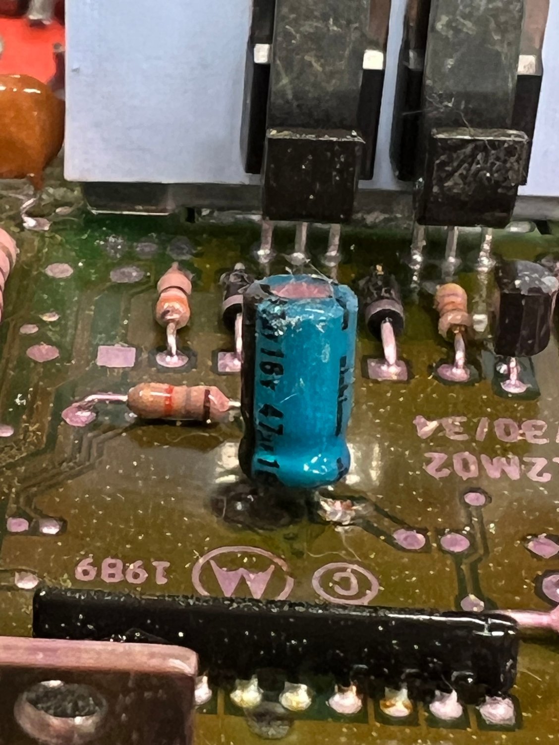

Last pic, look at the blue/green cap. It was rust/oxidation look on it. That computer case alone looks corroded. If it were ME, I would get another one. That’s me. The pics aren’t the clearest, but the one cap for sure looks suspect.
Old Nov 25, 2025 | 02:44 PM
90project5.0's Avatar
90project5.0
Joined: Oct 2025
Posts: 1,773
Likes: 388
Red circle is cap, blue circle is grounding block, I believe.
