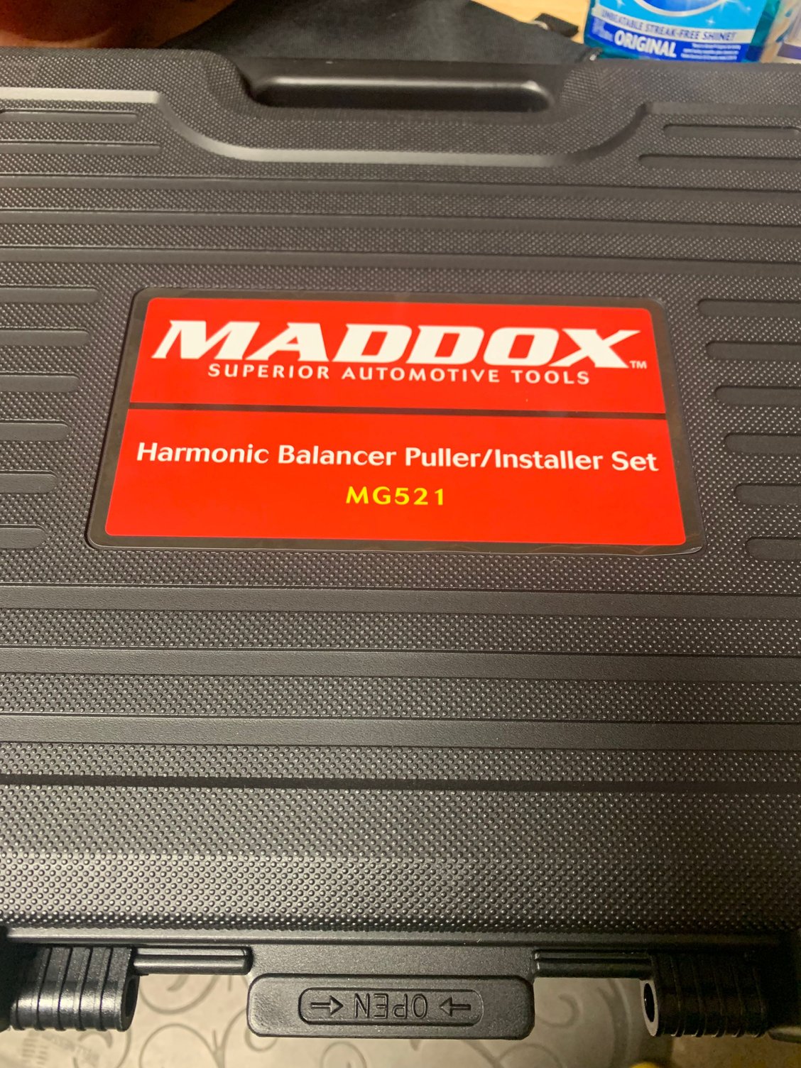

I used a HF puller and installer when I did the cover gasket. I was trying not to drain the cooling system, leave the radiator in, but I could not get the puller in with the radiator in place
Being yours is on a stand should not be a problem.
Dave ----
Thanks Dave, yeah I’m going to pick up a puller/installer from HF tomorrow.
So do you recommend putting oil on the threads of the balancer bolt, or thread locker? Should I use thread locker on the bolts for the timing cover?

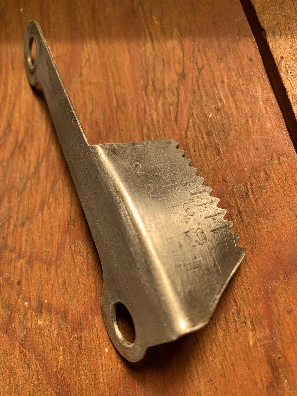

Also what is this and where does it go? I’m guessing it’s like timing marks? Can I paint it black or should it be left as is?

That timing mark you can paint any color you want but the factory had it engine color, blue or gray on the later 300's.
It gets bolted to the right side of the motor using 2 of the timing cover bolts. Should be easy to tell what ones by holding the part up to the cover and see what bolt holes line up.
Before you get everything on the motor make sure you mark the timing pointer for TDC and the crank pulley so you can see them when you need to time the motor.
Once the motor is installed and everything bolted back on it is hard to get to the pointer.
If you dont have a dial back timing light also mark the 10* BTDC on the pointer.

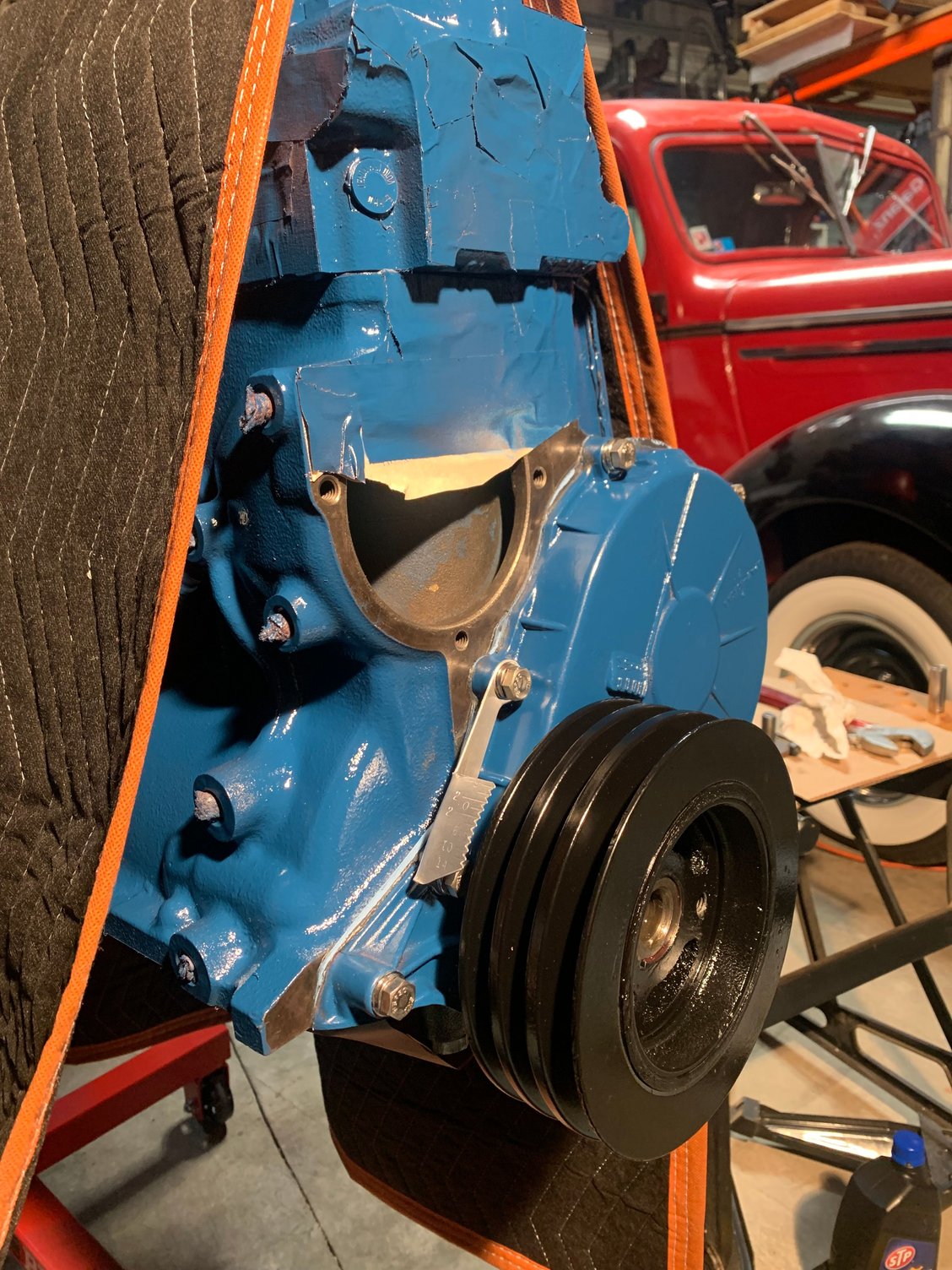

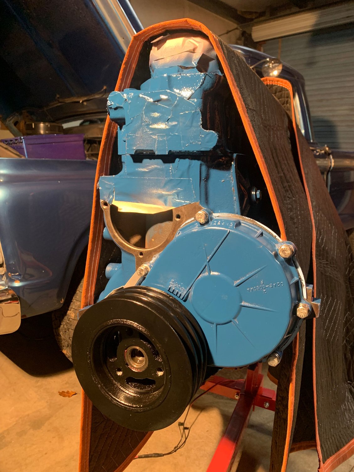

So I got the timing cover and the harmonic balancer installed today. I didn’t bother with the oil slinger since I don’t have one and I read somewhere that Ford stopped using them at some point, and it seems like a lot of people don’t use them anyway, so I decided not to stress over it too much.
I put Permatex black Right Stuff on the engine side, spread it thin, and then put the gasket on, then put Right Stuff on the timing cover and put it on the engine and finger tightened the bolts. I used blue threadlocker on all of the timing cover bolts.
i then put the harmonic balancer on using the tool, once the timing cover was centered around the balancer snout, I snuggled up the bolts and removed the balancer using the tool. I wiped oil on the rubber part of the front seal. I waited about a half hour and then torqued the timing cover bolts to 17 ft lbs.
I then put the balancer back on, wiping a layer of bearing grease on the crankshaft snout as well as the inside of the balancer snout, but now that I think of it I didn’t wipe any lubricant on the outside of the balancer snout that contacts the front seal rubber- hopefully that will be okay. I didn’t torque the balancer bolt since it calls for 130 to 150 ft lbs and my torque wrench only goes up to 80, so I guess I need to get another one.
so when I do that I guess I will put blue threadlocker on the bolt.
hopefully I did it right!

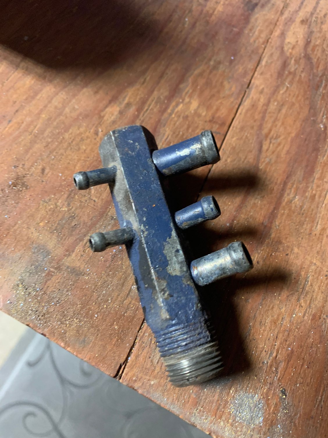

The original thermostat housing that was on the replacement 300 had this things screwed into it. What is it and what was it for? I assumed maybe some emissions stuff?

The top photo is the Vacuum Tree. Info and installation help / photos, below.
See post 11 for photo.
I have no idea what the gasket is for.
https://www.fullsizebronco.com/threa...vacuum.504572/
Jim

Ah thank you! That makes sense, and now that you mention it, I did pull that part off of the intake manifold. I was thinking of the old water neck that had a weird piece screwed into it that looked similar.
So since the truck is a 1966, i probably wouldnt need the vacuum tree, but maybe I’ll want to use it anyway since a dual MC and power booster is the next project on the list after the motor swap.

I am with Jim, vacuum tree and if oyu plan on power brakes then install it back in the manifold.
To "cap off" the ports I like to use short rubber hose with a screw or bolt in the end. The caps you buy at the parts store dry out and crack causing vacuum leaks.
