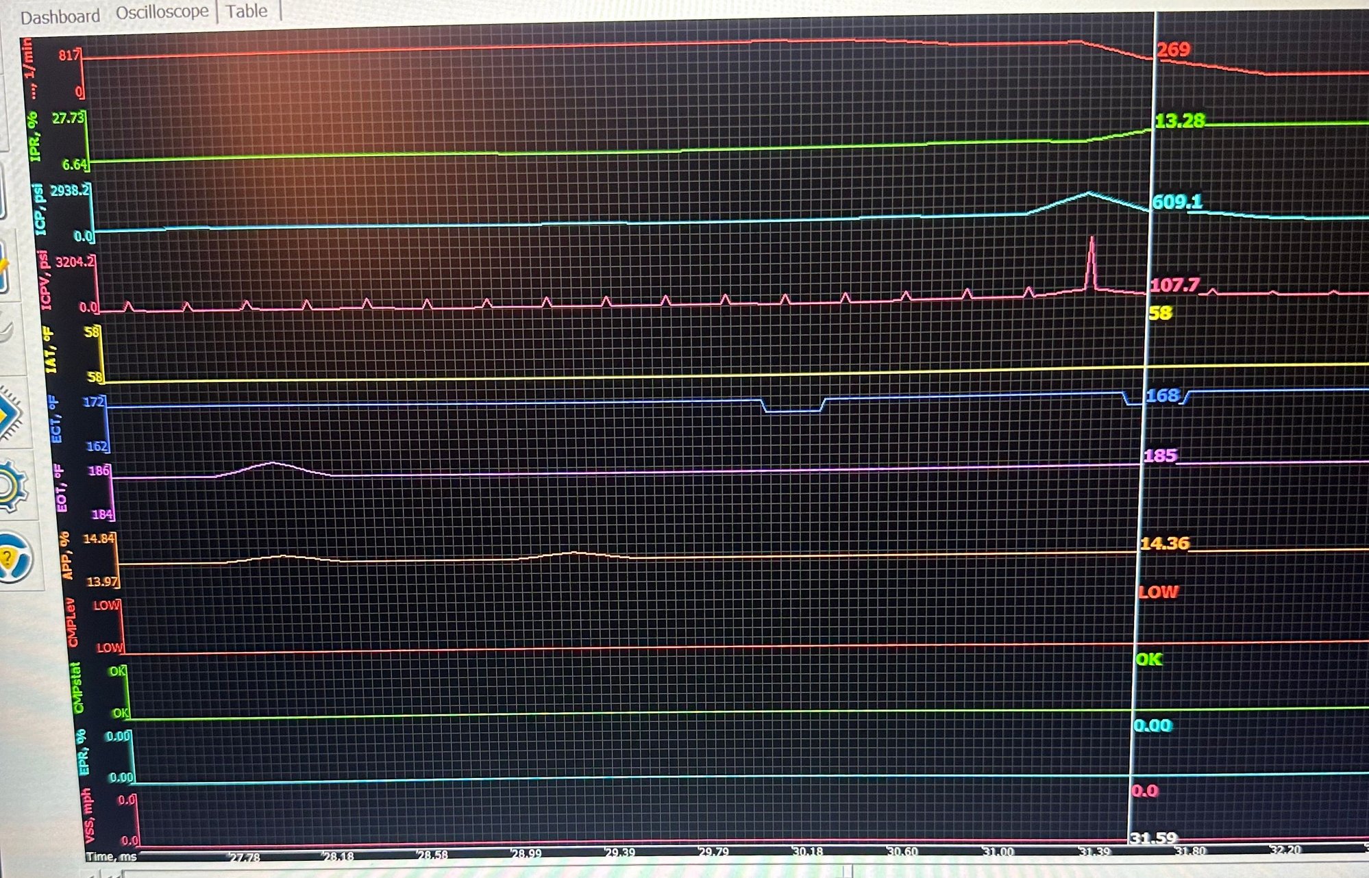

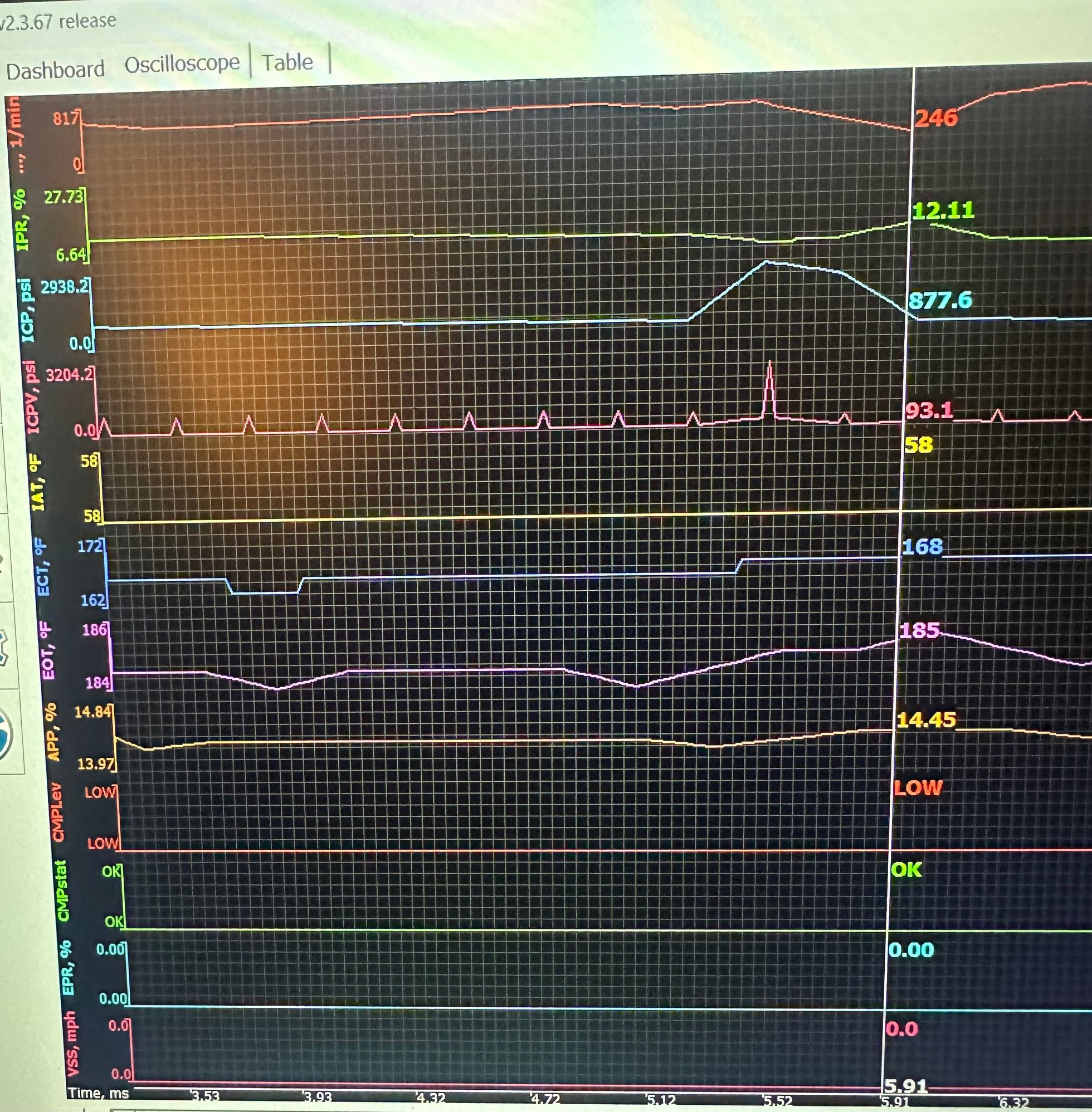

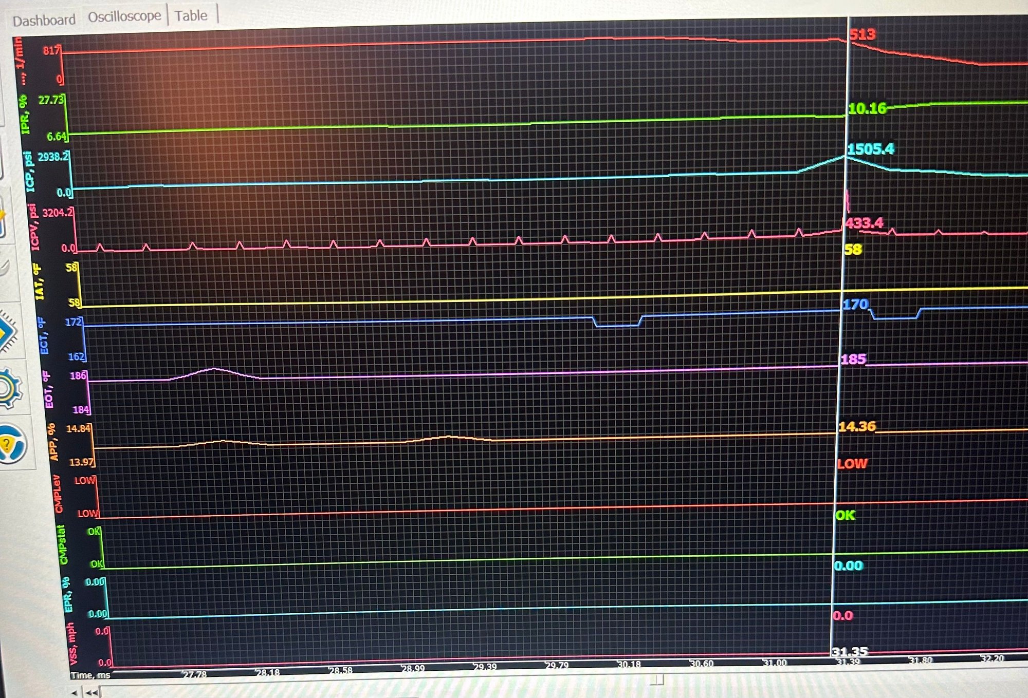

I’m having a random idle issue that has slowly progressed to a stalling issue. I have gathered data in forscan and attached some pictures below.
Do you think this is an ICP issue or an IPR sticking issue?
The truck doesn’t do it when ICP is unplugged. For this reason, I have ordered a new one and am waiting for it to come in.
I’m just not completely sure that is the issue. Also, The IPR is looking like a $500 part these days and I also don’t want to just throw that at the truck if I’m not sure.
I’d appreciate any insight and recommendations.
Patrick
Shortly after engine start. In park, at operating temp.
“Hiccup” over, recovering to normal idle
Shortly after the previous hiccup. Spike in ICP again, RPMs dropping.
ICP dropping back down, IPR rising, RPM still falling.
Truck completely stalls.

ICP unplugged and it runs better usually means that the ICP is reading PSI wrong and possibly ICP sensonsor is deftective.

That’s what I’ve read and why I’ve ordered one. The sudden spike makes me curious if it’s a voltage issue instead of a sensor issue.
