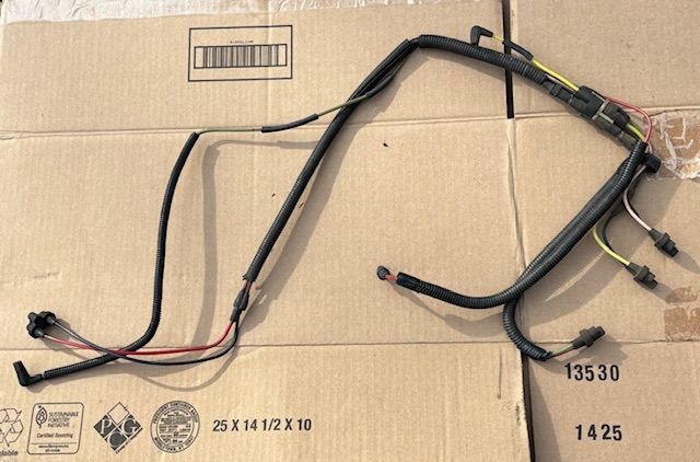

Can anyone take pictures of the vacuum lines and allow me to trace along where each color goes? There’s no longer a sticker below the hood. And the few diagrams I’ve found are confusing at best.
There aren’t that many lines: feed from the upper plenum and vacuum can to the TAB/ TAD and EGR solenoids and then out to the valves. Another from the fuel pressure regulator to the plenum.
Post some pictures of what you are seeing.

There are vacuum lines that go into and out of the harness but connect to nothing. And there are no open spots on the solenoids or throttle body. That’s the confusion.

We cannot see what you are seeing from this side of the screen.
EDIT: left side- red and black to vacuum reservoir; green to EGR valve
red (center) vacuum tree to reservoir
right side top to bottom TAB, TAD, EGR
