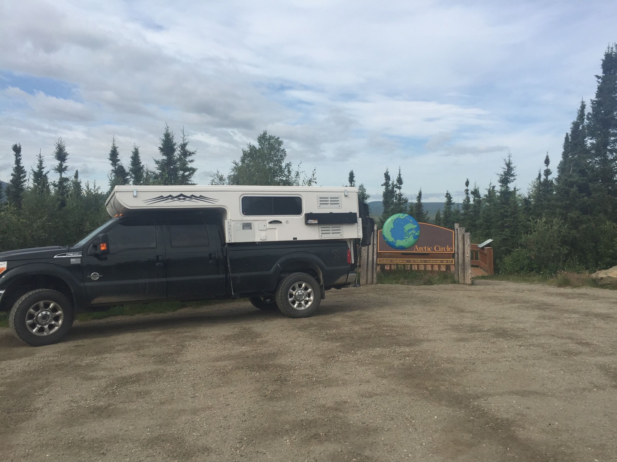

Jefe XTC Off Road Truck Camper
Here is Jefe being interviewed about his off road truck camper. He was a Rubicon off roader that started truck camping later in his adventures.
@jefe4X4 started a little before me in truck camping and I started reading some of his adventures when forums were just starting up.

Jefe4x4 F350 Truck Camper
Here is his F350 he is currently using.

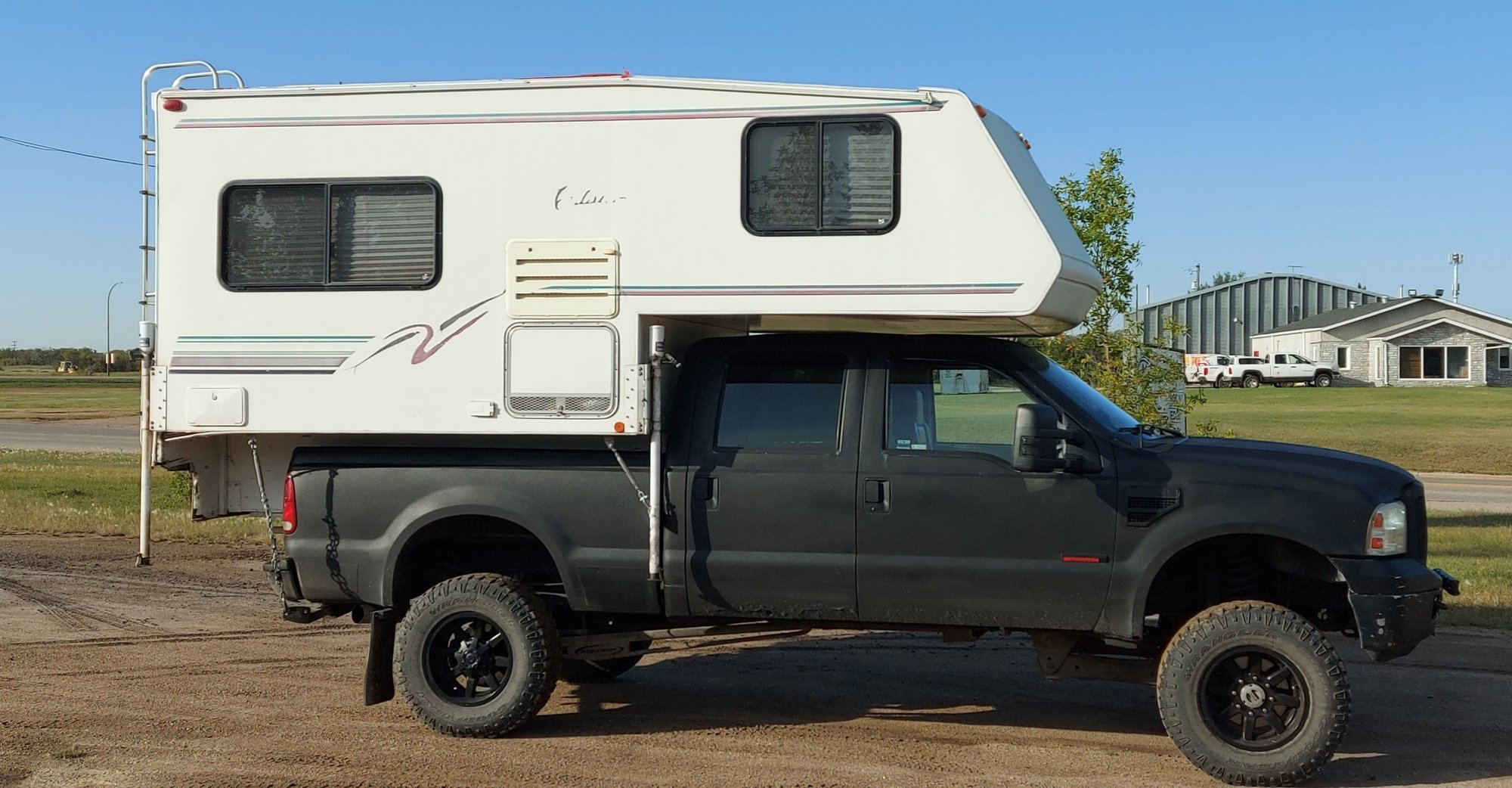

8" lift on my 2006 and no issues with my 2200lb(DRY)97 Citation 8.10 after 1 year of use. I'll be dropping to stock or 3" soon, but only for legal reasons otherwise I'd keep it as is.
Very stable in high winds, when turning and offroad, but the truck has traction bars, a much wider stance than stock and a 6.7 steering gearbox and even when loaded up it's still the best riding vehicle I've ever owned!

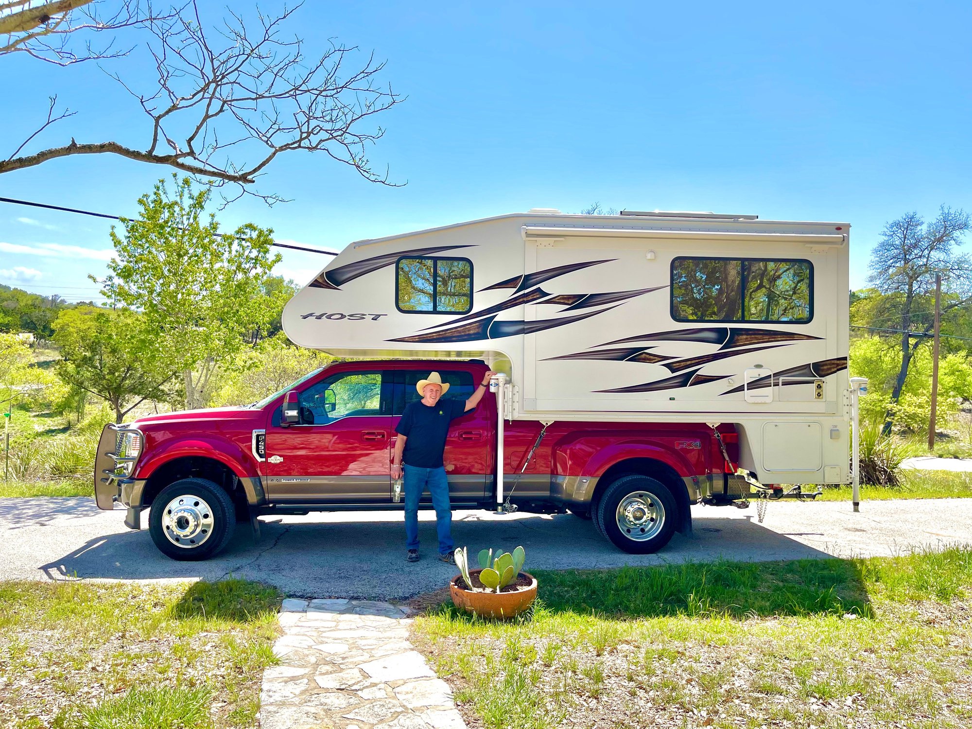

Here is my setup:
2020 F 450 King Ranch, Host Mfg Mammoth 5990 in travel weight
If you go this big there is only 1 truck, F 450! That said I had it on my F 350 and no way would I ever do it again. My F450 in OEM config will handle 6k in the bed and not SAG! In fact it levels it out.
If not a F 450 then what you chose and I had 5 F 350s, duallys. You still need to beef up your rear springs if you don't take advantage of the Ford upfits such as snow plow prep and the camper certification package...

Front end looks a bit high. Does the truck have air bags and if not are the overload leaf bump stops still original?
2" aftermarket bump stops on my 06 F250 short bed and keeps my truck just about level with 2500lbs of camper/gear in the box.
