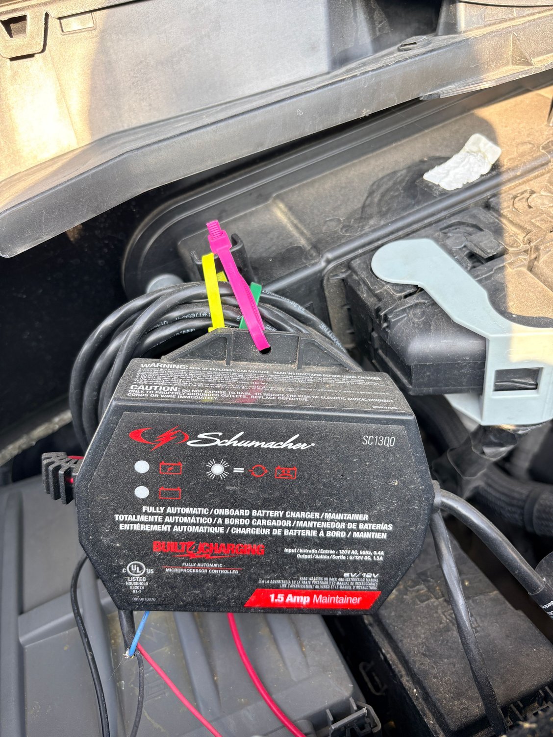

I have a Schumacher 1.5 amp zip tied in place and a cord run to a spot behind the grille that I can grab to plug it in. It's done the job for me.

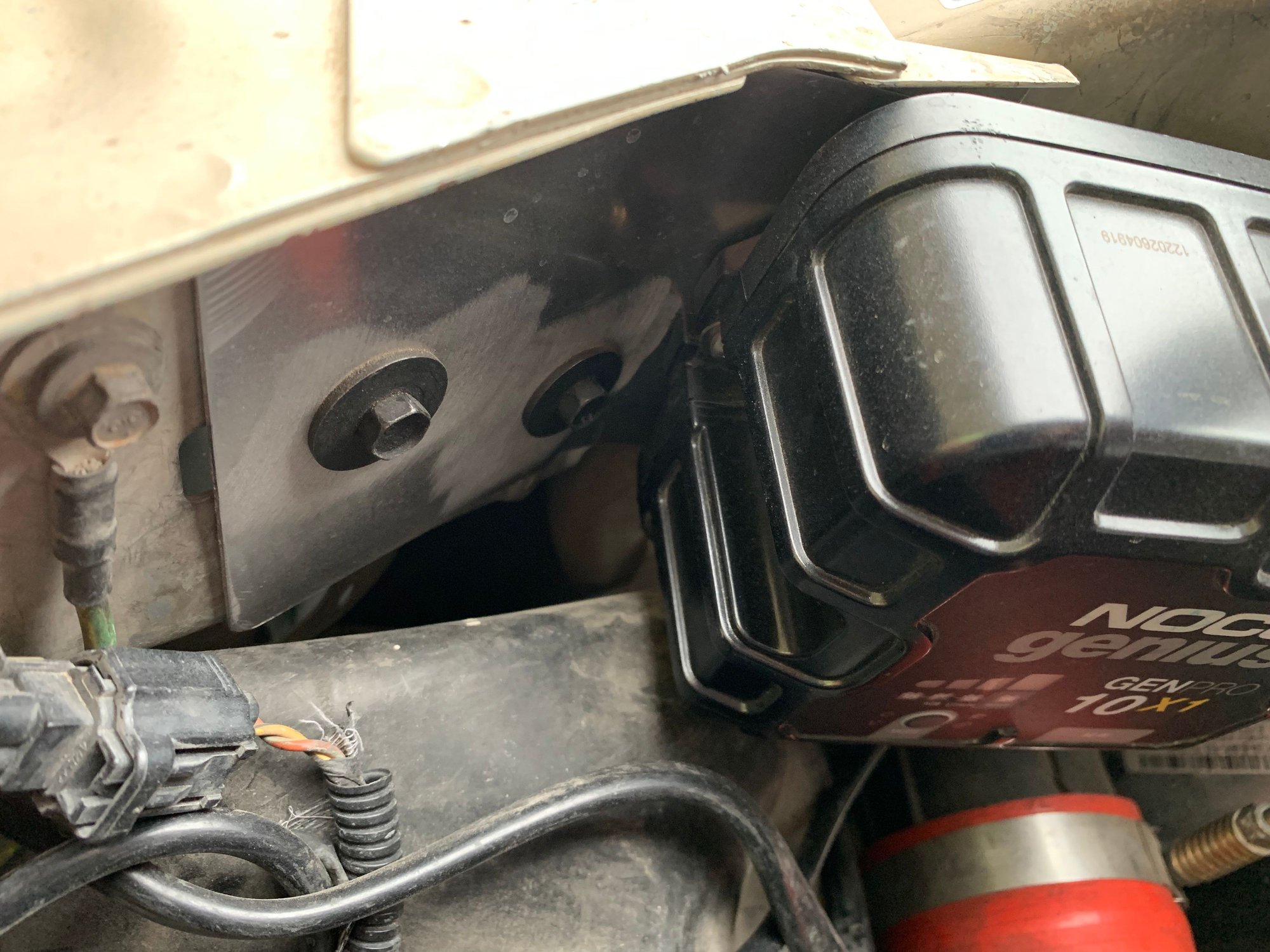

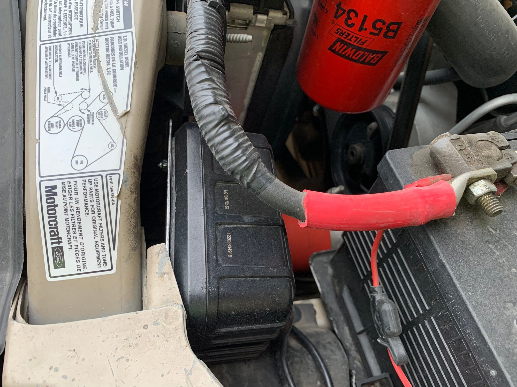

Adding a NOCO AC port like this post shows has been on my list of mods. My plan is to mount the Noco Genius10 under the hood paired with the AC port.
https://www.ford-trucks.com/forums/1...m_content=post

I have been using the Noco Genius Noco for about 2 years now. I have the power cord routed down below the radiators. When I park at home andt to use the truck for a few weeks, I plug it in. 2 amps is enough to keep both batteries charged.

I do too many short trips so the batteries do not get a chance to charge properly so about once a week it gets plugged in for a good top-off overnight.
One day I may re locate the plug behind the grill but the custom mount for the dual NOCO plug works for now. Twin plug has one side to the maintainer/de-sulfater/charger, the other goes to a thermal cord for the block heater. The heater only gets tripped when below 38 and goes off above 45 so fully automatic battery and heater plug, makes winter easy, with healthy batteries always topped off.
The the under hood work is custom hammer bent aluminum attached to the radiator supports pre cut holes for U-clip nut plates.
