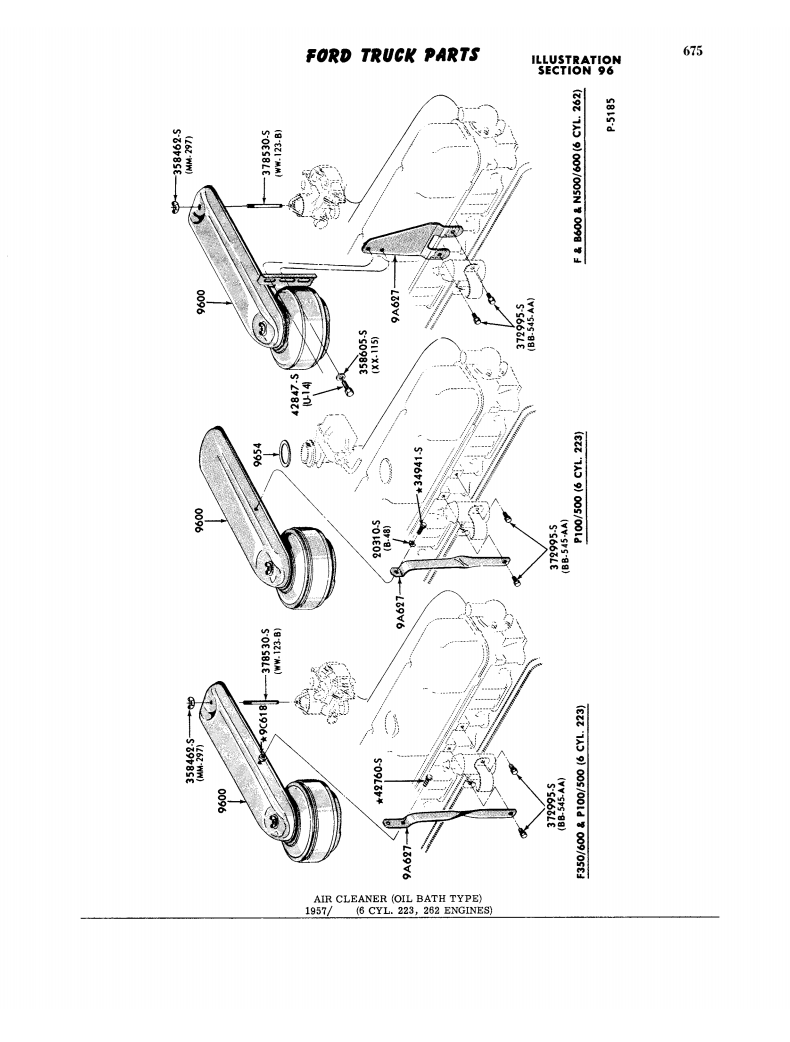

Is your air filter the oil bath type? Most of them came with that type. A 1961 F100 is not called out in the drawing from the 1957-1963 MPC but both the text section and the 1961 specific Truck Parts and Accessories catalog say it should be an oil bath so if still original that maybe it. The drawing below shows a common setup but as you can see the F100 and F250 are not part of those called out on this drawing. If it is like shown, then you are probably needing that base number 9A627 that supports the long tube by the hole in the middle. Perhaps this will spark an idea of how to create your own.
