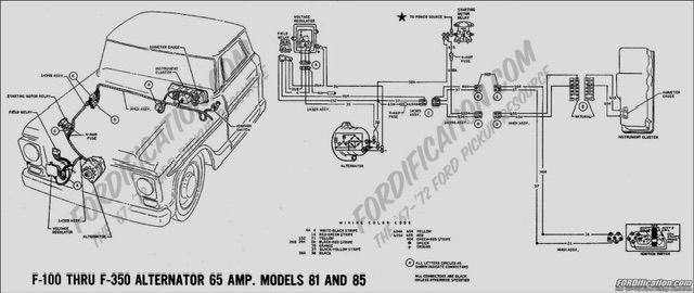

alternator wiring
trying to connect all my wires again and wondering about the alternator wiring witch ones go where does any one have any diagrams or anything that i could go off of for a 390 thanks
