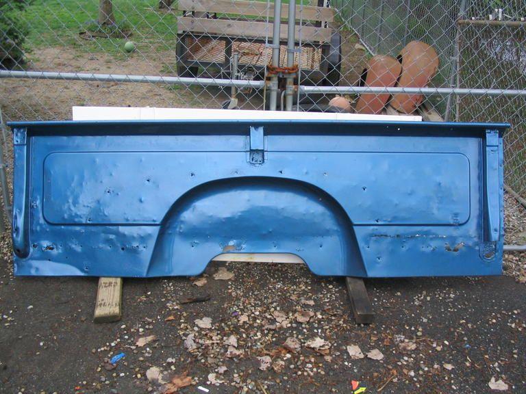

8" Express Bed has a few wrinkles and rusts out. All stake pockets will need to be replaced. Luckily I scored another 8' bed that I was able to get one good side, Head board, tail gate and the remaining stake pockets needed. One side was toast except for pockets. Will be welding rust out, pockets, and tail gate. I once came across a web site that had someone repairing a tailgate for an 8" Express Bed. The way he did he cut out the smaller tailgate from a 6' bed and extended to fit an 8' Express Bed. I downloaded the procedure. But can't find the site anymore though.

Outside view of Passenger Side. Driver side is same shape in same areas.
