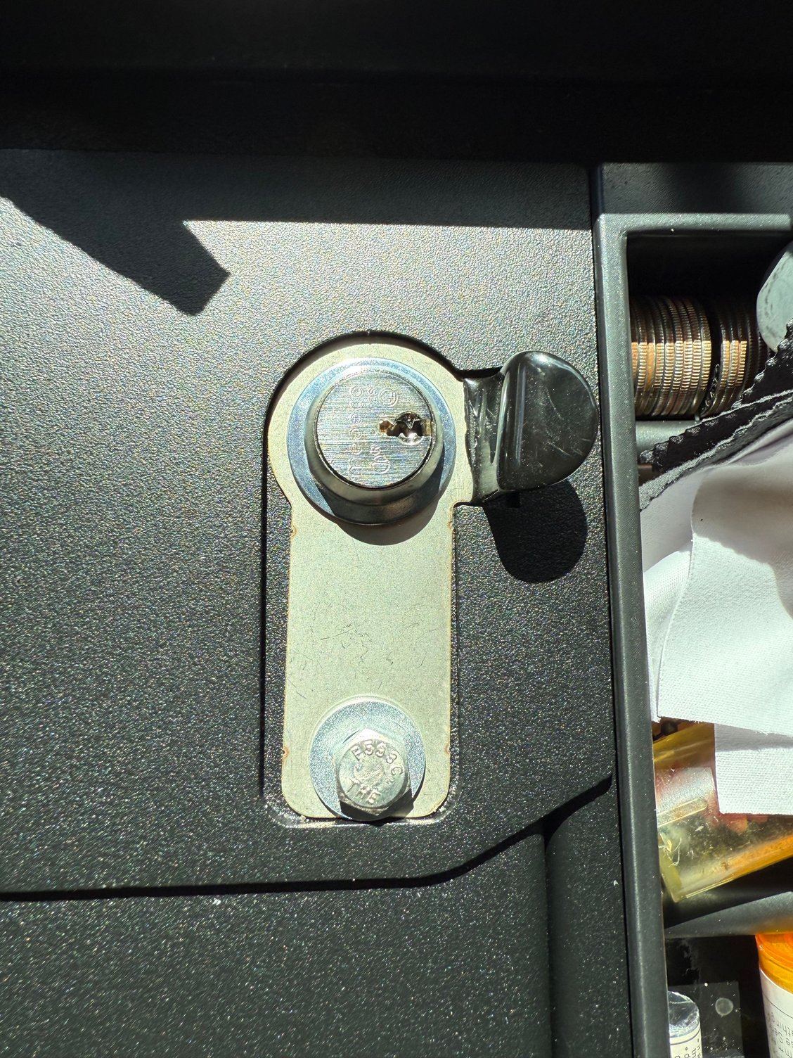

Installed a console safe that takes up 1/2 of my console. As many of us here know the safes are decent but the locks are the weak point making if pretty easy to get in with a simple pair of channel locks if you know how.
The lock is a standard 7/8” Cam lock. I upgraded to a Medeco high security key lock. The upgraded lock is hardened steel and sits much lower so it is near impossible to get a grip on. Nothing is impossible to get into but this will make it much harder so hopefully they move on to an easier target.

Agreed, that’s why I swapped the lock to a 1/4 turn Medeco lock when I installed the safe.
