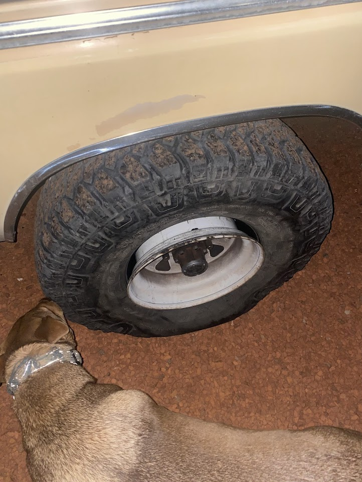

Hello I was scrolling through facebook marketplace today and saw a NP203 hub and remembered a friend of mine was looking for a slug for his 76-77 D44 however nobody makes one for that "Big Hub" design they used on those couple years.
What I am wondering is if he could buy a NP203 non locking hub and put it onto his locking hub axle or do they use different length axle shafts?
This is the "non locking hub" that I am referring to.
This is what I am referring to as a slug however I know the NP203's non locking hub is different I imagine it would be stronger than a locking hub. This friend of mine keeps breaking his locking hubs and is looking for a solution.

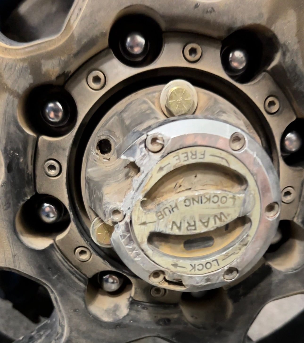

The shafts are the same, you can add locking hubs so that means you can remove them.
The original Spicer big hubs are very strong, the Warn premiums are too, a lot of the others are junk. if you're breaking the good hubs you're doing something wrong, and if you prevent the hub from breaking something else will.
I understand that however there is 2 different lengths that these D44's used and I am not sure which the full time hubs used. They have the 10.66" length axle shafts and the 9.72" axle shafts.
I know my truck uses the 10.66" axle shaft with the locking hub however the full time hubs may be different which may be why you can buy 2 lengths.

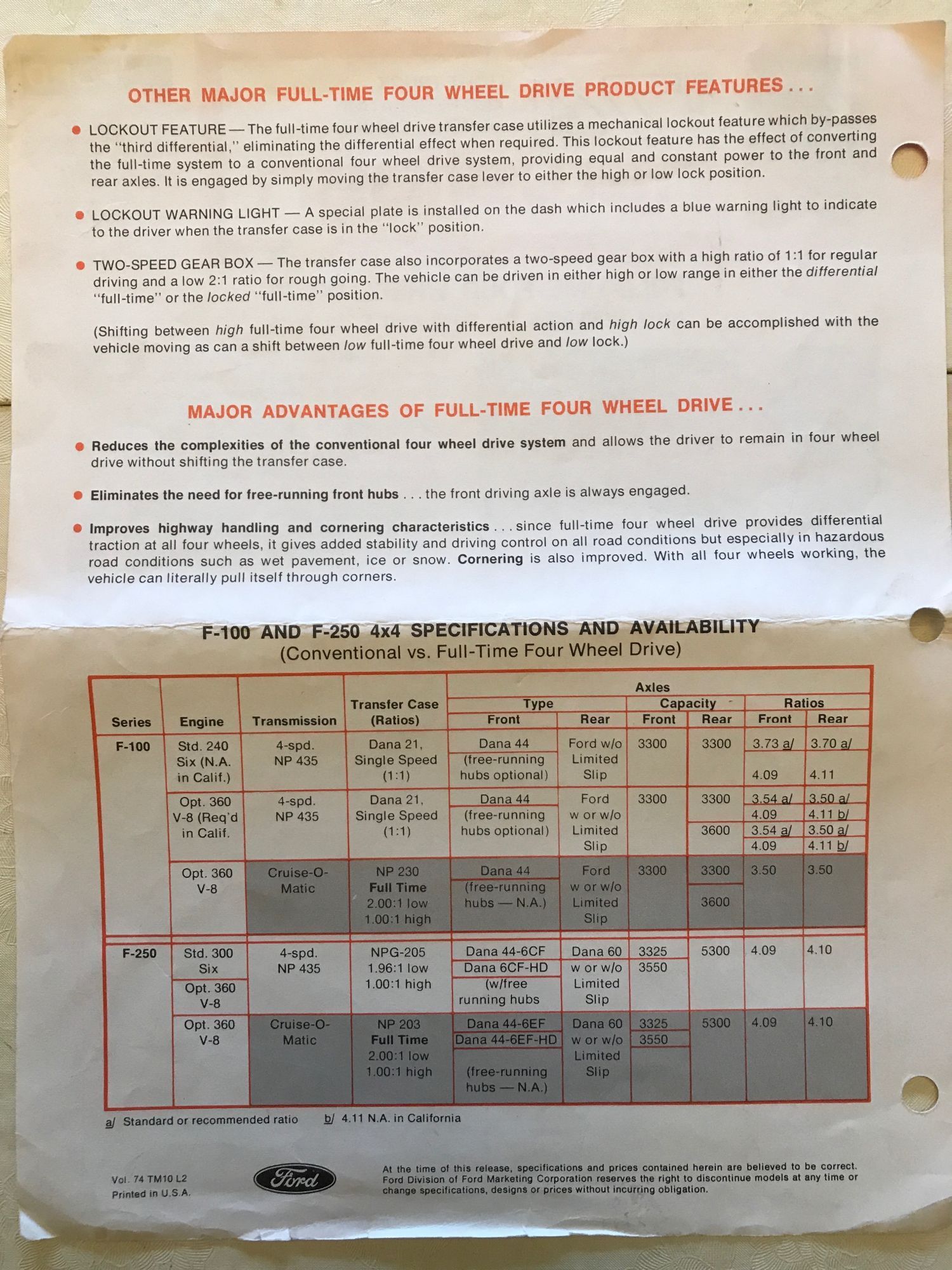

Interesting so thats basically all he needed to know because I believe the full time hubs I'm talking about only came as the big hub.

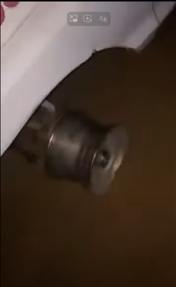

Awhile back I had a buddy of mine take a picture of his full time hub on his 76 F250 that a rewired a couple years ago. So I suppose in theory it should just bolt directly onto where his locking hub is.

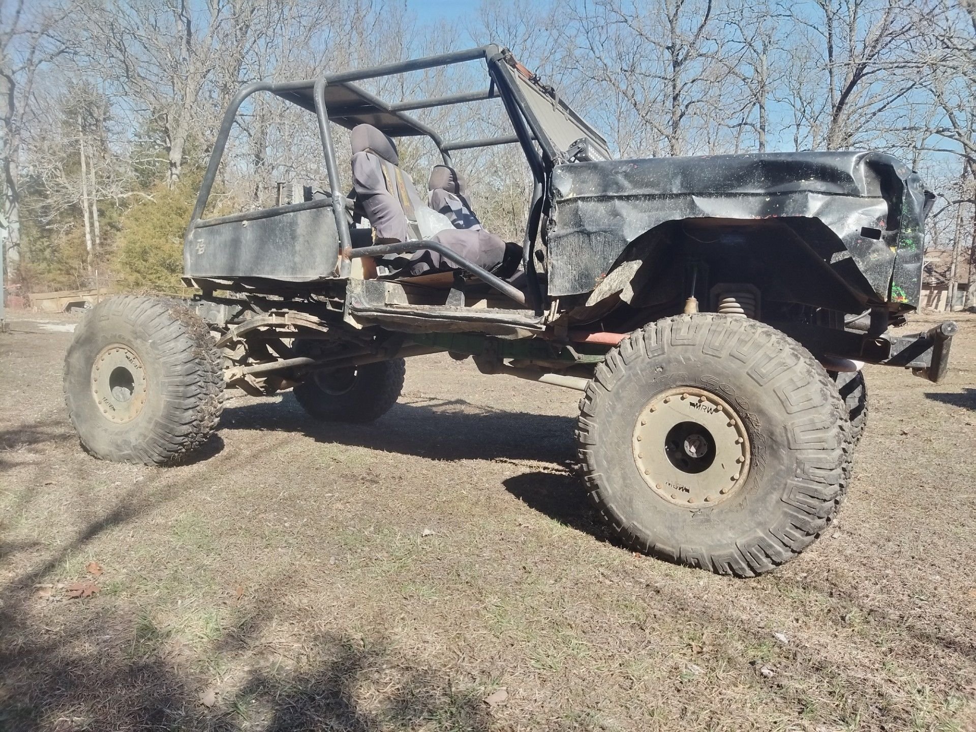

I believe @Mezza has either locker or a spool in the front axle and is a dedicated rock crawler such as your bronco.
Im not sure what his transfercase setup is but id assume hed have some sort of front dig already.
I think hes got KMC Grenade beadlock wheels with 42" Patagonias on his Jeep.
So I think a mixture of the offset of the wheel doesn't help much to his case of not smacking them on things.
Locking hubs are just another thing to break and with 42" tires I wouldn't be surprised if they were the weak link of the D44.
So I think the full time hubs would work great for him just a matter of finding some for his axle before trail hero next week.

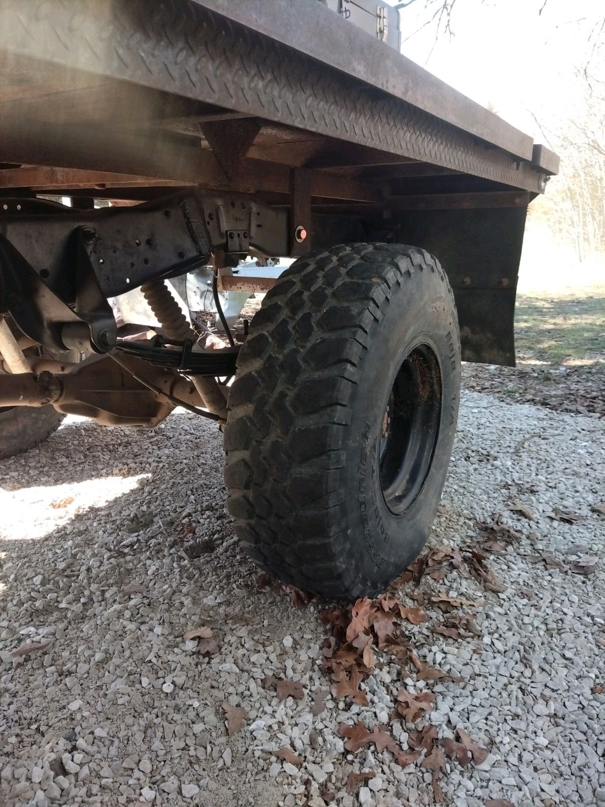

42's on a D44 is a gamble IMO unless you have upgraded axle shafts (4140 chromoly), and some CTM u joints. And that is working hard on those small version DS u-joints for sure.
FYI those are NOT HMMWV take off tires, yes same manafacture and tread design (Goodyear Wrangler MT/R). If they were Mil takes off, they would be 16.5's. But are just 15's and yes have had a hard life.
We run all sorts of tires on that thing.
Now these ARE HMMWV mil take off 16.5's. They are cheap so run'm. They will be bald before you have to tube them to get them to hold air.

Anything with full time 4wd came without hubs. I have a '79 F250 with full time and the standard smaller hubs locked in.
Old Sep 28, 2025 | 12:56 AM
77&79F250's Avatar
77&79F250
Moderator & parts slinger
Posts: 50,283
Likes: 5,824
Yes full time 4wd truck just has caps/covers in/on the end of the front axle.
