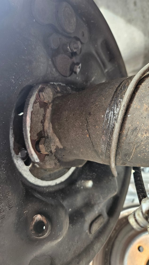

While TDY last week I get the dreaded phone call from the 17 year old. "Dad, somethings wrong with my truck" Swears he didnt do anything.
I'm thinking he decided to set the parking brake as hard as he could and just gassed the crap out of it to get it moving. Took the hard brake lines and parking brake cable out too. Now I get to scour the junkyards looking for backing plates as the bolt holes are destroyed. Any tips on finding them somewhere else?

WOW!! In my 57 yrs I have never seen anything like that!?! WTF?! Never, never ever, even growing up in the rust belt, wow, I would think something else let loose and caused a bind inside, or... like you said he SET the parking brake ALL the WAY! Sorry, good luck with the fix!
I rarely use the parking brake in any of my trucks, all are manuals except my 00 Ex, 02 F350 and 22 F550, and on those I'll use it maybe 4-5x a year, probably same with my old trucks, but as soon as I start to go and notice it's not going, I go DOH! Release the brake DA!
That is some carnage!

Looks like wear for a long time, finally chewed cable.

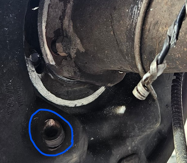

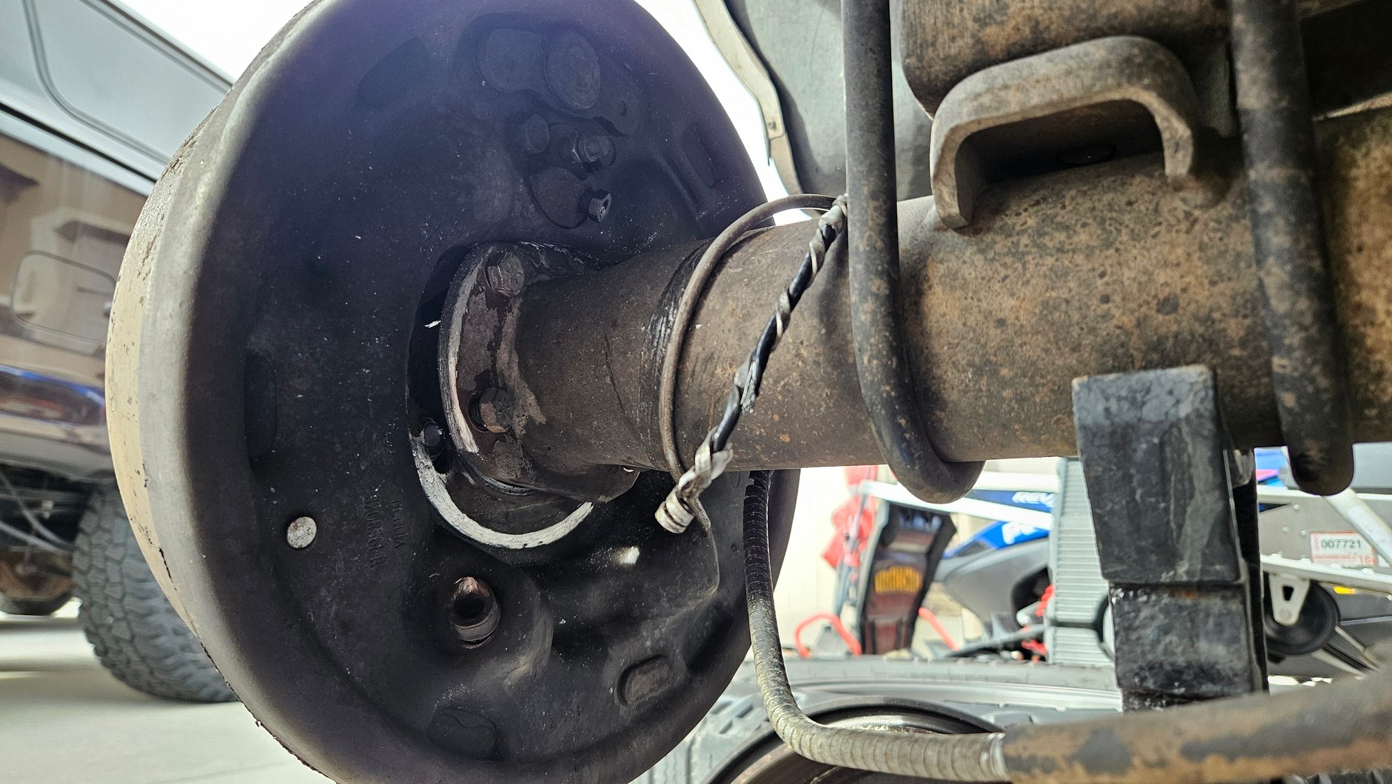

When the bolts securing the backing plate let loose, it wrapped the parking brake and hard brake lines around the axle ripping them out.

Never saw it quite that bad either
I sure would make your 17 year old son help get the parts from the junkyard
He may have been power braking it, trying to get the back tires to light
The E brake has probably been sticking for years

Oh skippy will have to pay for it as well! Brakes were all new last year. I got the full story last night. Posing the truck for cool guy pics up on the mountain. Forgot he set the parking brake. Went to leave and obviously couldn't....Until he put it in 4 low that is. Built 351, 4.56 gears and 4 low made short work of the bolts.

I think you can fix it pretty easy
Hopefully the axle flange is okay
Seeing as you need to remove that left side axle
Might want to replace that rear wheel bearing and seal while you are in there
There is a special slide hammer tool that makes replacing those a 5 minute deal
