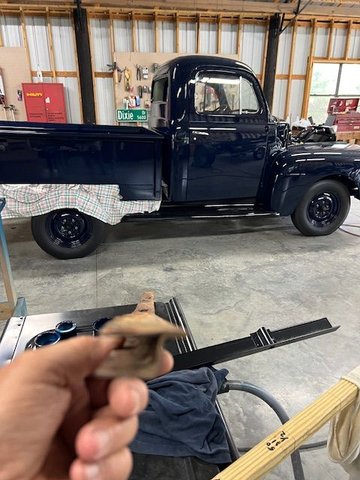

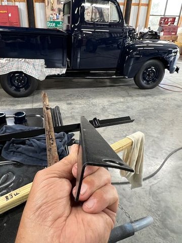

Question 1, I have attached pictures of the bed end cap, which covers the ends of the boards at tailgate end. The old one has a channel; the only replacement I have found is just an angle.
Has anyone found one like the original?

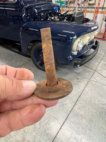

Question 2. I have attached pictures of the original bed to frame bolts and washer. I have not found bed bolts with the recessed square head like the original, I have seen them with a Phillips head. The washers I saw don't look like the original.

Stock End Cap
Stock End Cap
LMC and DC End Cap
LMC and DC End Cap
Bed Bolt
Bed Bolt
Bed Bolt Washer
Bed Bolt Washer

My end cap is like the newer one that you show. It came with the bed kit that I purchased for my 49.

The bed bolt is Ford Fasteners 350628-S7 and is 7/16-20x4 square socket head machine screw.
The countersunk washer is 351460-S8.
Unfortunately, those part are obsolete and discontinued.
It seems most vendors offer the later style 350623-S7 which is 3 3/4" long instead of 4" and a 7C-8144440 washer
https://www.dennis-carpenter.com/tru...lt--washer-kit
https://cgfordparts.com/stepside-bed...-350623-s.html
https://cgfordparts.com/stepside-bed...c-8144440.html
